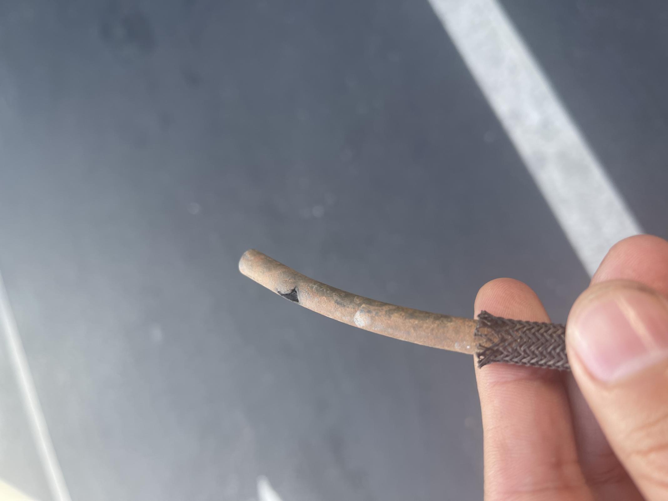

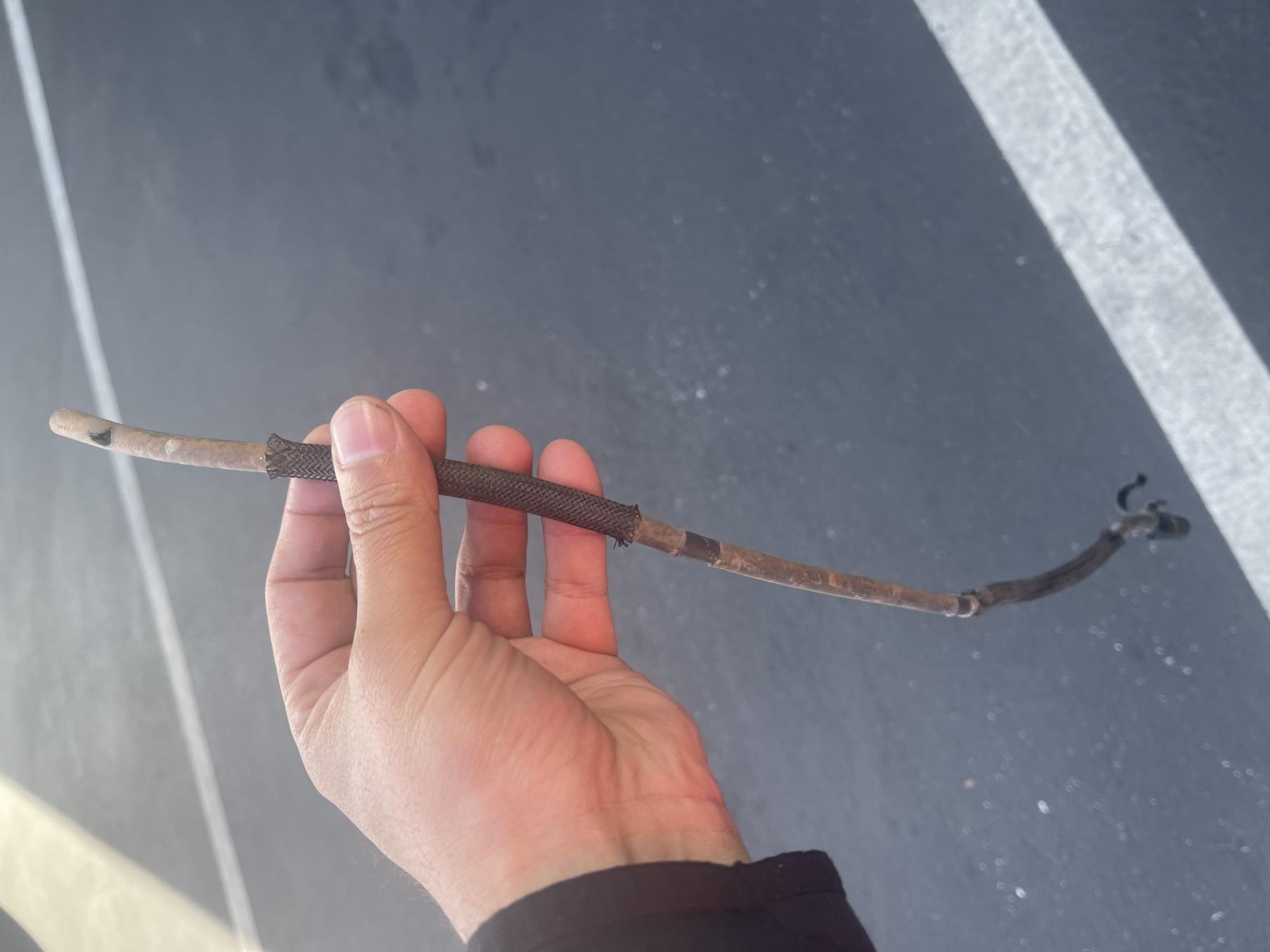

Guys, need your help here. The dealer got back to me. Says the cause is a ruptured breather hose. See pics. And they say that Toyota HQ guided them to identity this issue and they say it’s because of a lift. It does not make sense to me because a lift does not lift or drop the front diff. I’m going to see the truck and talk to the tech working on it because it’s Bs. Any suggestions?

I also asked why this didn’t come up last times. I specifically asked the actual tech if there was any water or corrosion in the diff, and he said no. Further, I said the hose wouldn’t be replaced by the tech but they said the tech replaced the breather hose last time. I’m very skeptical. They want $1200 if I wanna fix it. And I need store managers approval to dodge the diagnostic fee.
Just went to the dealer and talked to their master tech. They showed me the ruptured ADD breather hose. It ruptured right around where the soft hose connects to the hard hose next to the front diff breather. I kept pressing the tech to explain to me how the lift could have influenced it since the front diff is stationary, but all I got is that Toyota HQ said this is a known issue related to the lift. I then asked if they taken the ADD apart to confirm if there’s any debris inside the motor and they said they can’t do it because the warranty policy is just to replace it and not disassemble. They’d only disassemble the ADD if I paid for the fix. Honestly, this sounded like a wash.

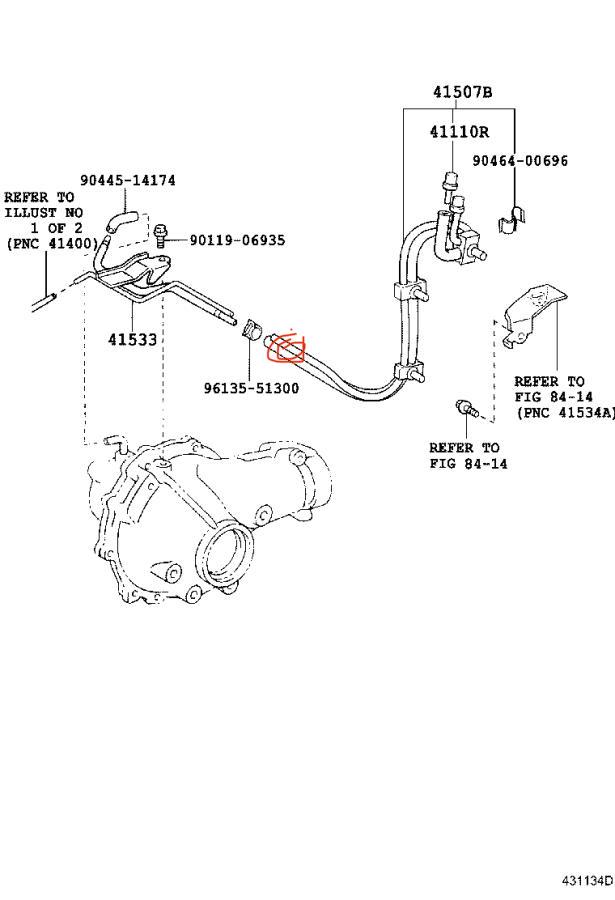

PS: attached is the ADD breather diagram where I highlighted where I got a hole.

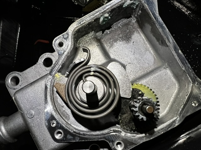

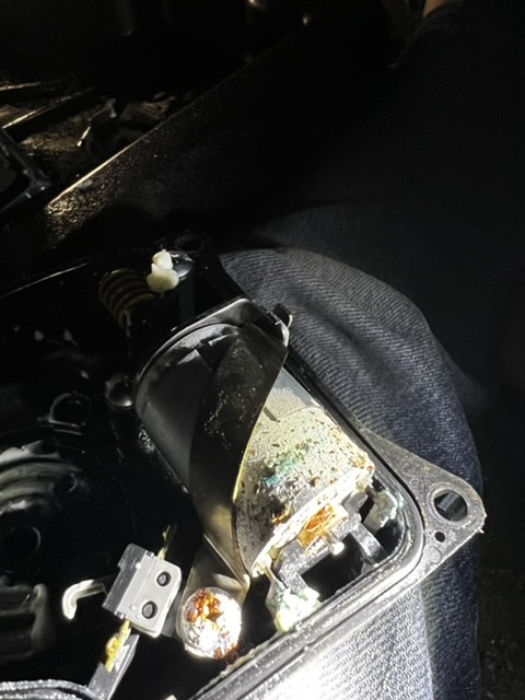

Also, I removed and replaced the ADD. The old one actually worked as far as engaging 4x4. But when I cracked it open, it was full of water and corrosion. See pics.
