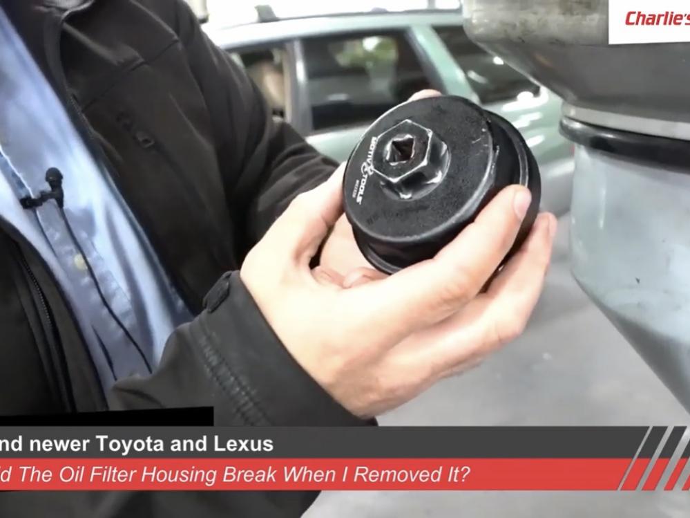

Charlie, a professional mechanic and shop owner uploaded a video about oil filter housings that have been over tightened and how to properly install and torque the housing. Sometimes he has to use an impact tool to remove a housing that is over tight. Over torque combined with several 100 heat cycles between oil changes makes the housing difficult to remove. In some instances one may crack or break the plastic housing in an effort to loosen it. Damaged Oil Filter Housing On Toyota and Lexus - YouTube

This is a good informative video that every DIY oil changer should see. And did you notice the filter wrench adapter he used? MotivX

Furthermore, he uses a 27mm socket on the wrench rather than a 3/8 drive to loosen the oil filter housing. At time stamp 1:38 to 1:43 he uses two hands for handling the 1/2 inch drive ratchet. Overall, excellent technique and it's great Charlie took the time to share his knowledge. He probably has many loyal customers.
