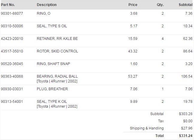

Here's the cheapest OEM parts I could find. If you plan on keeping the truck, stick with OEM (unless you want to do this twice...and trust me, you don't). These are parts for both sides. My mechanic pressed everything in for $100.
Just to keep the part #'s accurate, there is a difference with the bearing and outer seal for 96-00 trucks
9031348001 axle shaft oil seal outer
903634002077 bearing
Also, on a few web sites like this one for instance, the bearing is discontinued.
