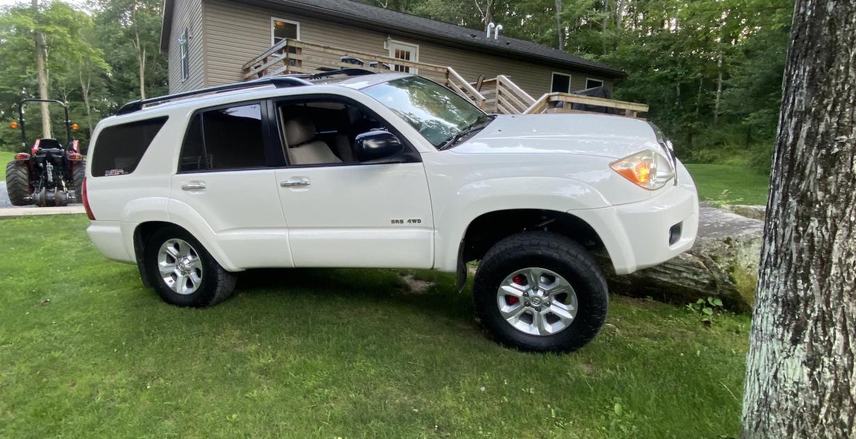

I was a bit worried that with last-minute suspension changes, surprises may happen.

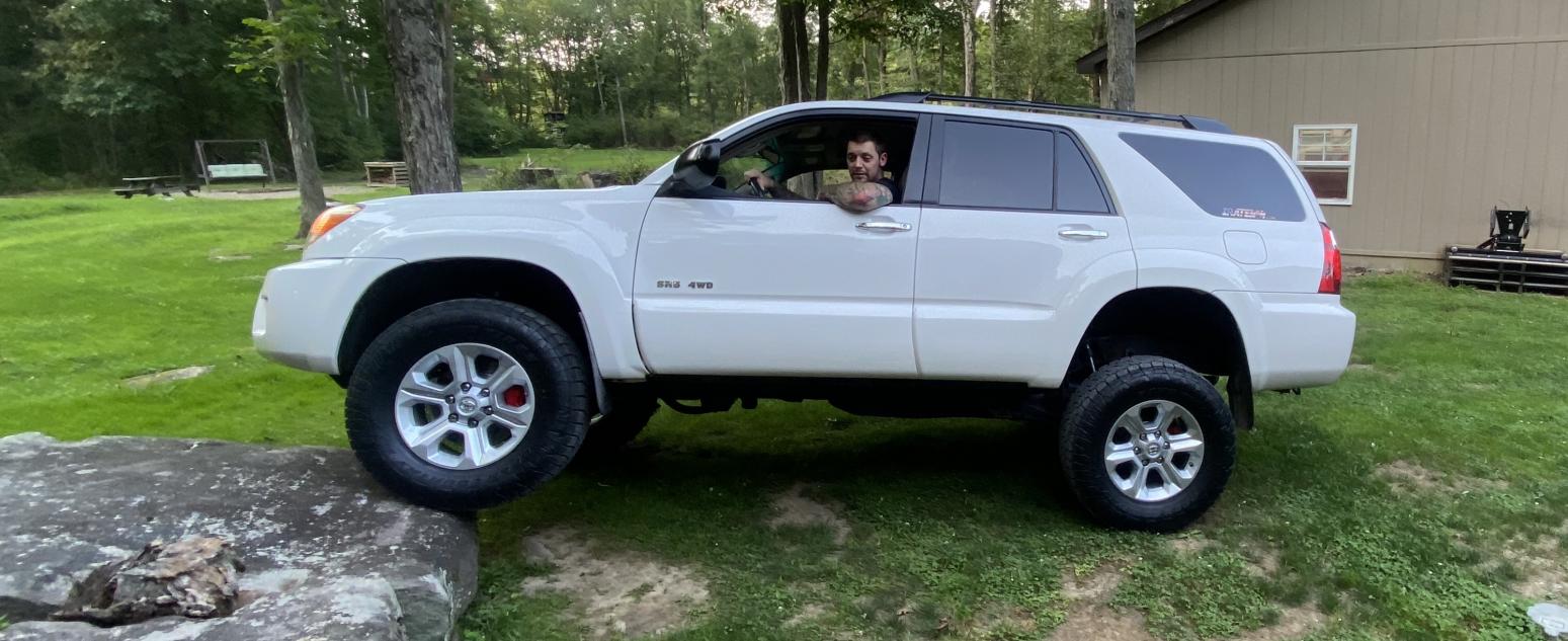

Before I fully put this to the test I’ll have it on those boulders in the yard to see the tipping point. They’re bigger than anything I’ll hit out there.
TBH your pics don't look that crazy. CV angles are fine. You likely just got some extra lift up front from eliminating some of the rake. The images look almost identical to my Dobinsons IMS (2.5/1.5) setup. Without aftermarket UCAs you won't get any better castor numbers. what weight springs did you go with? that can make a big difference in ride quality..

This flexes nicely.

I'm assuming you were on the high spring rate spring in the front ? With the amount of pre-load you had pictured there is absolutely no way you were near 5 inches of lift so not sure what was going on there. Granted I have a steel bumper with a winch, but my total lift was just shy of 3 inches with the stock pre-load from ICON. I also have the high caster JBA UCA's and have 0 complaints about the ride quality on and off road.
Also, I can tell you that if you were truly anything over 3" of lift you would have popped both of your CV joint boots 3 miles into your first drive. Ask me how I know :) (long story short I set the bilstein shock to the absolute highest spring perch but was using OME heavy springs and should only have been on the first perch, netting me a total of damn near 5 inches of lift and some mean Carolina squat)

I actually didn’t adjust the coilovers at all. My front is sitting right at 22.5” right now. I’m guessing it needs to settle. This thing almost never gets driven. Maybe once a week just to keep it moving. Sometimes once every two to three.
