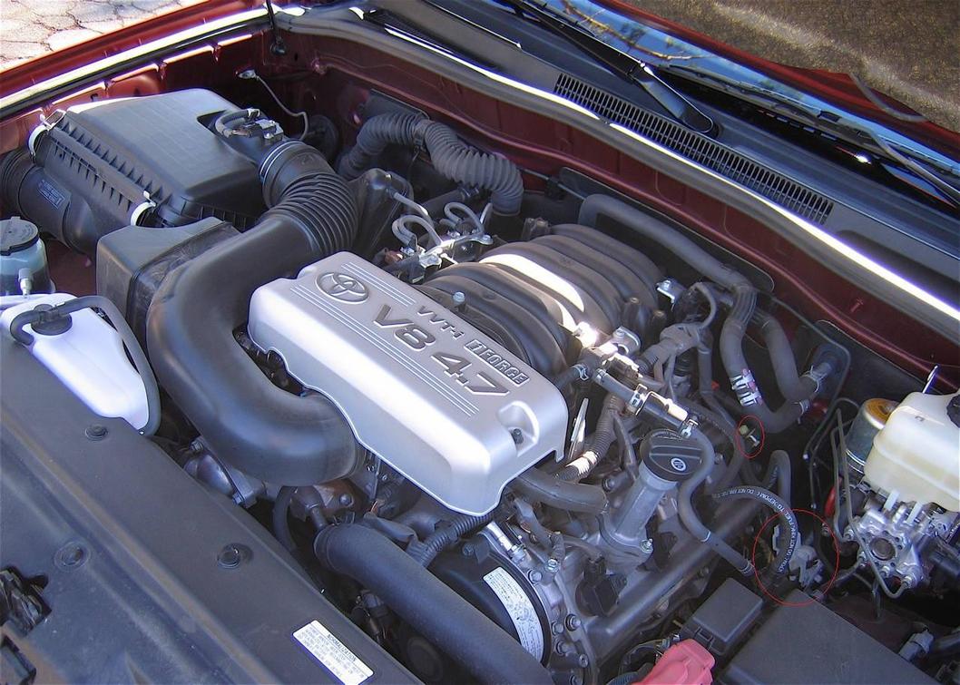

Alright guys here is the update. The day after I got it back from the dealership for the first time (when they claimed they didn't hear it) I started it up at home and it made the noise for me. I took it back into the dealership and let it sit over night. I met the tech the next morning and started the 4Runner with him sitting in the passenger seat. He heard it this time and they kept the vehicle all of that day and most of the next. They said they thought they might have found the culprit, but weren't 100% sure. In the pic below there are two red circles which highlight plastic clips that hold some fuel lines in place. If you put your hand on these fuel lines when the engine is running you can feel them pulsate as the gas is pumped through them. They said that when they removed the lines from these clips that the noise was diminished so they put sylglide in the clips and on the fuel lines and thought that might solve it, but because the engine was getting warm by that time and the noise seems to go away when it is warm, it was hard for them to say for sure. Took the vehicle home yesterday and I knew the true test would be a cold start up this morning. Went to start it and the noise was still there, but I think they are getting close. It is warm today so the noise went away rather quickly, but I spent some time wiggling and knonking on fuel and brake lines and their mounting brackets in that general area and there are a few places were I can replicate the noise almost exactly by knocking on it with my fist. Just wanted to share this with you in case it inspired any additional insights. The thing that still gets me though is if it is not an internal egine noise, which right now they are claiming it isn't, then why does it all but vanish once the engine is warm? Thanks everyone I'll keep you posted.

... They said they thought they might have found the culprit, but weren't 100% sure. In the pic below there are two red circles which highlight plastic clips that hold some fuel lines in place. If you put your hand on these fuel lines when the engine is running you can feel them pulsate as the gas is pumped through them. They said that when they removed the lines from these clips that the noise was diminished so they put sylglide in the clips and on the fuel lines and thought that might solve it....

Hello everyone, new guy here that works at a Lexus dealership but owns a
4Runner(really don't like the GX470 for my own personal reasons).
Regarding the knocking sound that you hear upon start-up is possibly the fuel
pulsation dampener and/or fuel pump. My 4Runner does this occasionally and we also have a few customers with GX470's with the same concern. Lexus has a countermeasure part for the dampener and if that does not fix the "sound" then we are instructed to replace the fuel pump. All of the repairs that we have done, so far, have resulted in just the dampeners being replaced only because said customer's have not returned with the reoccurring knocking. Sorry guys, no TSIB regarding this concern! And if needed, I'll get the part # for the dampener but I can't guarantee this will fix your sound. Hope this helps with your situation!

Hello. Thanks for the additional insight. I have been dealing with this since March. I thought the noise might go away in warmer weather, but it has not. I would very much be intereseted in the fuel dampener part number as well as a picture or a desricption as to where this is located on the vehicle. Thanks again.

They replaced the fuel dampener and that didn't get rid of the noise. For anyone else who cares to venture a guess the biggest factors to keep in mind are this, really can't hear it outside the vehicle which is why they don't think it is internal engine or driveline noise, goes away once warm, best way to get it to make the noise on demand is to put a small load on the engine like shiffitng into gear but remaining still with foot on brake. They don't believe it is brake related either.
Update.
Dealership called back and said they were able to hear the noise really good with a stethoscope the other day and were "100% sure" that the knocking was coming from the fuel lines, but weren't sure why. They checked the fuel presure and everytihng was fine there and they have already tried a new fuel dampener. At this point they have giving me two options.
1. They want to drop the fuel lines as far and as best as they can without dropping the tank and insulated with foam between the fuel lines and the body of the truck (not actually encapsulatuing the whole line).
2. Replace the fuel pump and see if that gets rid of the noise.
