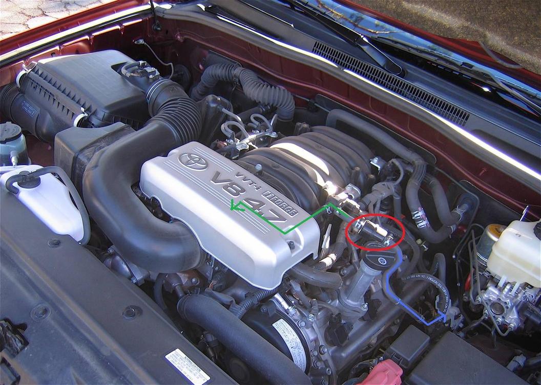

Will I Seafoamed the 4Runner and got a nice a cloud of smoke, but it didn't get rid of the noise. It is coming up on time for an oil change soon, so I might upgarde to a synthetic and a better oil filter too. Not really expecting this to solve my noise issue since the Dealership doesn't think it's an internal engine noise, but it is still a cheaper next step than replacing the fuel pump and it needs to be changed anyway. I spent some more time under the vehicle myself looking at the fuel lines trying to find any place that I could visually see were they might rattle together. I didn't see much, but I think I may try insulating those few spots just to see. I'll keep you posted on the results.
Okay so I really tried to pay attention to where this noise was originating from and it sounds like (I could be wrong) that it starts near the fuel tank or underneath me and very quickly travels up to the firewall/engine bay area where it becomes more prominent and audible. I am starting to wonder if there is some kind of air bubble or vaccum issue that needs to be overcome by moving fluids or built up pressure on cold start ups.
On that note does anyone know what the part circled in red is? It has lines that run from one end to the top of the throttle body, and the other end appears to run back down the firewall and under the truck with the fuel lines. I pulled it out and it appears empty and hollow inside. I can see straight through it and when I shake it, it does not make any noise.

That is part of the VSV control vavle for the EVAP system.
BlackWorksInc,
According to this site
http://www.villagetoyotaparts.com/s...y_TrimLevel=0&ukey_modelRange=0&searchString=
it is reffered to as a "tank, vaccum surge". Can you a explain to a non-mechanic what exactly this does? I noticed that when I first start the vehicle there is no vaccum or puslation through this or the lines connected to it, however as the vehicle warms up the vaccum and pulsation increases.
