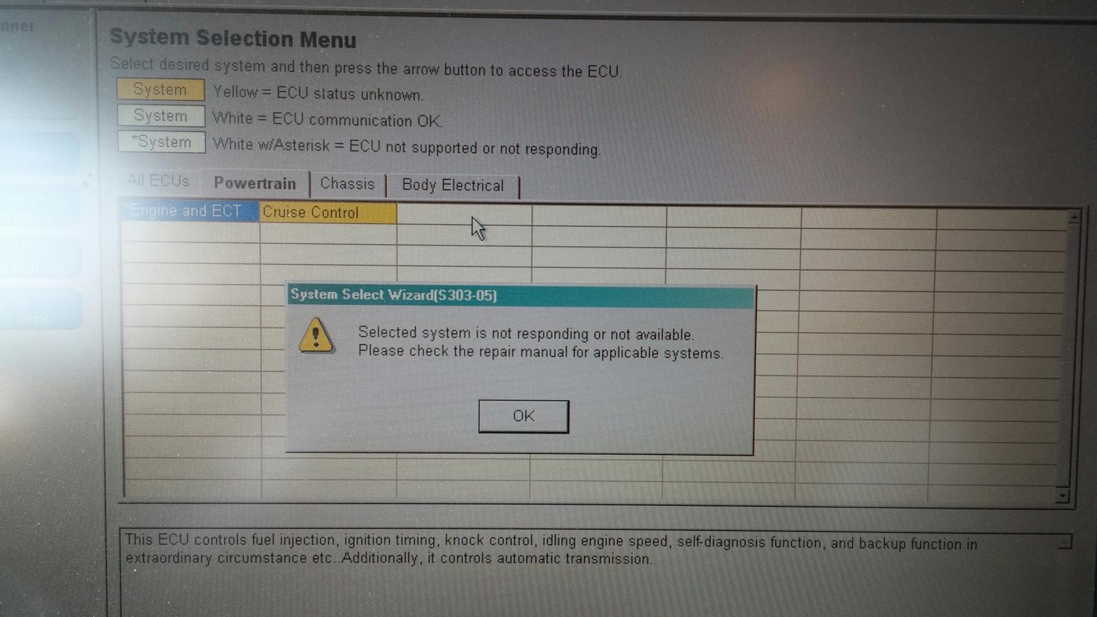

Can't get "Engine ECT" on Techstream
I've tried to search but there's just too much Techstream info here to sift through and find what I need to know, if it's even here, so hopefully someone knowledgeable can help.
I tried to check ATF fluid level (preparing to R&R some fluid) and I can't get the Techstream to read the fluid temp. The service manual says:
"(a) When using the Techstream:
Enter the following menus: Powertrain / ECT / Active Test / Connect the TC and TE1."
However, I get to the "ECT" menu (actually says "Engine & ECT") but that's as far as it goes.
I have a cheapo Mini VCI from ebay and the Techstream that came with it (version 7.something) running on Windows XP. I have no problem doing customizations.
Do I need a different Mini VCI or different software? Or both? Suggestions?

You need to click on the tab/box on the Engine/ECT. The box will turn yellow. Click on the right arrow on the bottom right.
Guess I wasn't clear. I've done that, but here's the result when I click the arrow. (you can't see it very well, but the blue box says " *ENGINE AND ECT " - note the asterisk).
