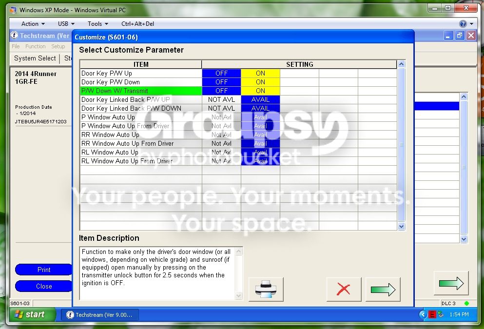

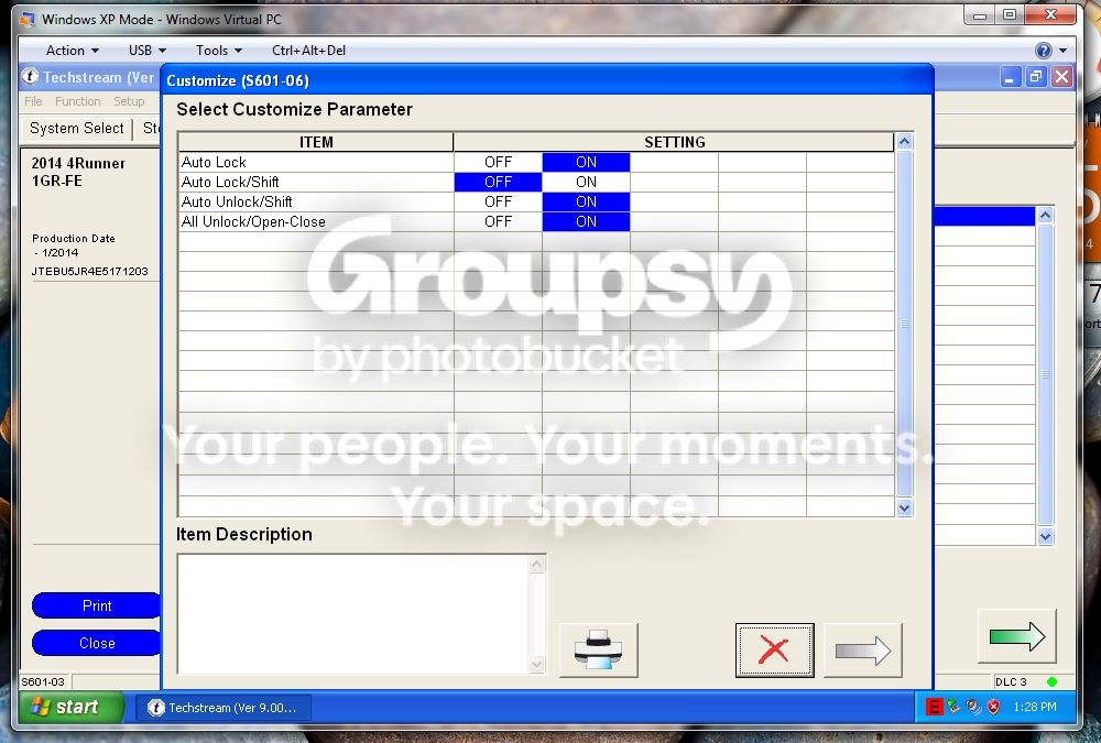

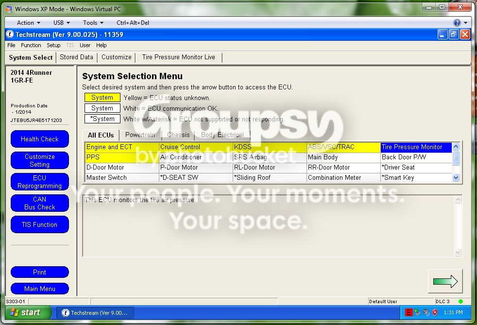

Techstream v9.00.26 works on Window 7, 64-bit laptop
Hi guys,

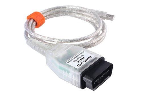

First post here. I just wanted to let you know that I bought, received and tested (turned off the door chime w/key in ignition, both seat-belt reminders and the irritating auto-door locks). With shipping it cost me $50 Canadian, which is like $3 US dollars, and the cable came with an installation CD (Techstream v9.00.26 which works on my Window 7, 64-bit laptop). Got it off of EBay from a seller named "obdfocus". This shameless plug is because I had great tech support after misreading the instructions 4 times in a row. This person was Very patient with my dumb ass.
So Toyota finally caught up with the rest of the world and got TS to work with 64 bit Win 7. Thanks for posting this kakeyed.
New member here. I mainly joined to lurk in the 3rd gen area, but I'm a Techstream addict as well and I like to keep track of what new developments are popping up with the DIY Techstream setups people have at home.
Hi guys,
That's actually really interesting. If it just installed and worked on a 64 bit system, you'd be the first person I've seen to actually receive a disc with 64 bit drivers rather than having to tweak the 32 bit ones. It'll be pretty cool if that becomes a more common occurrence.
btw, Techstream has always worked on 64 bit systems. It's the drivers for the cable that needed the 32 bit systems. Some of the more expensive cables offer 64 bit drivers that make installing Techstream on 64 bit systems super easy. Ironically, current Techstream 2.0 machines are still only using 32 bit Win7 systems with Mongoose Pro VIMs.
Well I guess 32/64 bit drivers will be included more often from now on. That cable is the same cable as all the others, they just have 64 bit drivers on the disc.
