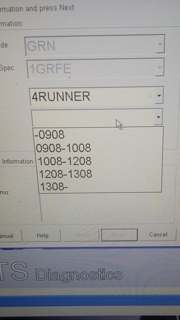

I am not sure what to select as the vehicle type. I select 4 Runner then in the drop down list I have multiple number to select from(different model types) .
I have a 2016 Limited. What should I select?
When its plugged into the obdii port, it should automatically select it for you and you just have to choose between smart key or no smart key feature.
Here's a pick of what I was referring to. I selected the 1308 (I think its the year and up) then picked smartkey. I was able to change settings.
