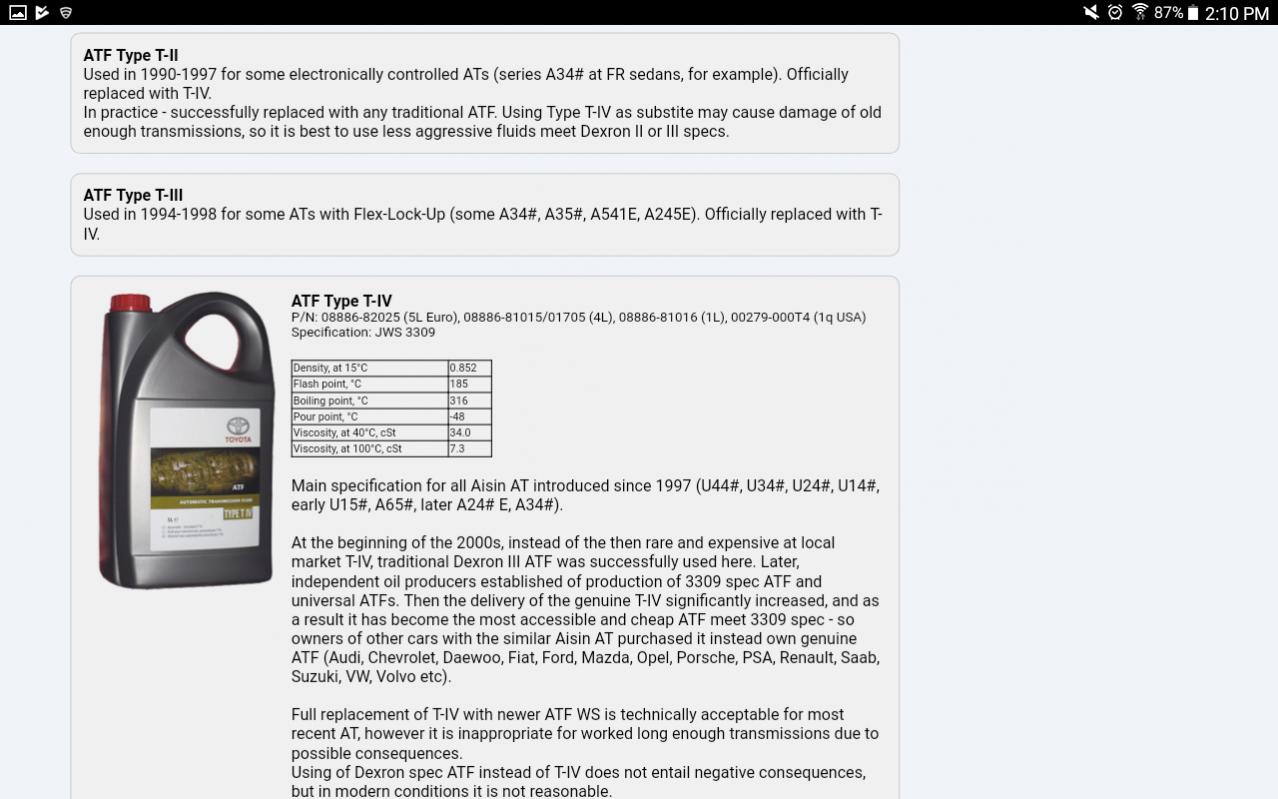

I used Toyota t-iv atf last time I flushed my transmission also and it works fine. Some one posted this on club lexus.

Great, one more rabbit-hole for me to explore since a replacement filter is sitting in my shop just waiting. In my Short internet dive, it looks like there's a lot of "OEM only" supporters.... which is fine, the money spent on marketing is substantial. I can get a gallon of Toyota T-IV from the dealer for ~$17 before taxes. There seem to be only 2 commonly available aftermarket oils that meet the specs, those are Mobile 3309 and Valvoline Maxlife. I can get the Maxlife from Walmart for the same ~$17 before taxes.
So really, my only decision is OEM dyno or aftermarket synthetic.
Not like the owners manual is very specific here (attached)
