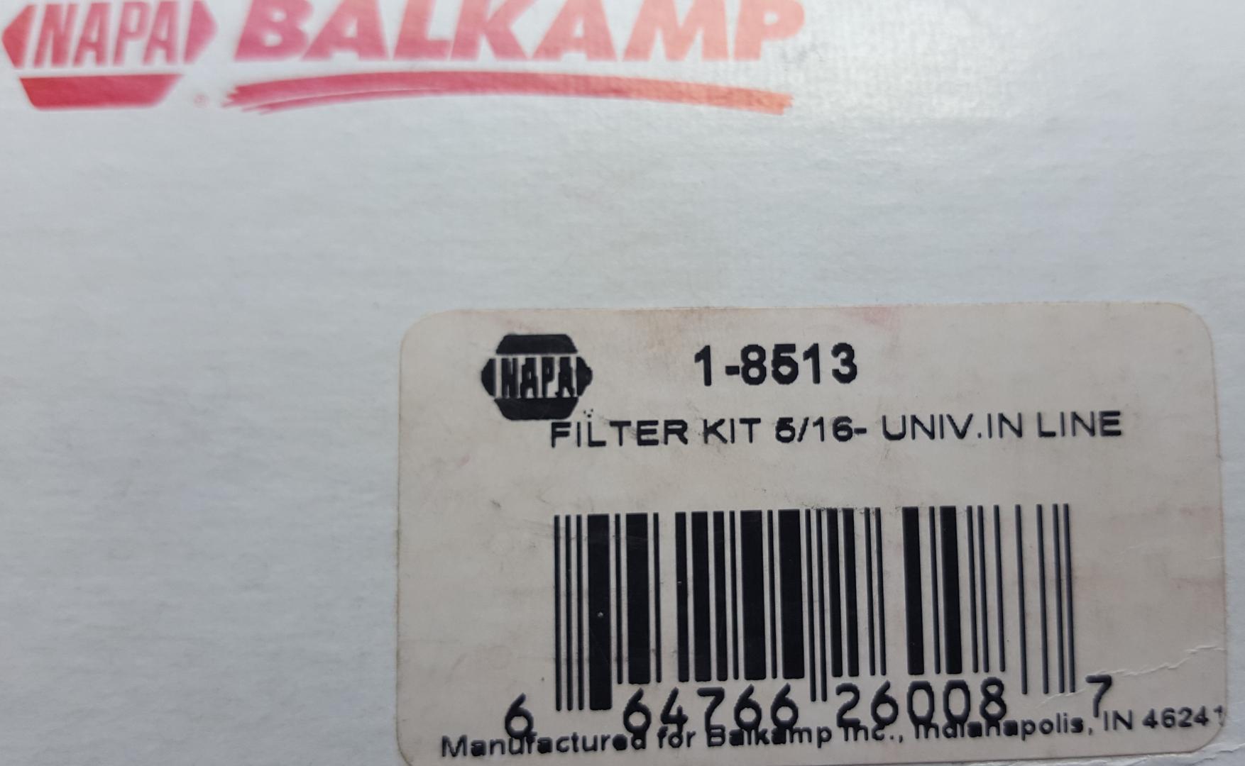

I just installed a BM 70268 radiator bypassing the stock unit, added a Balkamp 1-8513 filter from NAPA, purged oil with Valvoline Maxlife as there wasn't enough Mobil 1 ATF in our location, 15 quarts to complete. Have run for 60 miles now, no leaks or explosions and have trans oil to the right level having finally found out to check level with hot motor and engine running.
is that an inline filter? i searched for it and i couldnt find anything on it. if so, what requires 'purging' on it?
Purging in this case,is total replacement of all transmission oil. I followed the majority method of draining trans pan 3 1/2 quarts and replacing that, then with the send pipe to the trans radiator disconnected and a big clear bottle under it with a 1 quart marker on it, then started motor and when 1 quart of oil had pumped into catch bottle, stopped motor, filled trans with 1 quart of fresh oil and repeated the 1 quart out, 1 quart in process. At 13 quarts, the oil was clear from the send pipe and the job was done. Needed 1 1/2 more quarts to get hot motor running up to hot mark on dip stick. This is a less harmful method of purging unlike the shop method which puts an external pump into the system that uses more pressure than the tranny pump. Many people discourage the shop method as it can dislodge more crud that can just upset the whole apple cart. Purging is such a lovely word, has many uses !!
As for the filter, that's all I know, it's what is on the box.

so what is the point of putting another filter on the lines if there is one inside the tranny? im assuming you would want to keep the resistance as low as possible to allow as much ease of flow? does this go on the cold or hot line?
More is betterer !! One more line of defense and resistance is minimal. Mine's on the return line. Some one will prolly say that's the wrong spot but IDC......
The 'filter' in the trans is just a metal screen that is built in to the pickup...
