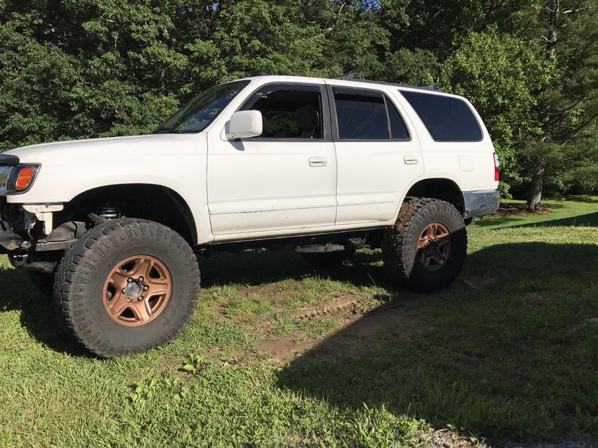

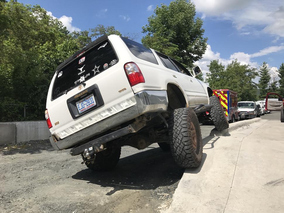

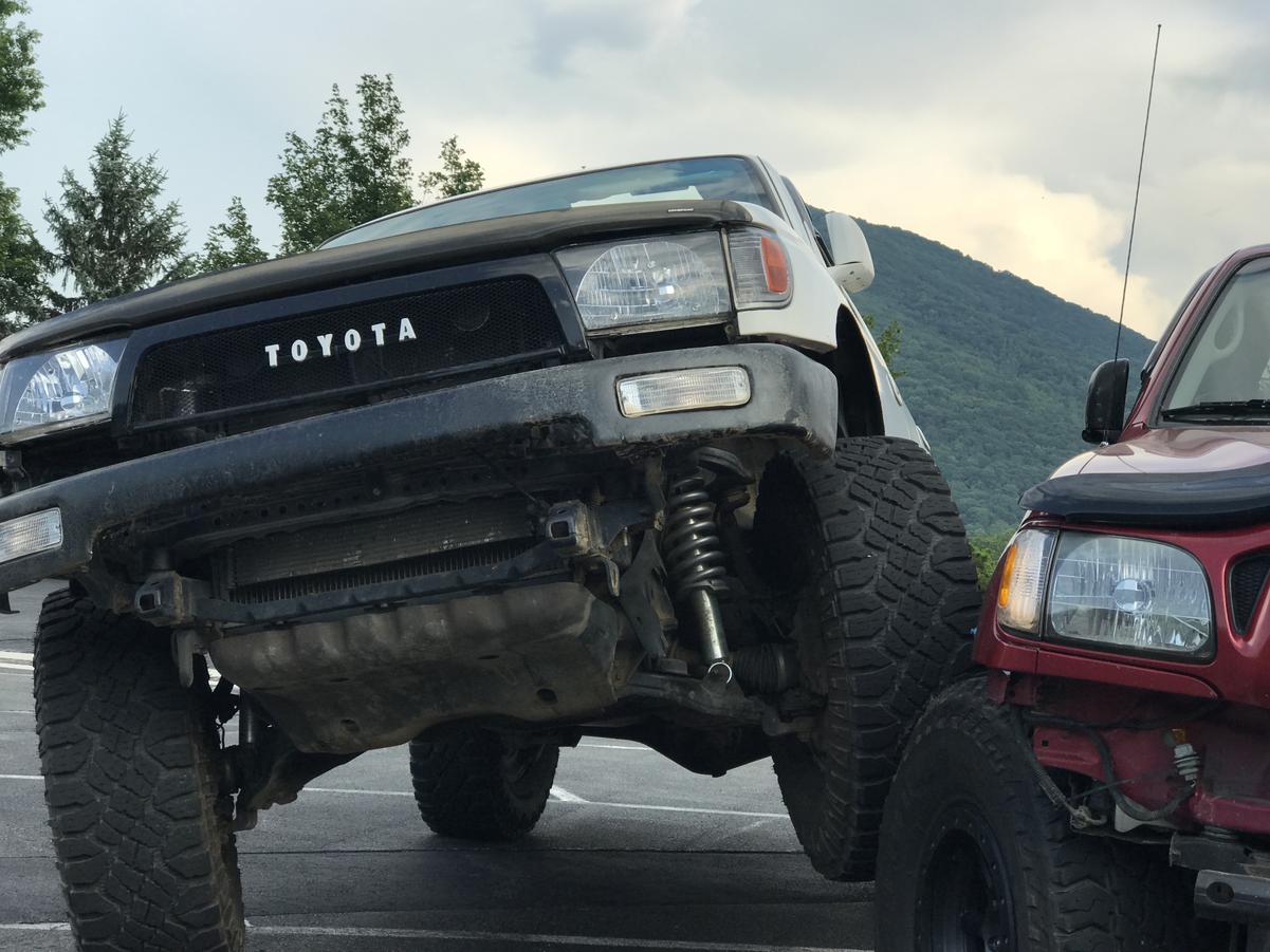

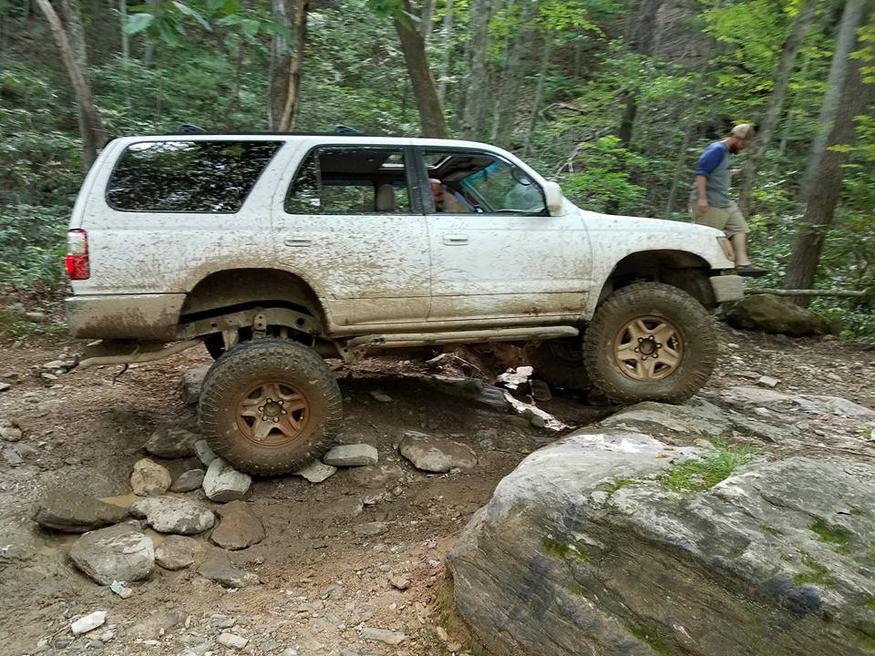

I went with the Toytec/Eibach kit your referring to for a few reasons. 1 it was a little cheaper then the Ultimate or Boss kit, 2 it came with all new top hat hardware and mine was rusty/crummy looking, 3 its pre assembled so no need for a coil compressor if you don't have one and I've known a few people who had them and really enjoyed the kit. I've had nothing but good things to say about the lift so far, it offroads well and the ride is better than stock. You will most definitely get your 3" lol, I have no aftermarket bumpers only sliders and I'm yielding right at 4.5". But it will put some stress on the CVs. I'm in need of new inner boots now and I'm just gonna replace both axles to remedy the issue. I'm also wheeling with 35s so that doesn't help with front end stress haha.
