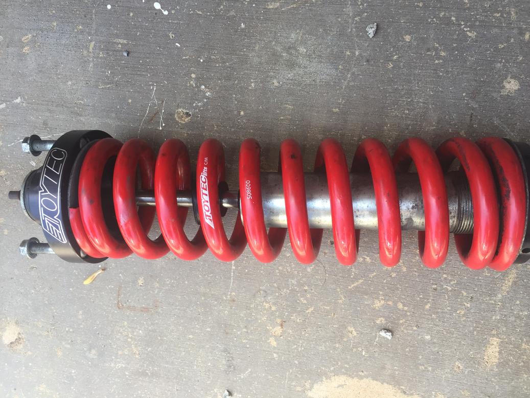

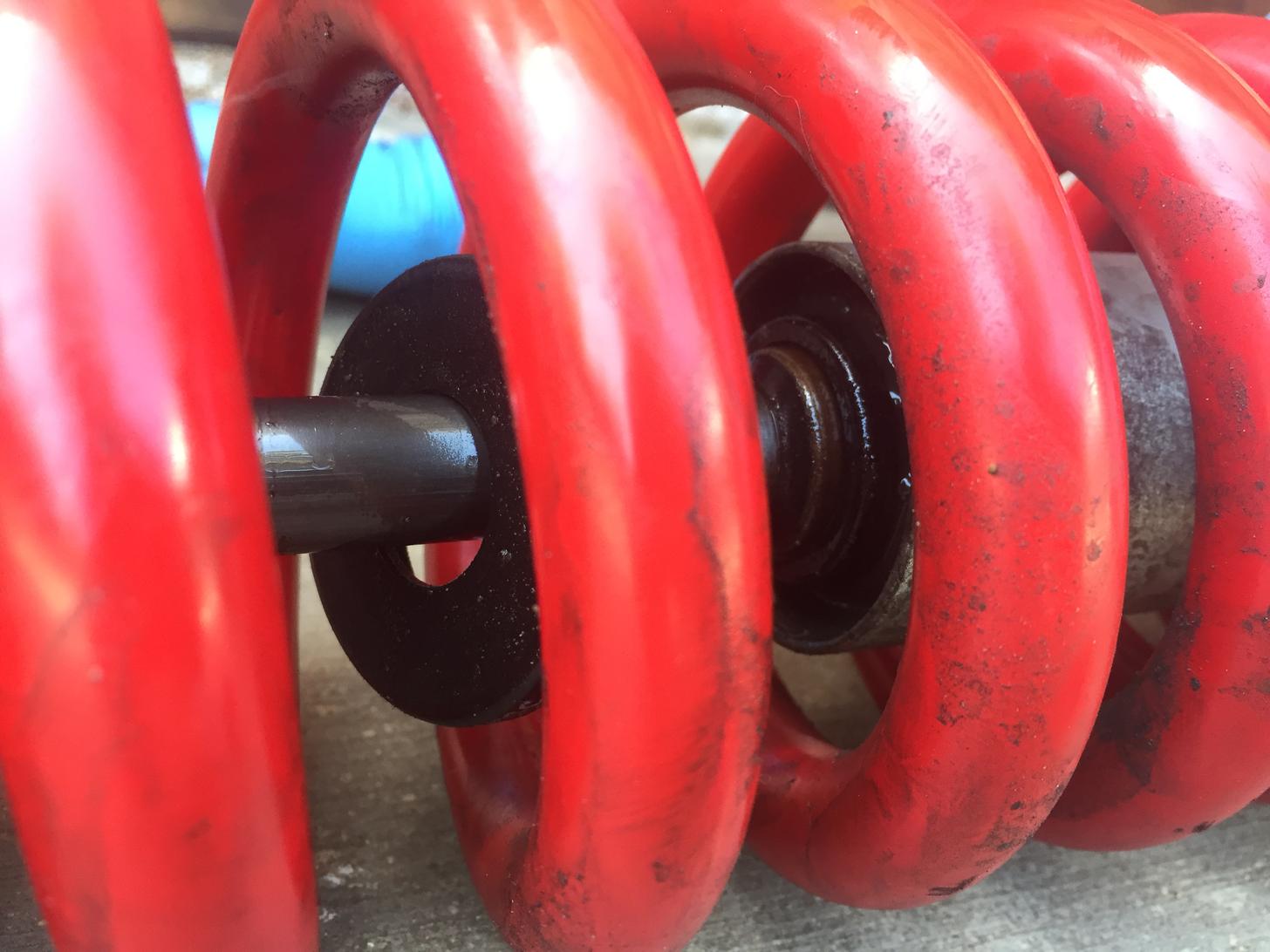

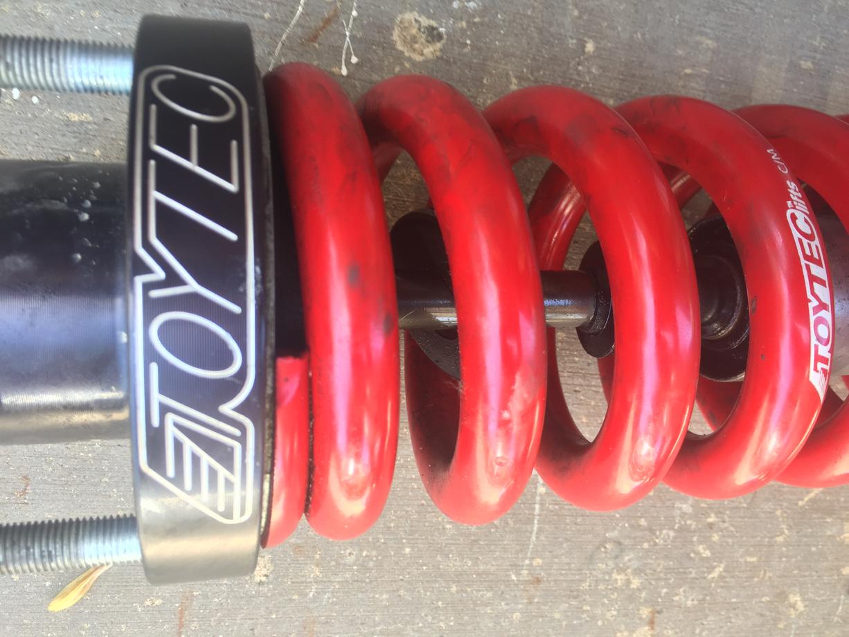

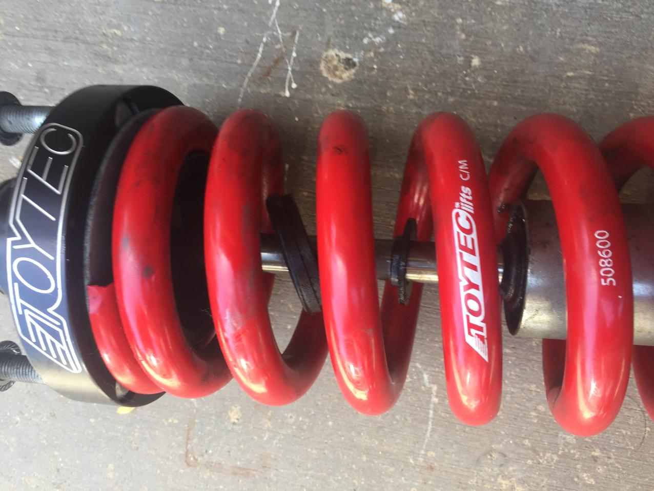

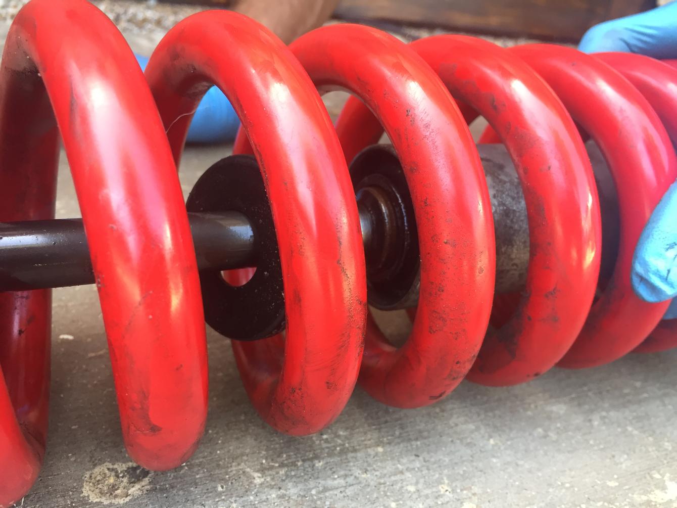

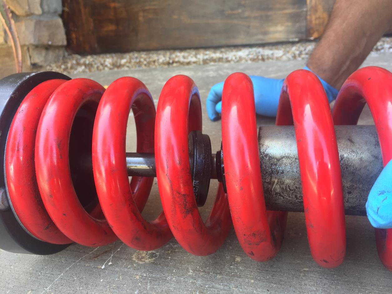

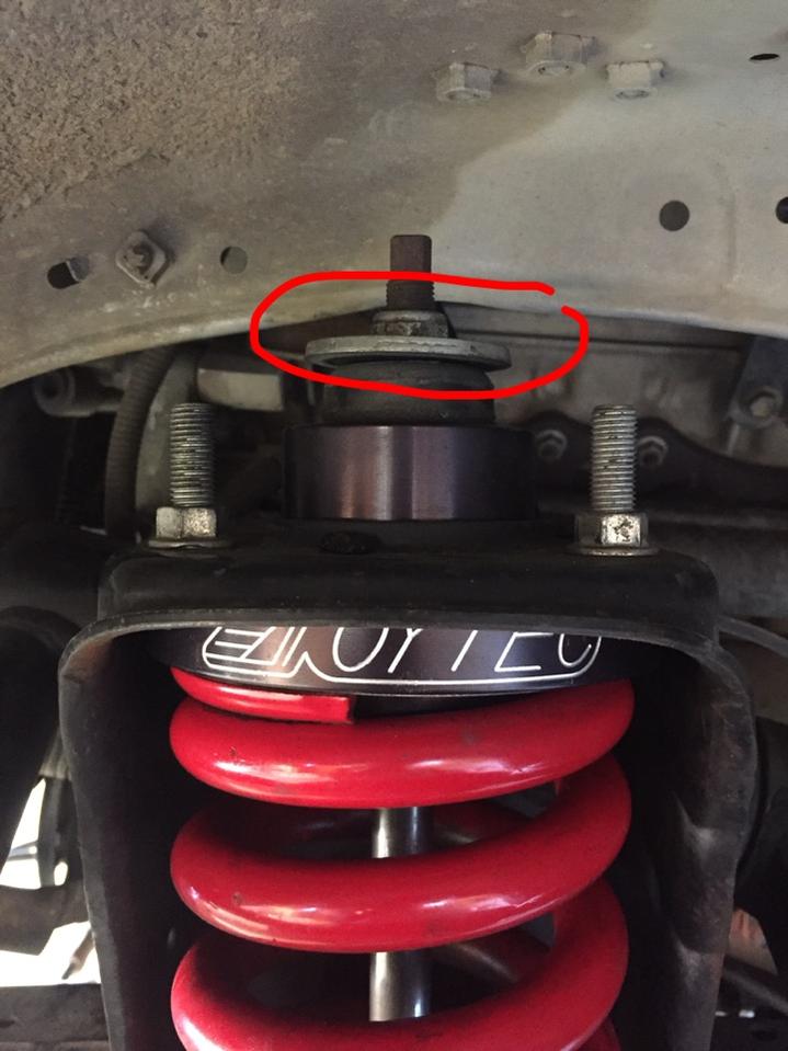

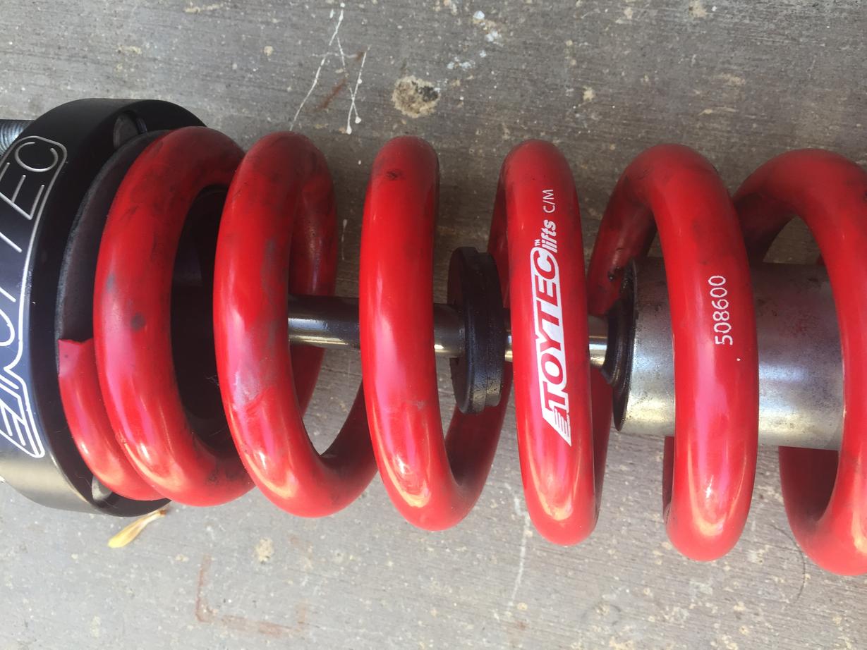

So back in 4/17 I noticed that my front drivers side shock was leaking and this cap popped off and was loose along the shaft. It leaked more than a "normal" amount (Toytec stated this was normal) as the entire shock and coil was coated (pics show after I power washed it a week before as I didn't notice the leak yet). Anyways, I've still been driving on it since then and today just noticed that the top nut is looser on the driver's side as I can easily turn the washer just below it (circled in pic). Passenger side is solid and can't be turned. Has anyone ever experienced any leakage/issues with Toytec Boss coilover shocks?

Would love all your guys' thoughts/input. Here are some pics of the coilover:

I think youre
going to need to remove the coil for the strut to get an idea of whats going on. My take would be that the strut lost pressure thus blowing the seals and fluid...
any warranty or replace info from toytec?
That's my plan for this weekend to disassemble the coilover and test the shock. Toytec said the cap coming up a bit is very common. Toytec said it doesn't look blown, but to try for warranty I have to buy a new shock and then send them back the old one so they can test it. A new shock is $200.
That shock is toast :rip:... time for a long travel upgrade :lookout:
Christmas is coming up....:hungry:
Toytec was great in helping me order and ship a new shock on Wednesday before the holiday. Going to replace the shock and tie rod ends together and get an alignment after. Toytec said they might be able to warranty to the shock after I send it back since it hasn't quite been 2 years yet.
Also diagnosed the clunk as the lower control arm cam bolts not torqued appropriately. Alignment shop probably only used an impact and didn't torque them all the way. A quick tightening and no clunk! Should've checked that a long time ago...
Thanks for everyone's input and help and hope you all have an amazing holiday weekend.
