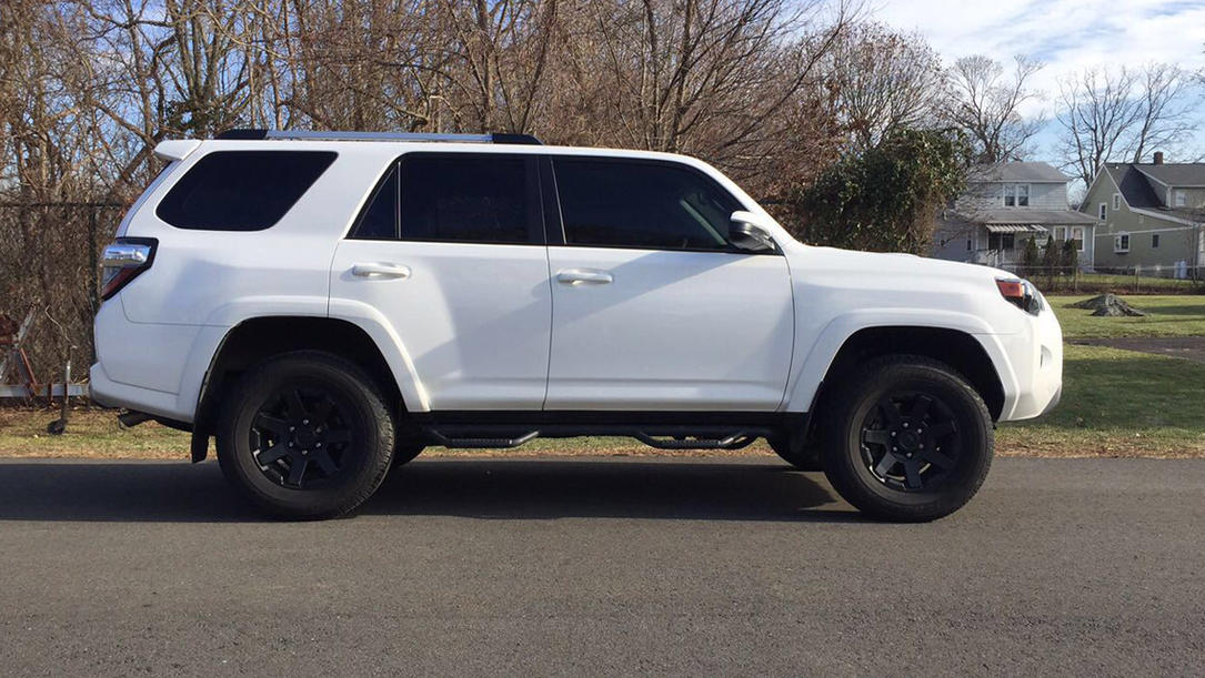

Im just home and off now till next wednesday. Once I tackle this one I will post up pics!

+1 for Jason's 1" leveling kit. Very easy to install. No special tools needed, just a socket set and a torque wrench. Less than 2hrs for the installation from start to finish. Truck looks better and feels better on the road too!
