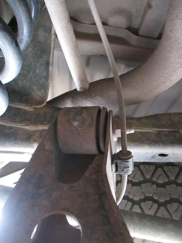

I had a clunk shortly after installing my 891s and looked under to find this. IMG_1574 (600x800).jpg But, Yeah it's probable your sway bar. Other then the noise how do like the superflex coils ? I been planing on doing the same thing after my 891 wear out.

I had a clunk shortly after installing my 891s and looked under to find this.View attachment 133137 But, Yeah it's probable your sway bar. Other then the noise how do like the superflex coils ? I been planing on doing the same thing after my 891 wear out.
