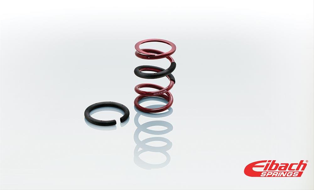

You're right about it being harmless and also about the solution. I noticed it the first time I took it around the block after the install. For me It's not very audible with the windows up but with them down it's very easy to hear. I am very "in tune" with my vehicles and noises bother me. I plan to purchase and install a coil spring sleeve and according to my measurement this one would work: Eibach Coil Spring Sleeves CS5002, but at $30 plus shipping for a couple pieces of rubber my frugal side has won out so far.

I'm getting the coil slap as well and it's starting to drive me nuts! Has anyone tried the Eibach Sleeves that [MENTION=82492]curtperry[/MENTION] linked in this thread? I think I'm getting ready to pull the trigger on a pair of them.
Wouldn't you have to compress the spring to put it on top between coil and metal ?
