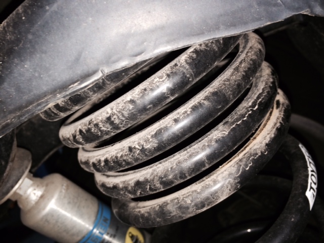

Toytec superflex installed and now problems

These go on the coils themselves and not at the top between the coil and the body of the 4runner. I was thinking just the opposite of compressing the springs. I am going to jack up the rear end. This should allow the springs to decompress and I am hoping to get these on the coils where they are making contact.

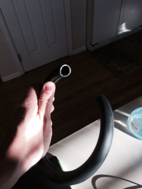

How would fuel line around the circumference of the coils add height? It's not going to increase the spring rate of the coils.
I think the coils he intends to put the rubber around are actually touching under static load, so putting in thick rubber would raise the resting height
^^Correct. I am going to put them around the coil that are static or always touching. When I was looking at the fuel line it seemed like I would gain some height from it. The Eibach coil sleeves are much thinner than the line I was looking at. Going to mess with the 4RNR now.

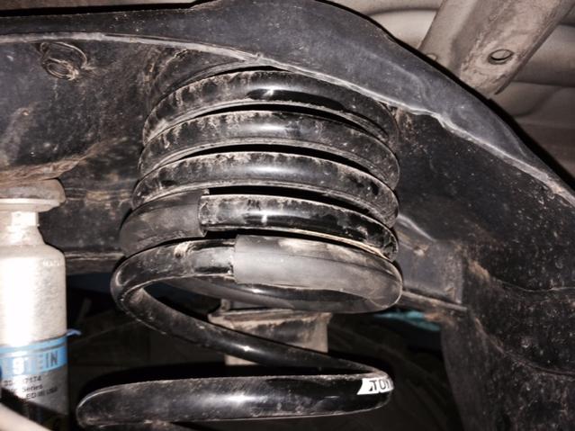

I got the coil sleeves on and I can tell a noticeable difference. However, they still "clunk" a little. I am sure that is due to the fact that I was unable to get the sleeve on all of the static coils. I looked at my coils and put the sleeves on the places where I could see the most wear. I would guess that you would need at least two and maybe three for each coil. At $14 each this is going to get pricey. Since I am already in this deep I think I am just going to bite the bullet and buy 4 more. They install easy. I just jacked up one side of the 4RNR which allowed the other side to droop enough to get the sleeves in.
Here are some pics. They are fairly thin, and have a bead of something sticky in the sleeve to help it adhere to the coil. Oh yeah, if you do this be sure to clean your coil before you put the sleeve on. As you can see I forgot to clean the passenger side one. I cleaned the driver and thought about going back and redoing the passenger side one but I figured I was going to be ordering some more and I can do it then.

I'm not sure your lean and the clunk are related. The clunk is caused by the coil wraps contacting each other and making the sound. I'm not sure how your lean would play into that. Are you sure you have the coils on the correct side? I believe they are side specific, maybe you installed them on the wrong side which is causing the lean?
There are countless thousands of vehicles with progressive springs that don't have the individual coils in contact with each other.

I'm no expert but my thought on it is lean = less weight on the rear passenger spring, thus more gap between the coils. Maybe just enough to not be pressed together at normal ride compression. It's my understanding that the progressive top coils are intended to extend at flex to help keep the spring tension, so I would guess at ride compression, they would be contacting?
