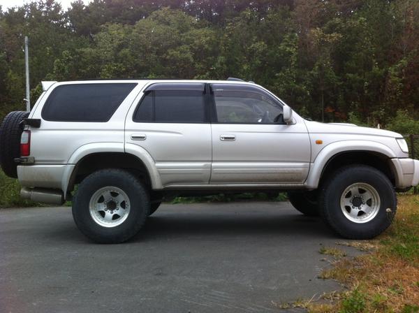

So your running OME 881's in front with a top spacer?
Pictures
That is correct, OME 881 with Toytec front spacer. Rear with SuperFlex and Billstien 5100.
kzn-185-albums-1996+kzn-185+3.0l+td+hilux+surf-picture14874-toytec-superflex-coils-billstein-5100-rear-ome-891-toytec-spacer-front.jpg
Additional note, I'm considering adding some longer bump stops, possibly Sonoran Steel after driving a bit. I drive on a pothole filled gravel road to work daily and the rear end is bottoming out bad. I suppose that the little bit of extra lift has pushed them beyond their limit compared with the previous setup. Also, I should put in the extended SS brake line as well since it's about maxed out when on a two post lift for maintenance.
