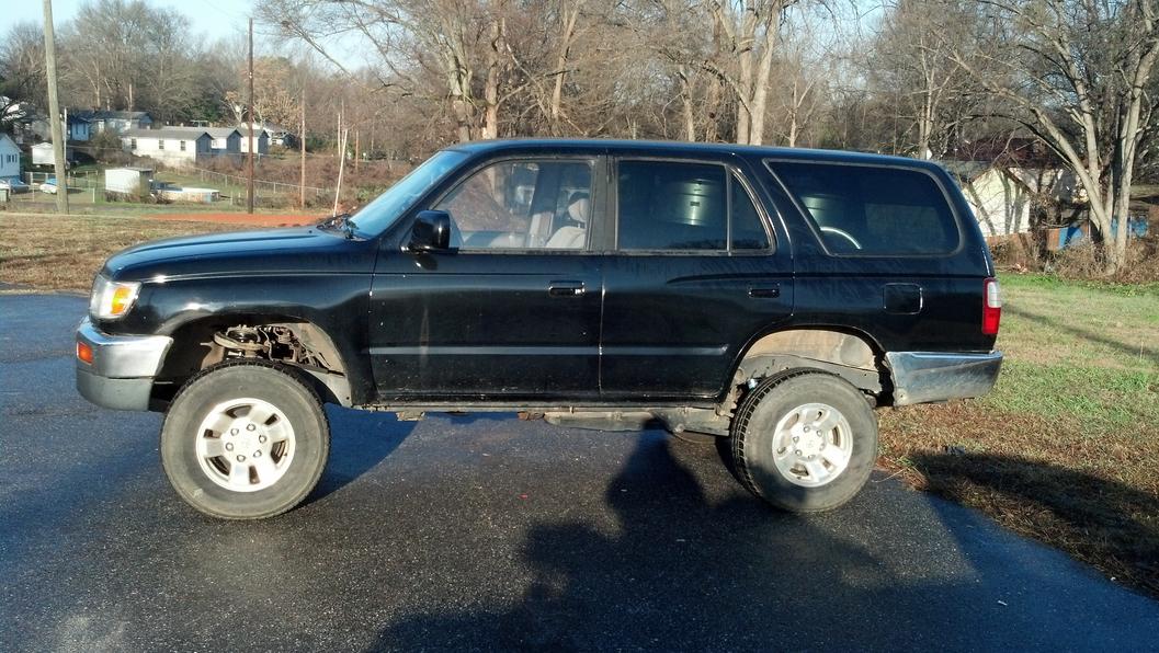

No jerry cans.
here is a pic
IMG_20120612_201829.jpg~original

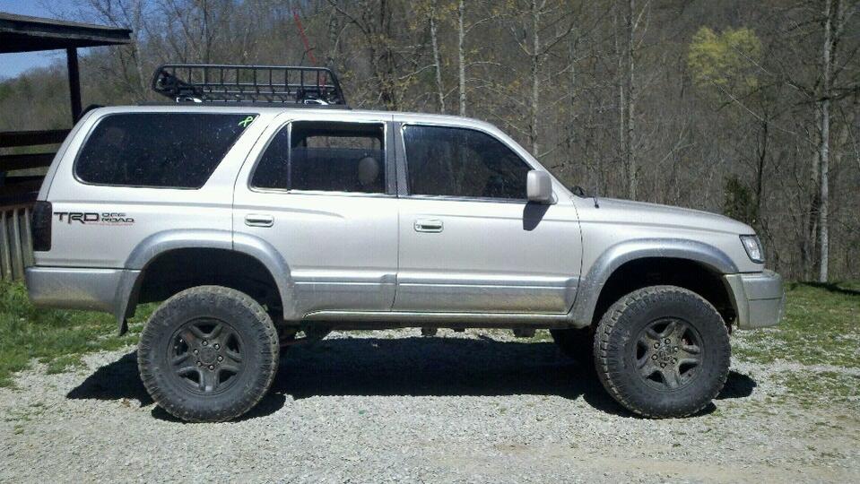

superflex with long travel billys
890 with 5125
890 with OME 60028 Comfort Ride Shocks
LC "X" wrap ???

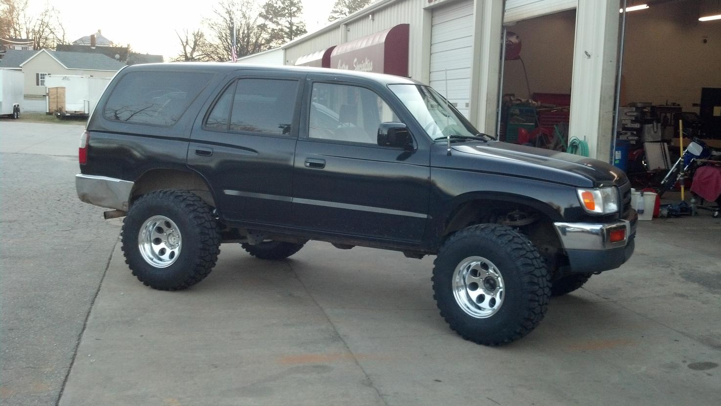

TRD/5100s in the front on 2nd perch and superflex coils/5100s in the rear. I couldn't have asked for a better ride and is excellent offroad, even with the sways attached (working on that).
Sorry the pics are so big!
That's clean! What size rim/tire combo are you running?
15/10 wheels with 33/12.50-15 tires. There is some rubbing, even after beating the wheels wells and bumper, but my 1.5" body lift got here yesterday from 4crawler (insanely fast shipping btw). I think if the wheels had less offset it wouldn't rub. It only does now at full lock on bumps and when the rear is stuffed. Looks badass, I love this setup!

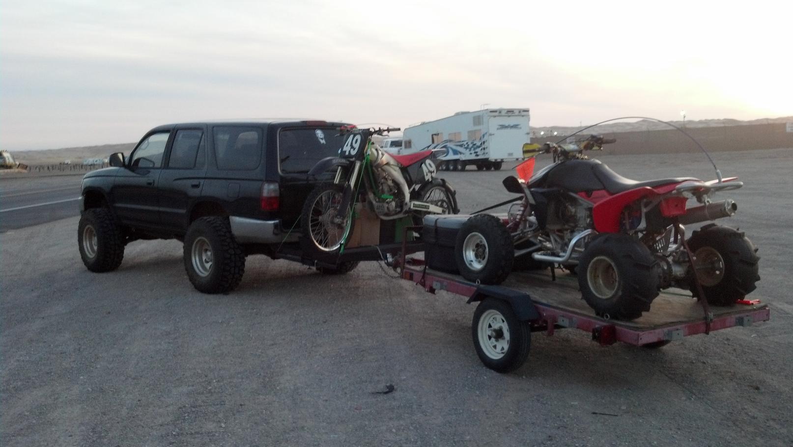

Mine are doing great, sits about the same as it did new. About every other weekend I haul a CRF450 on a hitchmount carrier and pull a small trailer with a 4 wheeler and it does fine. I added air bags to help, but even without them, it did ok.
What do you figure, 275 lbs tongue weight?
How much dose she squats and hows the ride loaded down?
Thanks for the feed back, I'm pretty sure I found my springs.
Yea, I figure 275-300 tongue weight plus some gear in the back. It doesn't squat too much, a couple inches would be my guess. If I were racing tomorrow I could give you a better idea, but the next one is a week away. I actually drove it like that but with more weight in the back from SC to CA before I added the airbags. It did fine, but it does seem a little nicer with the added support, they don't help a lot with the extended springs, but as often as I haul that stuff it is nice to have them. Unloaded with the bags deflated it rides great, almost a little too soft, but really nice. I took my rear sway off a few months ago when I added the bags and havn't gone off road since, but they flexed like crazy with the sway and the extended bilsteins toytec offers. As you can tell I really like my setup, it took me a really long time to decide on it, so that's why I try and give my opinions on it. Hopefully this helps you to decide one way or the other.
Here is a pic of it when I got to the dunes. Trd/5100s in the front and superflexs/5100s in the back loaded down without airbags.
Also, that's after I added 20gal of gas in the jugs and filled up the bike and 4wheeler, all that gas sagged it atleast another inch.

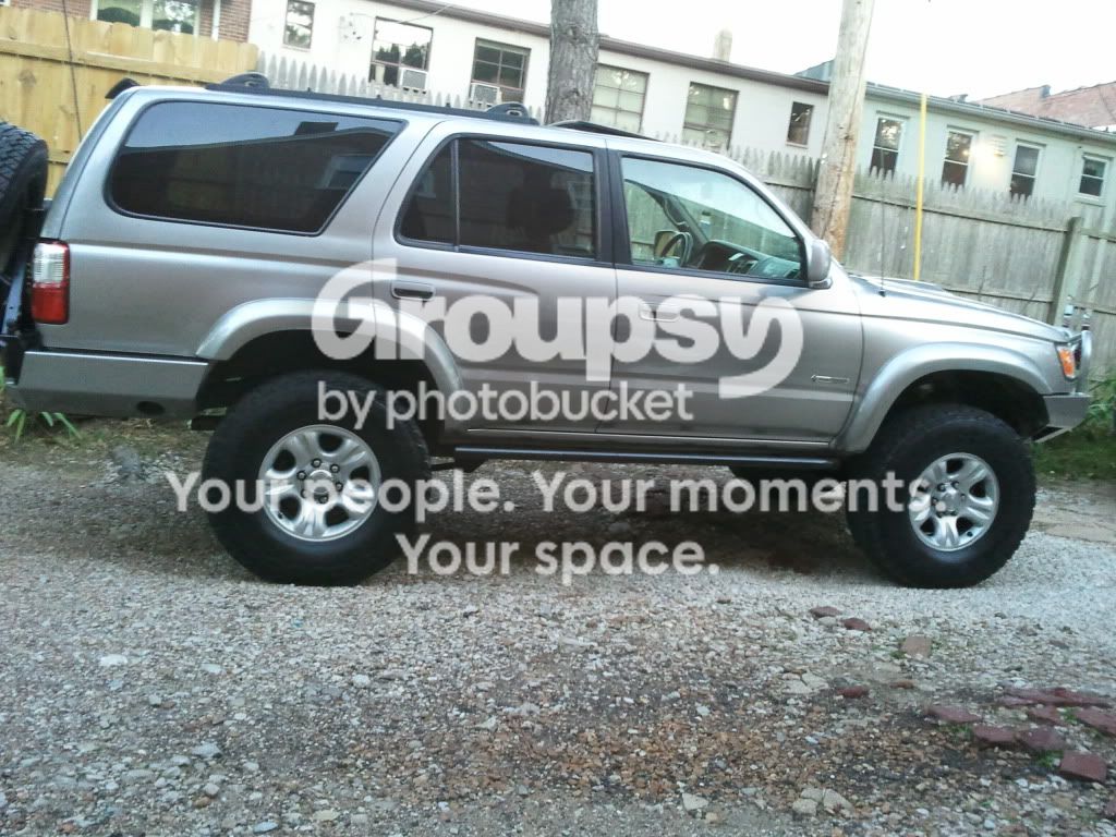

i run 265s and i have LC 8 wraps on my 4Runner with stock bumpers...i gotta buddy that just put the Superflexx on his 4Runner and we sit right about the same height in the rear, he is running 285s though...
