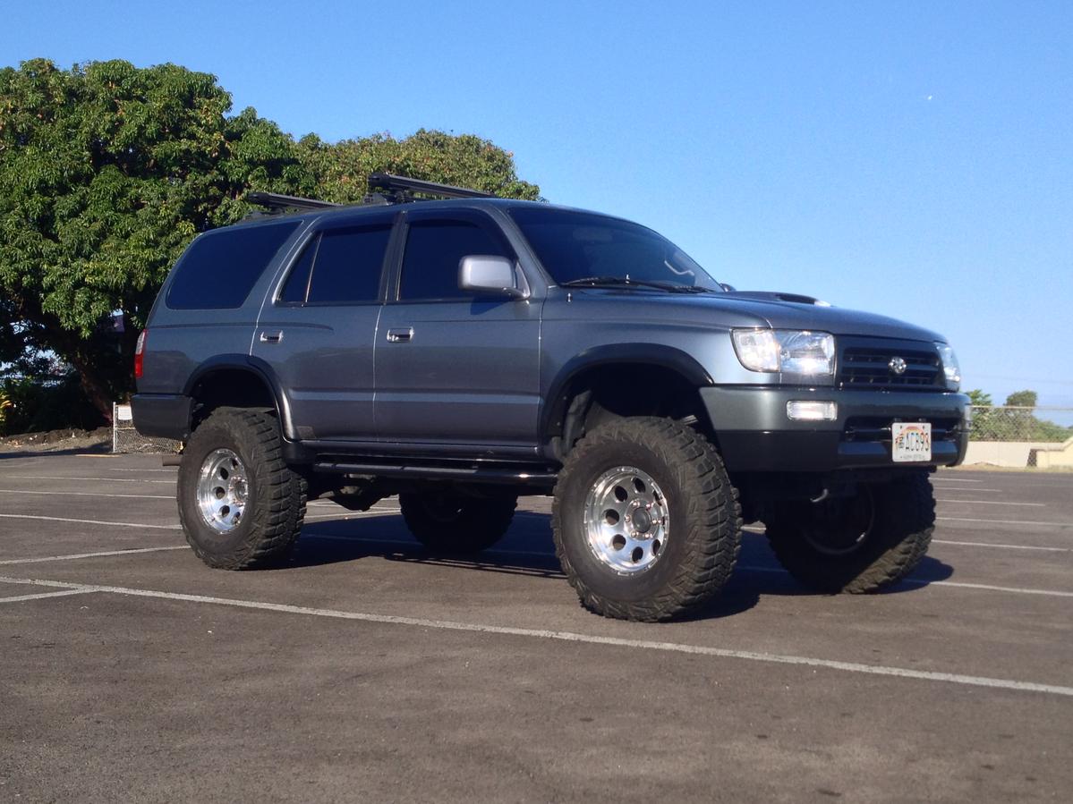

They will give you roughly an inch of rake in the rear. The ride is really nice, way better than my old 890s. they handle weight really well too. here's a pic for reference, ive got eibach coils in front giving me about 3'' of lift
awesome truck^ i wish they offered a sping that would sit about 1.5" lower tho it looks like the LRCA's are to short stuffing the tire in the front of the wheel wells

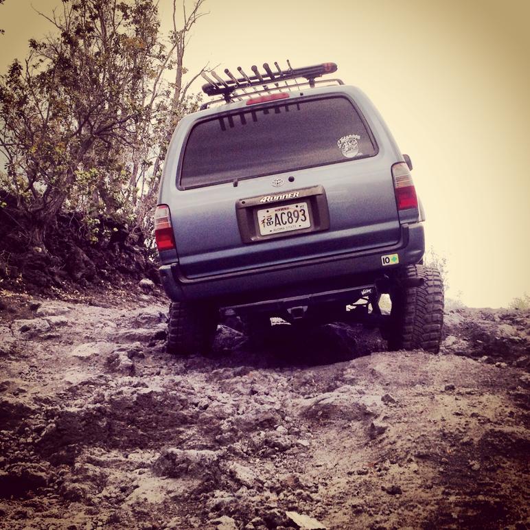

I took out my 891's for the superflex. LOVE UM!
Holds A LOT of my camping/fishing gear with no saggy diaper
