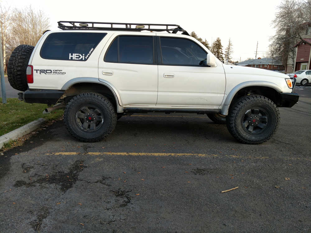

The superflex could be too tall if you only want a 1.5-2" lift. I have the superflex coils and I am at a solid 3 maybe 3.25/3.5" lift in the rear with a steel rear bumper with swing out, a platform that is defiantly lighter than yours but still adds probably 30-40lbs, and a sub that is also 30 lbs, So I have at least 250 additional weight in the rear and it could be more. When I loaded it with camping gear for a 5 day trip I might have sagged .25-.5" so if you want a 2" lift with only the platform I would say the superflex would be too tall. They will probably give you a 3.5" lift or so. They are awesome coils but they are tall coils. Pictured is how it sits, Toytec Boss coilovers in the front at 3"... This was pre-platform but 30lbs isn't going to do much when there is already 200+ back there especially with a 285 on the swingout and two jerry cans.

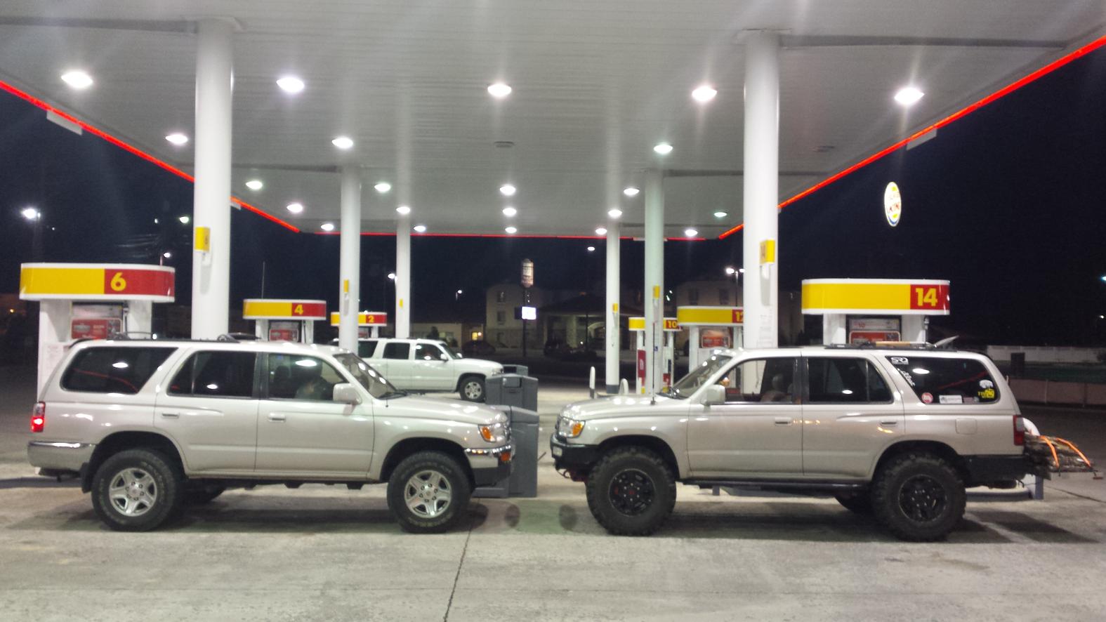

Here is mine with 99 springs in the front and OME 890s in the rear (The one on the right). I'm loaded up with camping gear, tools, food, and wood on the hitch hauler.
