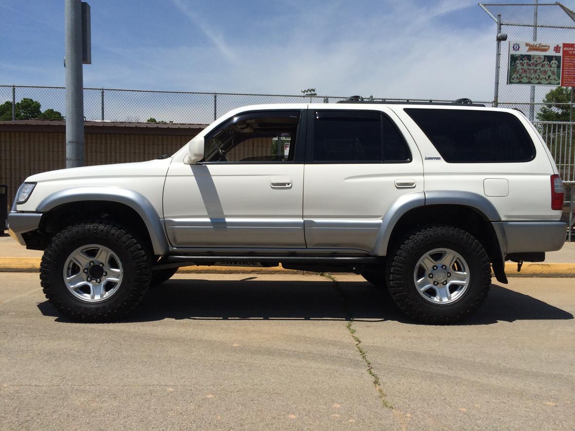

Got the Ultimate installed today. Thought I would get more out of the OME 890's in the rear.
hub to fender measurements
F - 21 3/4
R - 21 5/8
Got about an inch of threads at the bottom of the front coil overs giving me about an 1/2 of rake. I do have about 100 lbs of stuff in the rear.
My 99 springs are 20.5" in the rear. I was going to go with 890's but decided to go with LC 8 wraps for more lift, smoothness of ride & the weight I'll have back there. I'll post final lift dimensions. It looks great though! You should measure with nothing in the back.
I had OME 906 is the rear before the upgrade and the rear was 21 1/2. I was hoping to get at least an additional inch of lift.
Yeah, Shrockworks that explains it. From the first profile pic it looks almost like that center hoop is angled backwards towards the grill or is it just my eyes?
You have a fine looking Runner there sir. Great color combo and color matching the bumpers was definately the right way to go and the clear corners up front really set it off. Simply beautiful.
