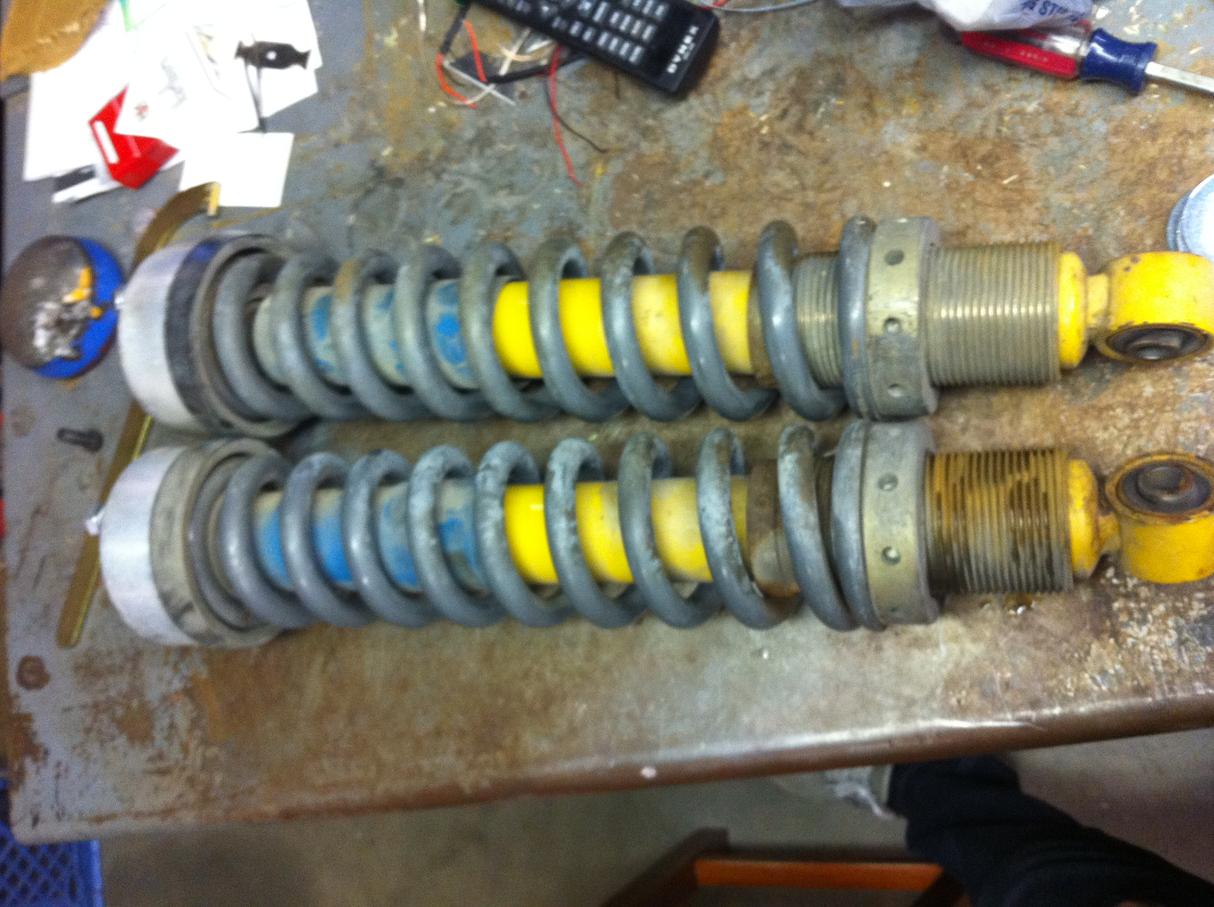

so i picked these up over the weekend, they are older downey coilovers. threw them on and they feel great, 700 lb springs they were cheap so ive decided to run them till i find some real coilovers
Did you get these from someone in colorado by chance? I just ask because I saw a set just like these on craigslist for a while.
