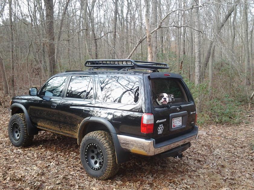

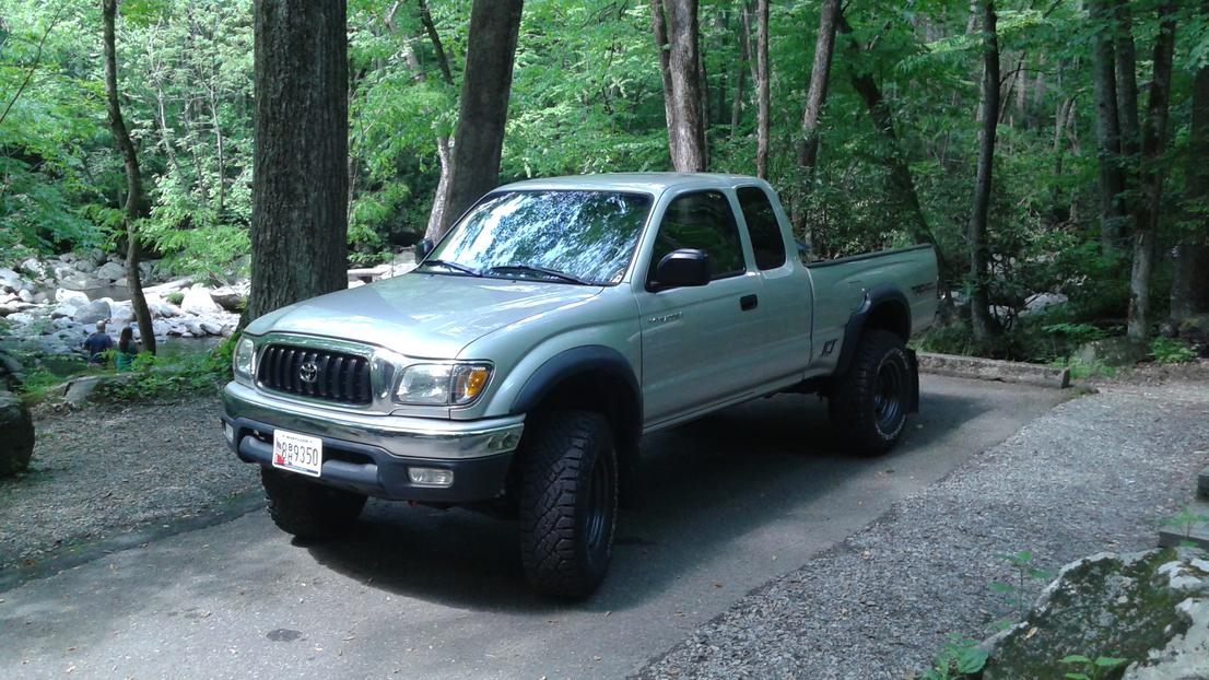

I have the Toytec Ultimate lift on my 00 4runner and the Toytec Boss lift on my 04 tacoma. Both trucks handle and drive nice, no disappointments here.

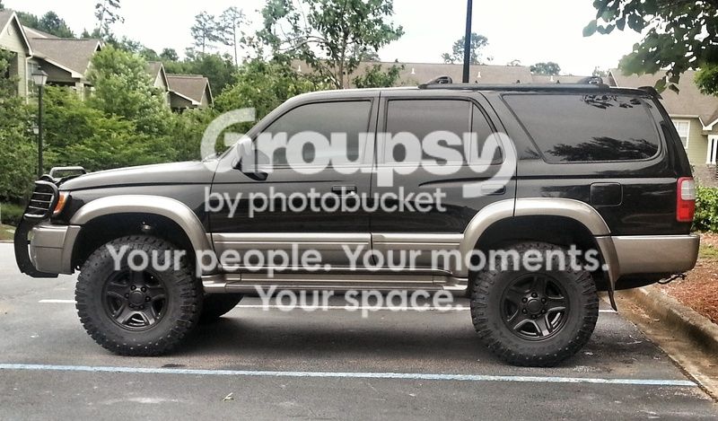

I have the Toytec Boss, haven't really had the opportunity to test yet, but I like what I have see so far.
Not nearly as Hardcore as my Taco's Camburg/Icon 2.5/2.0s setup, but two completely different beasts.
