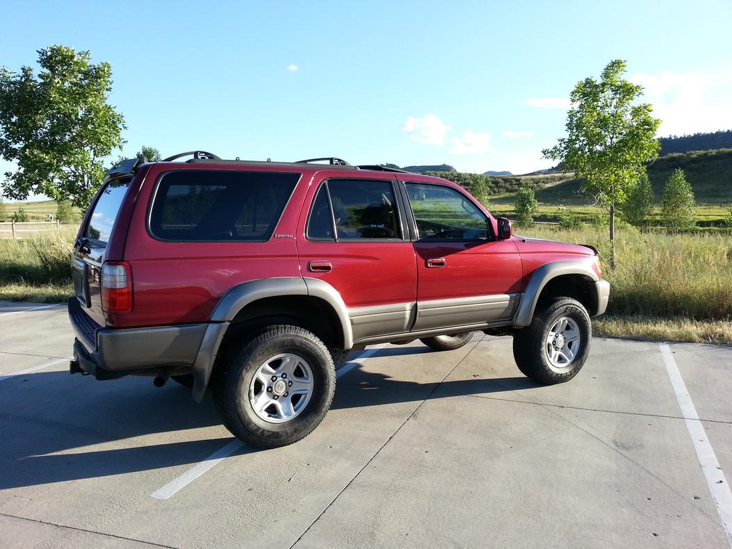

It's not a "must", as stated by other members. You'll lose a little track width with the lift. You can hide it with bigger (read "wider") tires. Or get it back, and then some, with the wheel spacers. I like the look and the feel much better.

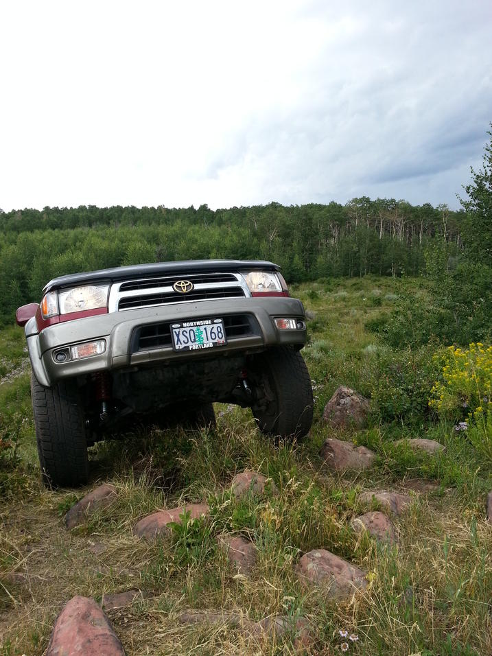

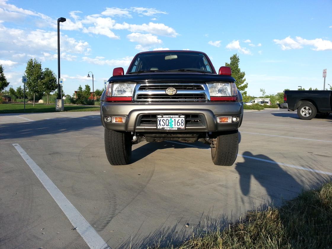

Here's my rig a day or two after the lift, before I installed the spacers. This is before the alignment, so the excessive positive camber is pretty obvious. 1 degree of it, according to my alignment sheet.

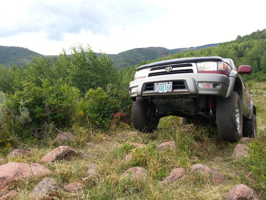

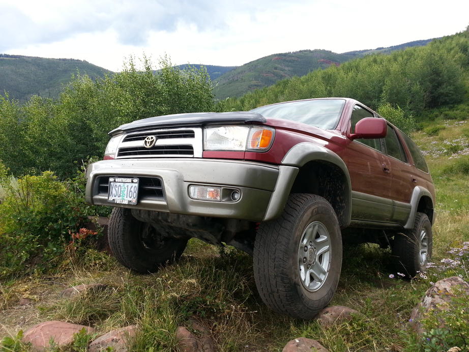

Here's a couple of shots from the side without the spacers or the alignment.

Got it. Hmmmm.... I wonder how funky mine will look without them

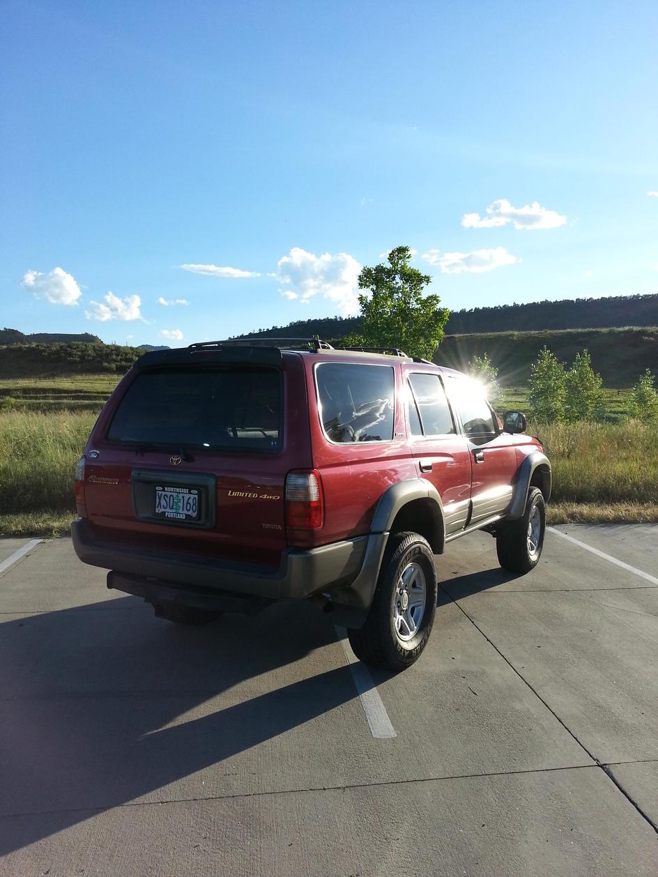

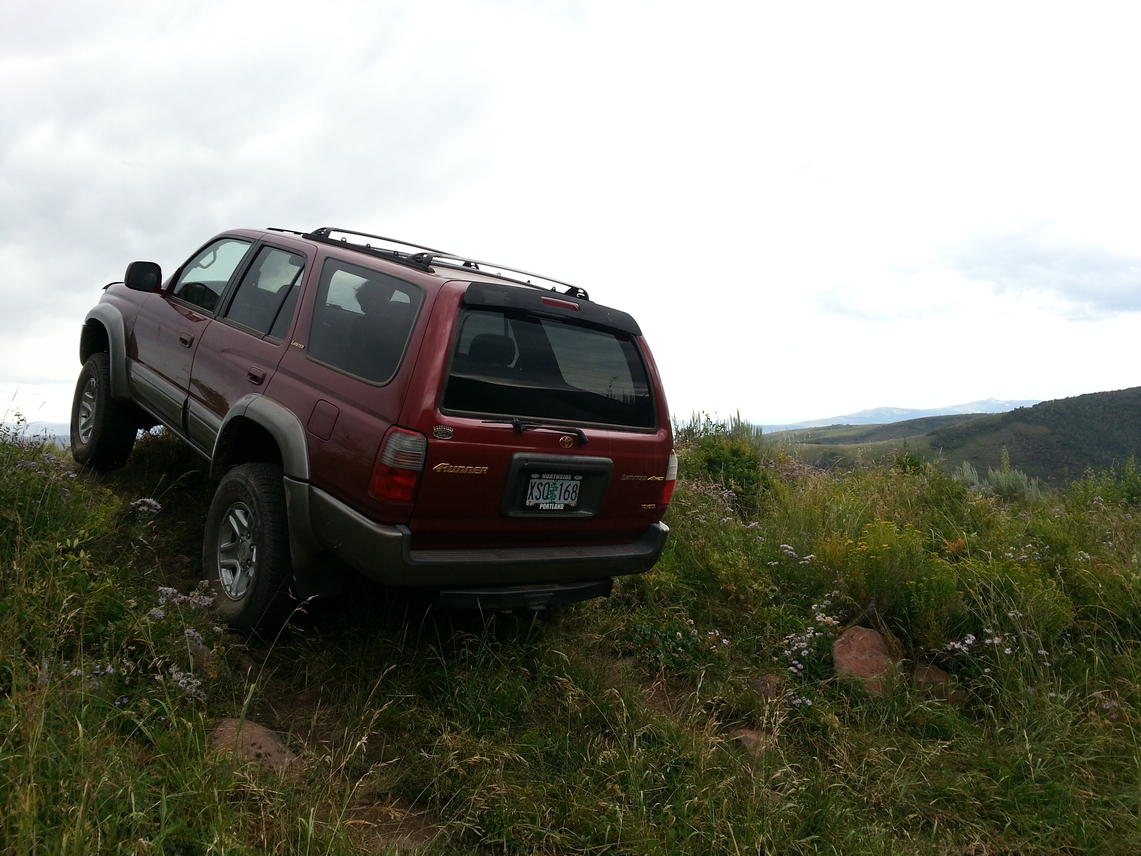

Not the best direct comparison, but these are with the spacers. You can see how the tires are pushed out closer to the edge of the fender flares. I think it looks a bit cleaner and a bit more aggressive.
