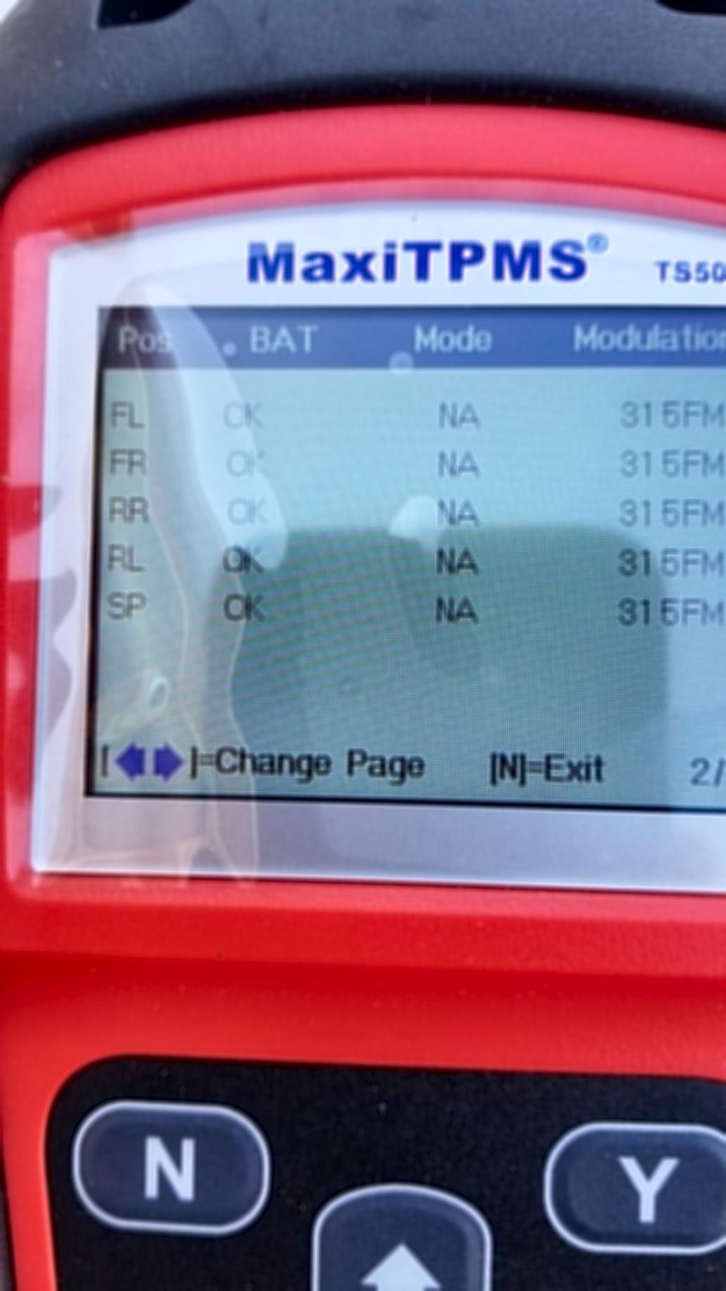

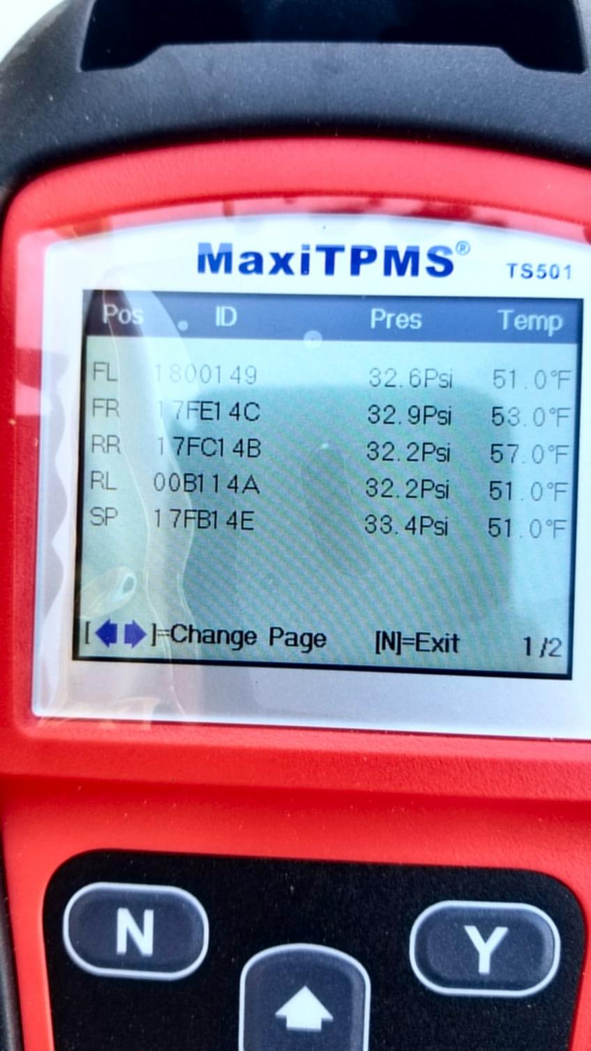

The Denso TPMS sensors in my '04 lasted until 10/22; 18 years. One was bad but the other four were still reading. I bought 5 Denso sensors off Amazon and had a local tire store replace them. I bought an Autel Maxi TS501 TPMS reader to read and program them. Now I can use the Autel to check pressure, battery and tire temp just walking around the vehicle.
Sensors $34 each
Autel Maxi $200
Tire dealership $25/tire (He said if I had bought the tires from him he would have done it for free.)
A little expensive but cheaper than the dealership, they are Denso sensors and I have a TPMS reader so it's easy to tell which tire is low when the light is on.
When a sensor goes bad the light flashes. To find the bad one start with a tire, lower the pressure 5 lbs. If the sensor is on (not flashing), that sensor is good. Air it up and go to the next one until lowing the tire pressure does nothing and the light continues to flash. That will be the bad sensor.
