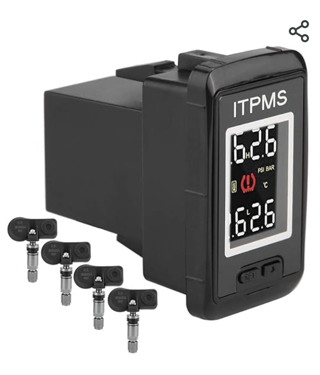

Saw something like this pic on amzn…..
Just a simple way to have real time tire pressure in the cab of the 4Runner.
Anyone have experience using this item or something similar in the picture?
Would much rather have the sensor internal verse the external valve stem caps.
No reviews so I would avoid this product.
The description says to attach to the valve stem, but the picture shows TPMS sensors that need to be installed.
Your Denso sensors operate at 315 Mhz but it looks like these operate at 433.92
If you swap out for different sensors you'll need to disable the OEM system.
If you want to go ahead you should contact the seller for more details.

Yea, was a little concerned there was no feedback on the amzn TPMS system. But makes sense since they are 433MHz (UK?) and we use 315Mhz (US)
But that pic is what I am looking for but compatible with 315MHz. Just can not seem to find it.
Guess I could use the above 433MHz BUT my tmps light would be constantly on unless it did the disable hack (which I prefer not to do)

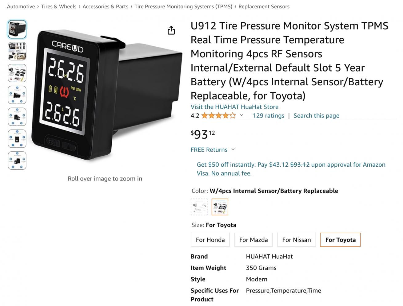

Think I found a system that might work with 315MHz on amzn. Even has US reviews.
U912 Tire Pressure Monitoring System Customized for Toyota
Anyone have any experience?
Amazon.com

Do you know at what psi does the light come on at?
I believe it's like Patch4R says, around 27 psi. I always thought it was 5 psi below the other tires but I never tested that.
If a sensor goes bad the light flashes but you don't know which one it is. Air up all the tires (spare too) then lower the pressure below 27 psi one tire at a time. If the sensor in that tire is good the light will stop blinking and stay on. If it continues to blink, that's the one with the bad sensor.
