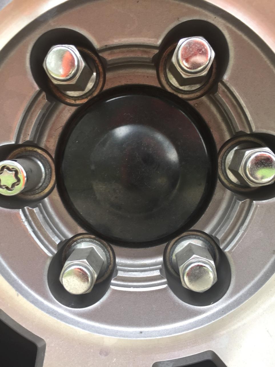

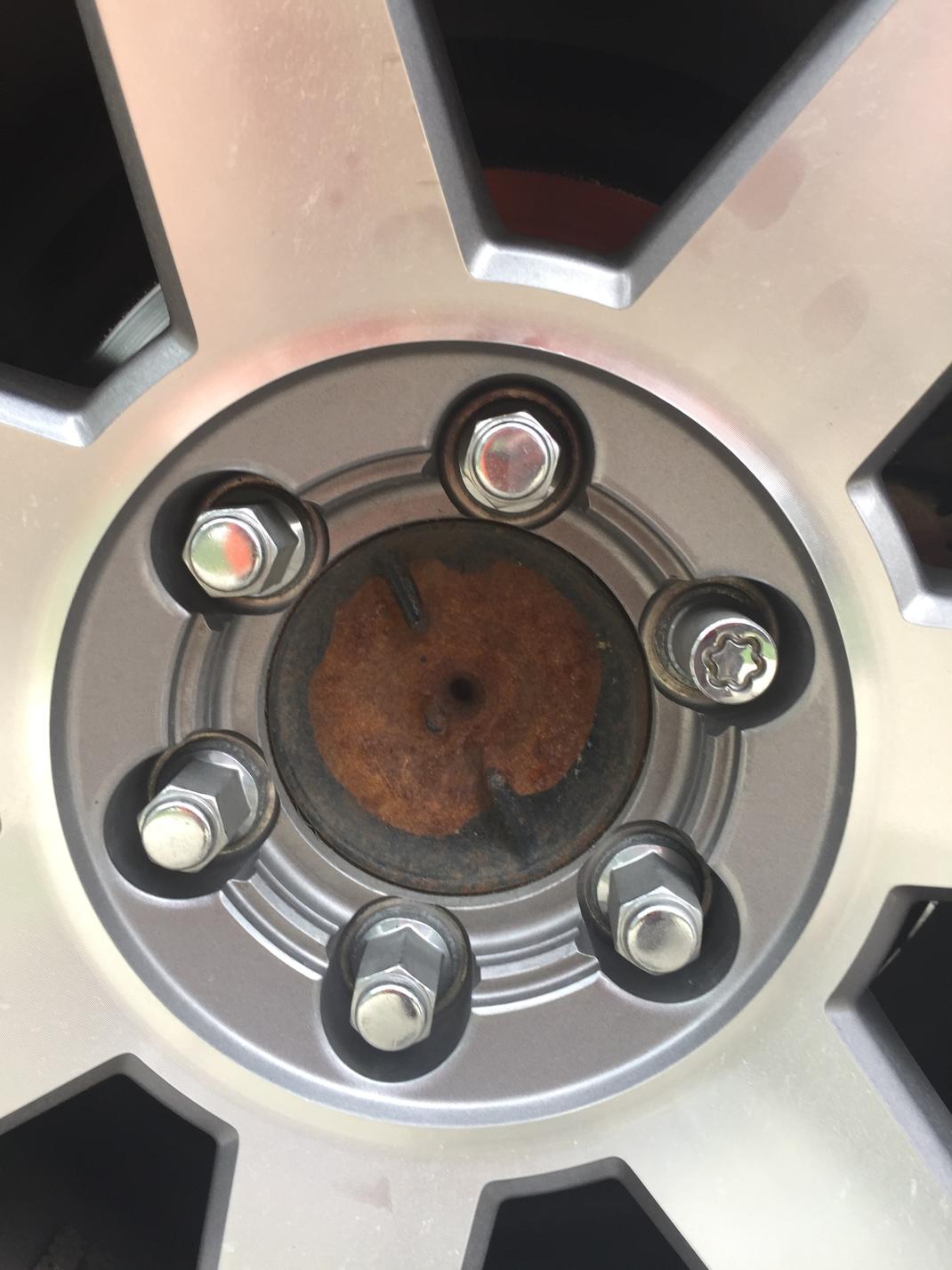

Sorry for the crazy title description, but it was the best way I could think to describe what appears to be missing on 2 of my 4 TR4 stock Trail wheels. The other day I removed the center caps to find 2 wheels with what appears to be an inner black cap and 2 without. I don't think this is normal and wanted to throw it out to the forum and see if anyone else has experienced this or might have an explaination. In the pictures, you can clearly see the difference. This would not really be an issue, but I had great plans to powder coat the wheels and run them without the external center cap.

Totally normal
You have no need to worry.

What you are describing is actually the grease cap on the front hub, it covers the front axle nut on the end of the cv shaft and protects the front wheel bearings. it is not part of the wheel itself
Thank you for the info! Sorry again form the misleading description - I just assumed those center caps would be on all 4 points of the trunk.

I ran without for well over a year. It won't hurt anything - some like the look other don't
The black grease caps will fade. The rear hubs will rust...more.
I've run mine without caps for over 6 years. I wirebrushed the rear hubs and painted with brush on Krylon enamel and they're still holding up. I've been planning to plasti-dip my rims for years but too damn lazy.
