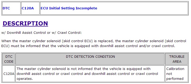

Hmm...not really sure what else it can be because I think that the C120A code only indicates that the initialization between the master cylinder solenoid and the DAC is incomplete.
I think in laymen's terms, the master cylinder solenoid and the DAC switch just need to tell each other, hey I'm here and present and accounted for.
The other possibility is that there's an open circuit along the path between the DAC switch and the master cylinder?
If you want be sure and rule out the ZPC, why not try it out yourself right now it's REAL simple and almost impossible to screw up as long as you have a flat surface :)
