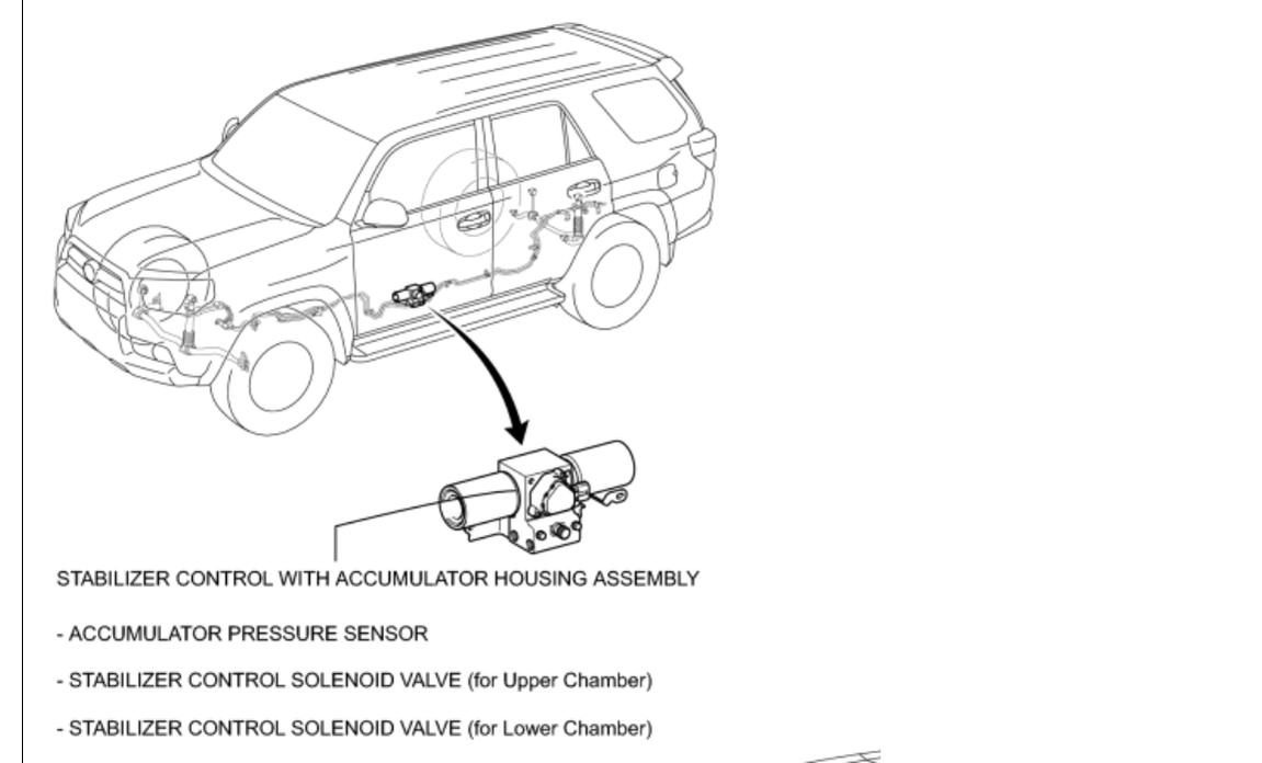

recal
I can't find the instructions, they must be with my forum operators guide!
The is a small skid on the frame rail under the drivers door.
TIS FSM
the exact instructions are available:
http://www.toyota-4runner.org/5th-gen-t4rs/92594-modifications-write-ups-quick-links.html
it takes longer to read the instructions than it does to recal it.
I hope this helps. Good luck.
I think Antman's estimate is more better than my two, really 7.5 min job
