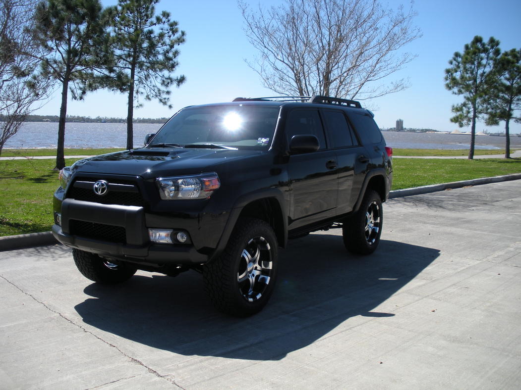

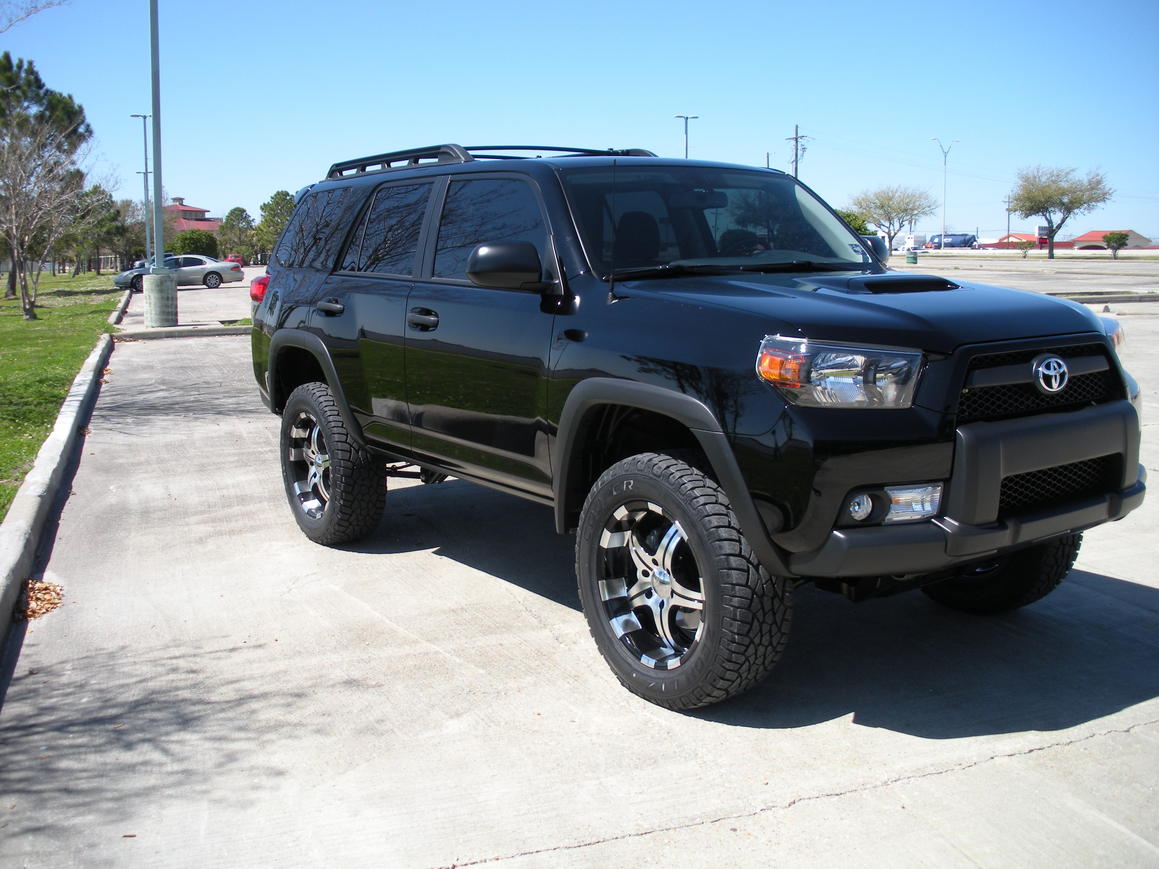

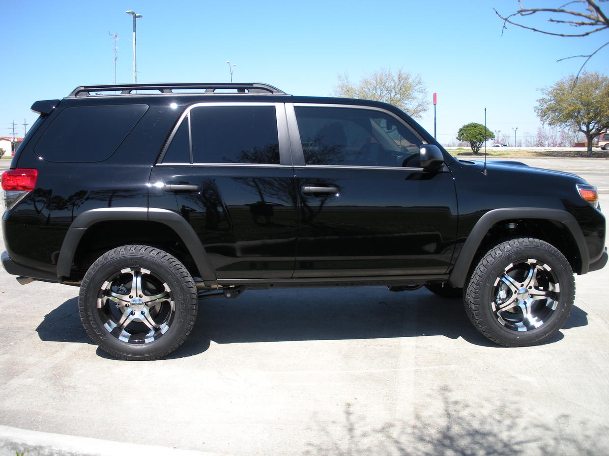

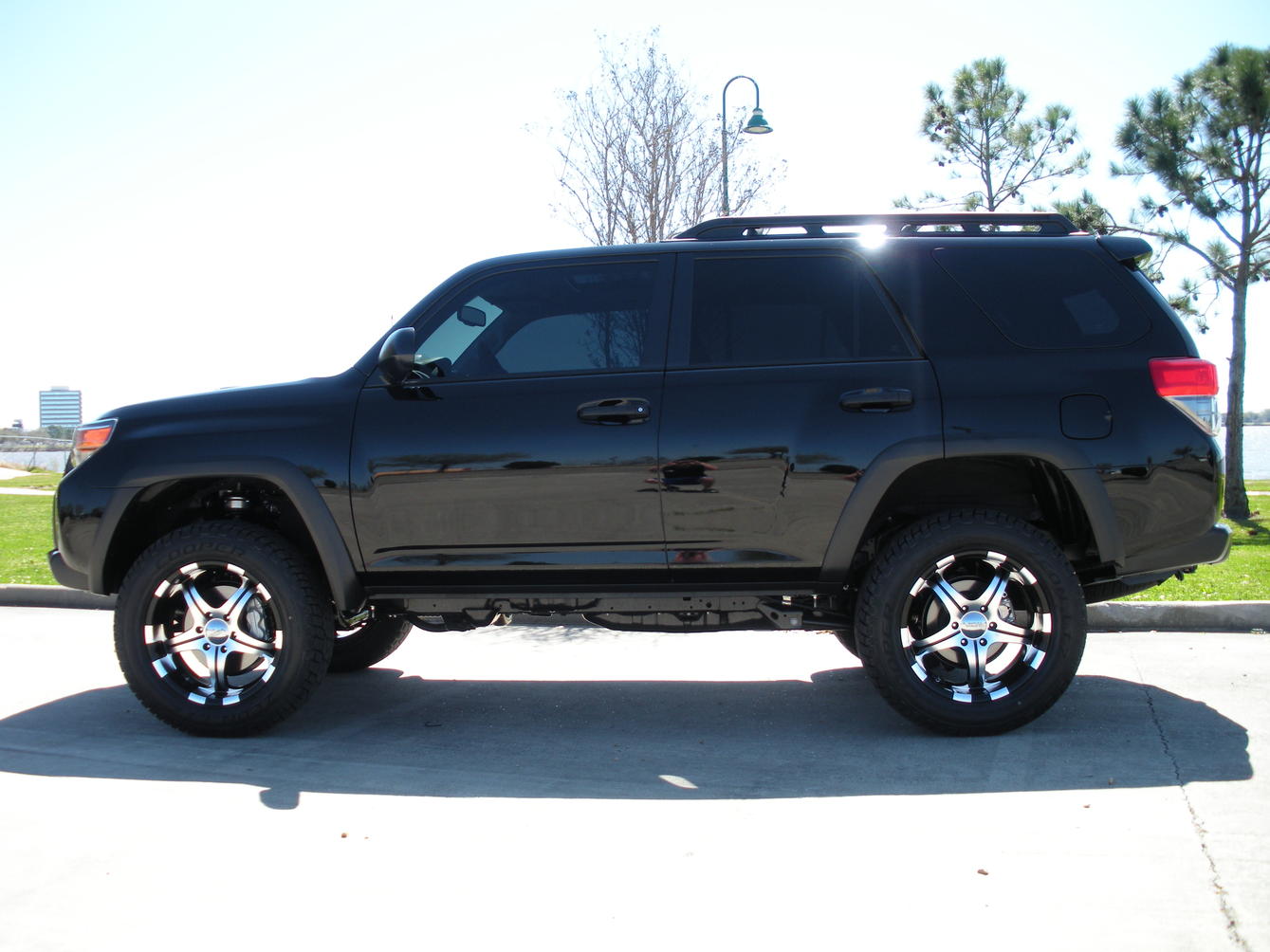

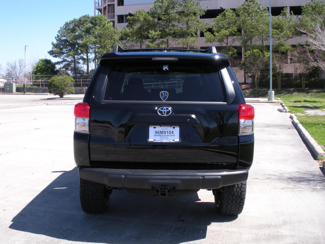

Trail edition/lifted
DEMEAUX
TRAIL EDITION W/KDSS
3" TOYTEC FRONT SPACERS
2" TOYTEC REAR COILS
COOPER ZEON LTZ 275/60R20
LIQUID METAL FLARE WHEELS 20X9
15% TINT
REMOVED MUD FLAPS
REPLACED 8' TALL RADIO TOWER
REMOVED "4RUNNER"
note to self dont remove badging from vehicle when one hasnt slept in 32 hours....very bad idea...if anyone knows how to remove scratches from black plastic please fill free to help a brother out..anyone looking for T.E. rims and tires pm me know mine are for sale....

Unbelievable...nice work. Looks great!
Question though, what antenna is that?
Looks great!!:beer:
Way to step up to the plate and be the first to lift a T.E.
Truely a groundbreaker!

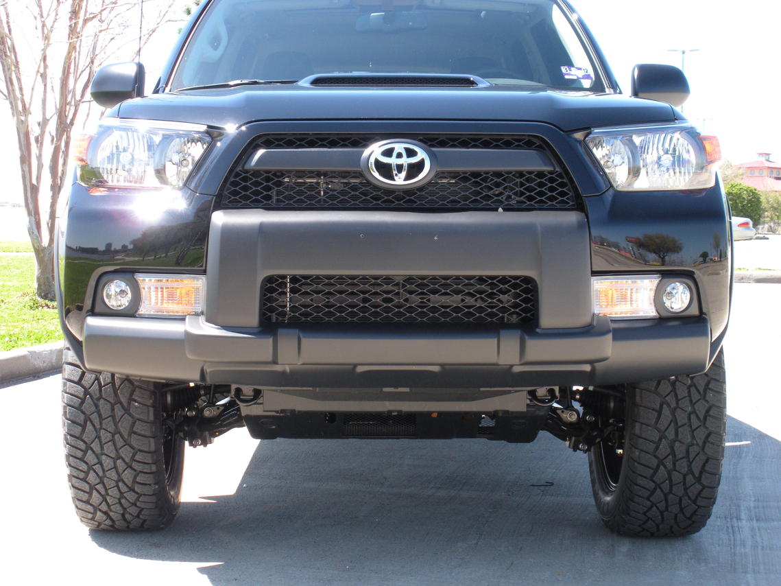

doodman--doug with toytec hooked me up, i have bugged him for the last 2 weeks with questions and concerns..the tech who installed it said it wasnt much more difficult than a 2009 t4r, he said the sway bars gave him the most problems...i paid $150 for the spacers and coils(doug gave me a discount) $300 for the labor and $50 for alignment...$1100 is way to much for a level kit in my opinion
looks real good. glad to see those rear coils work. i guess you didn't replace the rear shocks? do you notice your stock shocks being maxed out when u hit a speed bump or something? And i take from the 20's that you won't be off-roading. i'd definitely go this route if that were the case. nice work.

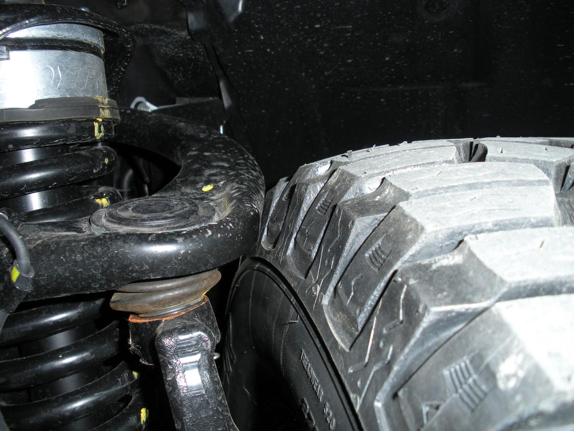

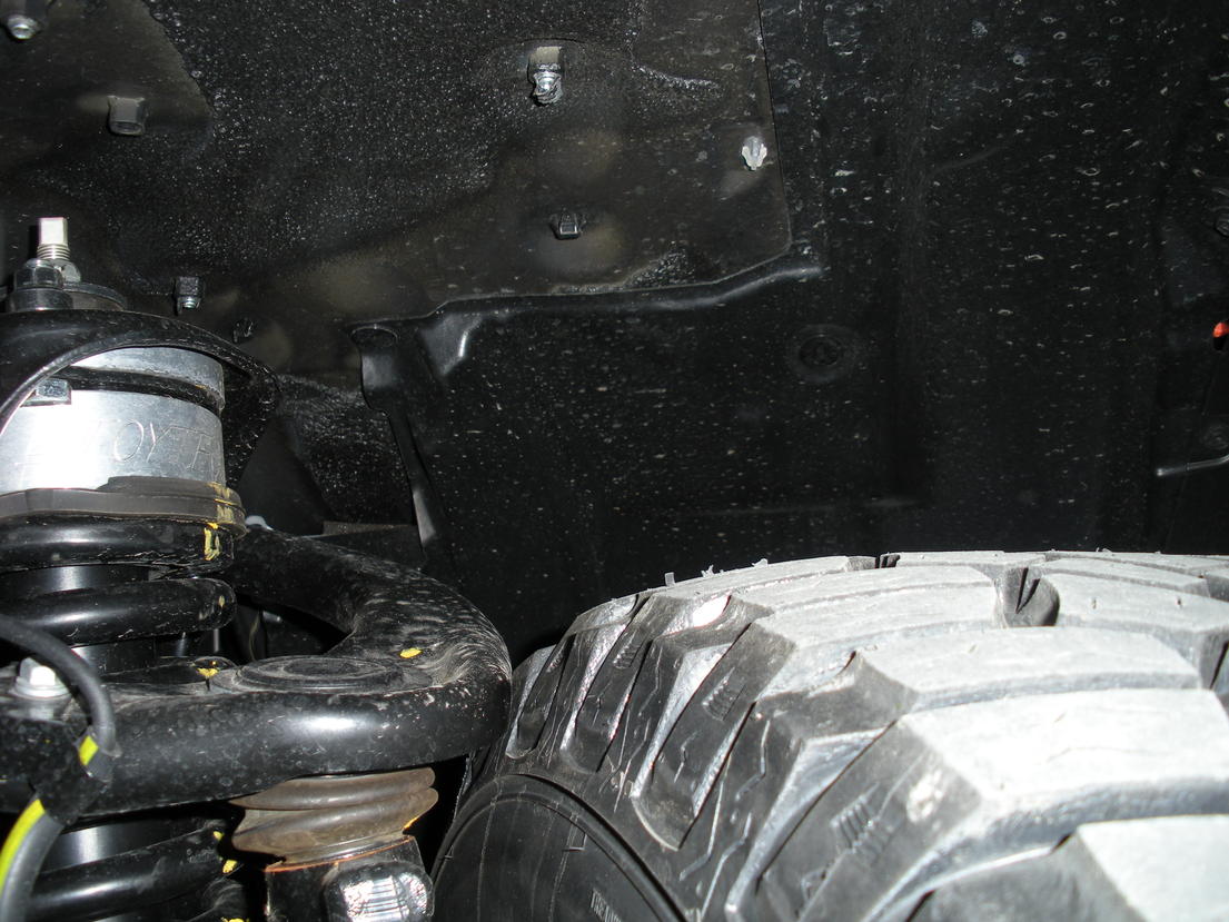

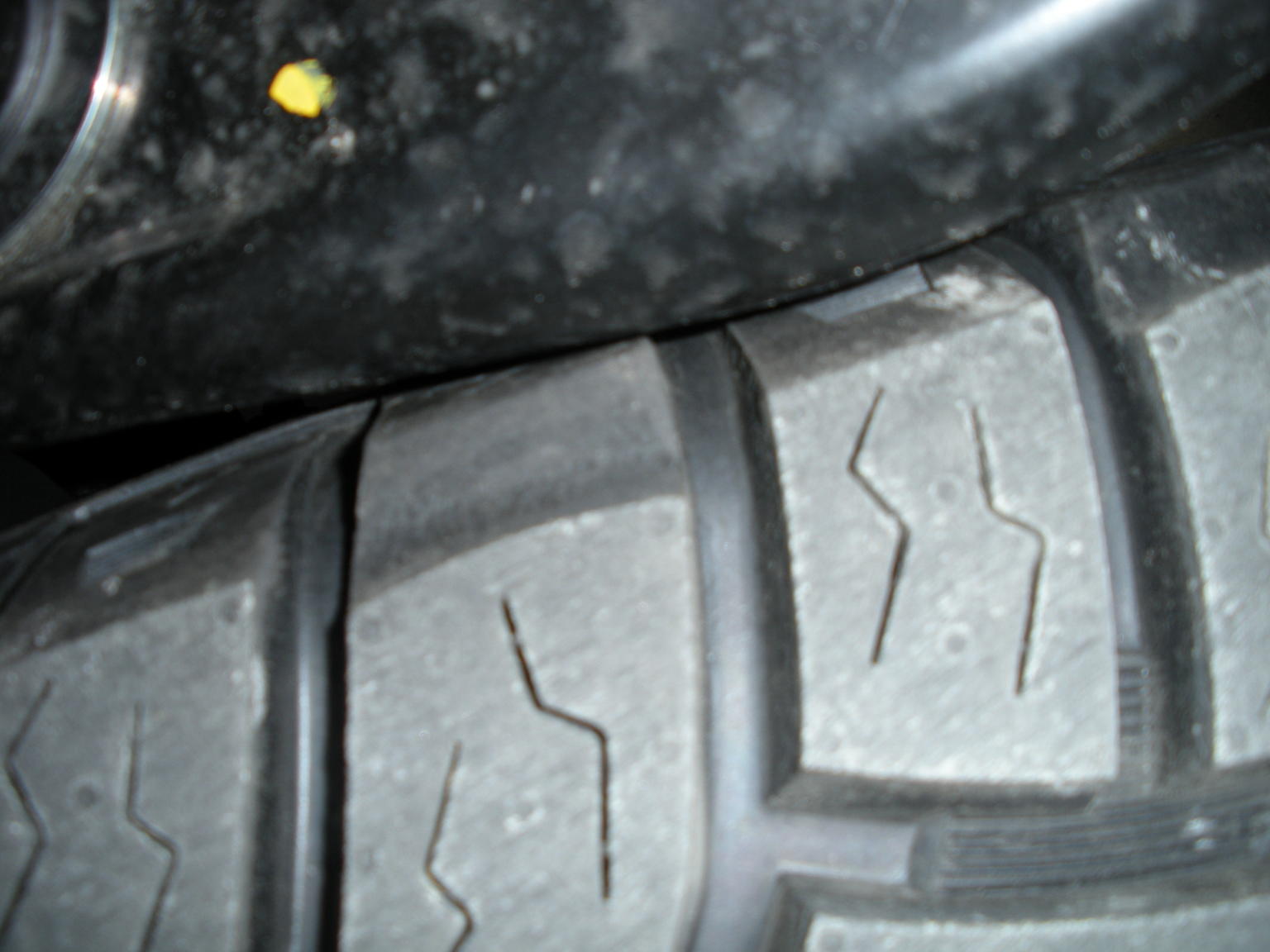

here are some pics of the upper a-arm rubbing on the tire...sorry dont know the back spacing

I am running same lift and tires, love both. I am also rubbing on Upper control arms or UCA's for short. You and I both need new ones. You can buy from Light Racing, Icon, All Pro Off Road to name a few. I am pretty sure they will fit since everything else for FJ's fit the 2010. They are nice because they give you more clearance right where we need it for wider tires, they also put everything back into alignment after lift.
Spacers will take care of the problem, but in the end you will be much more happy with new UCA's.
Toy Tec has the Light racing units on website. I am sure they can help you out.
DEMEAUX - from one of the pics you posted it looks like your tires aren't pushed out very far. i would guess spacers or different wheels would help your uca issue. looking at your pic i'm not sure aftermarket uca's would fix the rub. aftermarket uca's have a uniball which allow for a more straight connection to the spindle, and they are usually needed when you change the geometry of the suspension. i would try spacers before paying $500+ for good uca's, especially if they got your alignment back close to spec.
Every pair of aftermarket UCA's I have seen including the set I installed on my last FJ are made to provide greater clearance for this exact issue. I would be extremely surprised if it did not fix your problem. And he did change the geometry of the suspension, he lifted it 3" inches :)
You will notice a change in handling and ride with UCA's. Yes the least expensive option is $500 but definitely the correct way to go.
