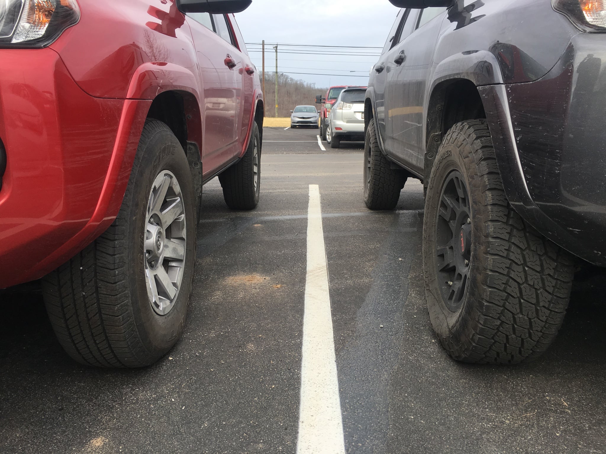

Here is my 4Runner Trail beside a coworker's Pro. Both are stock.
I had the trail wheels and i upgraded to the TRD wheels and there is no difference in performance. I black prefer the look over the silver on my white car.
Also, the wheels seem to stick out slightly more than the trail wheels giving it a better stance in the wheel well - or that's completely untrue and it just appears that way to me.... I don't know.
For the two rigs having the same size tires it are shows the bridgestone's don't measure up on width. It's pretty much my least favourite part of my trail edition, soon to be fixed with a set of proper ko2's or duratrac's. The trail wheels look nicer once a proper set of tires are mounted on them.
The trd pro wheels have a different offset and therefor they do stick out a bit more, this is true for all trd pro models, gains width for more stability to accompany the added height as well. I believe the Tacoma trd pro gains 1/2" at each corner for 1" overall wider track.

Trail Wheels, Duratrac tires
We have the stock Trail wheels on our 4R but the dealer had fitted Goodyear Duratracs on it as a demonstrator. He offered to trade back to the oem tires, but we said "No-o-o-o thankyu". After seeing that comparison, I'm sure happy with what we have, both wheels and tires. - Ted
