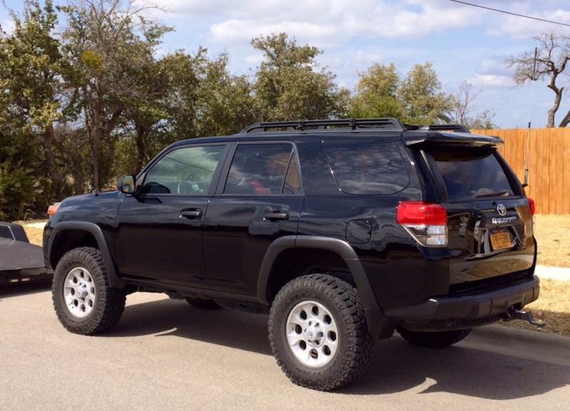

to be thorough, i will add here that the 2010-2013 Trail Edition wheels (phone-dial style) are 17"x7.5" and weigh 29 lbs.
http://www.toyota-4runner.org/5th-gen-t4rs/129378-weight-wheels.html#post1228882
(not my pic; credit to fellow member here)

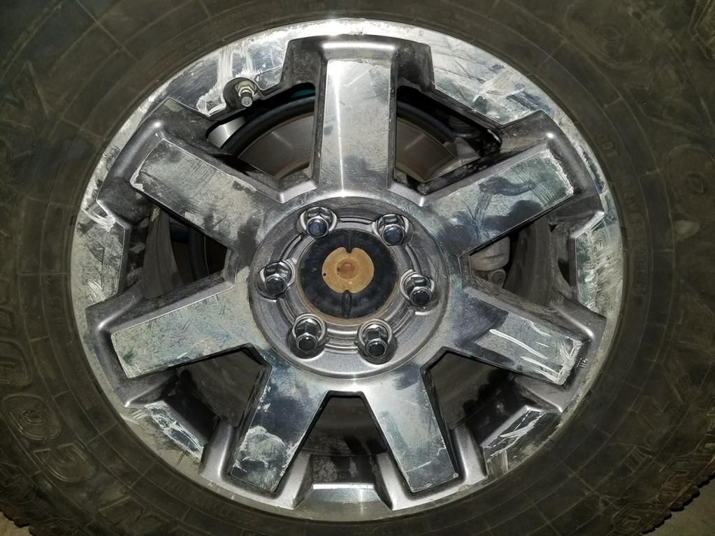

If offroad driving is the goal - the Trail wheels are better. They have significantly more material around the bead area and will resist impacts/rocks better. They have a protected valve stem - that's critical for anyone who wants to play in the rocks and IMO makes the TRD Pro wheels a non-starter for that type of use. And the Trail wheels are wider - meaning they can fit a larger tire.
This is one of my trail wheels. Were it a TRD PRo - I'd have been replacing the valve stem. In this case I'd have to probably put a temporary valve stem in, then buy another $100 TPMS to put in later. Most people don't use their wheels like I do. So for most it's not a problem. For me - it is.
And incidentally, IMO the trail wheels are an exceptionally good value - I can buy a set for around $200 in like new condition. Short of a beadlock, they're about as good as it gets for an offroad wheel design.
