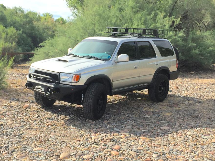

Got a new iPhone 7 Plus the other day and wanted to test out the camera. Here are the 4xInnovations sliders installed. Don't rag on me too hard, the paint looks like shit. I need to touch them up plus I need to hit the bare metal on the frame still. It's been 105 degrees + the past week, so my motivation level has been in the basement.
Right now the truck has too much rake for my liking, and not only that but when I get a bumper it'll be even worse.

Rake is worth down travel up front. Plus when you are loaded up for camping it would sit more level anyways.

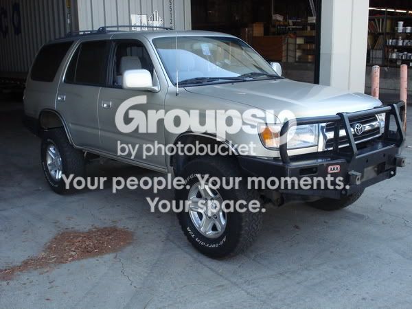

So I thought I was pretty dead set on getting an ARB bumper, but I am doing my due diligence and considering other options. The only thing though is that the ARB is definitely the biggest bang for your buck considering it's price point and it already comes painted. Here's what I have it narrowed down to:
ARB:
DSC02823.jpg~original
Pros: Price point. $850 shipped and it already comes painted. I live in an apartment complex, so I have nowhere to paint a bumper. Also it's looks. I love the classic lines on this.
Cons: Pretty common front bumper, and it's heavy.

Anybody that can sway me in one direction or the other?
No all-pro bumper? Out of your choice I'd go RPM. You could always ask the turn signals be bumped out for the 2" standard ones you can get just about anywhere.

The All Pro is too expensive for my blood once you factor in powdercoat and shipping. It'd be close to $1500 to get it with the hoop I want, powdercoated and shipped.
That said, I've all but decided on the RPM bumper. Nate who owns the truck in the photo I posted showed up at our AZ 4Runner meet last night and I got to check it out. Great looking bumper. I am however going to have them delete the turn signals and make the hoop slightly taller.

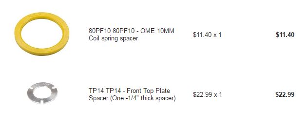

And then there's another trim packer and a front spacer to even out the driver's side rake I have going on.
Today brought some boring maintenance stuff. I did another trans drain & refill, along with throw another trim packer on the driver's side rear spring. I now have two 10mm trim packers on the drivers side and one on the passenger side. Also wired up the front for the LED foglights that will go on with the new bumper.
