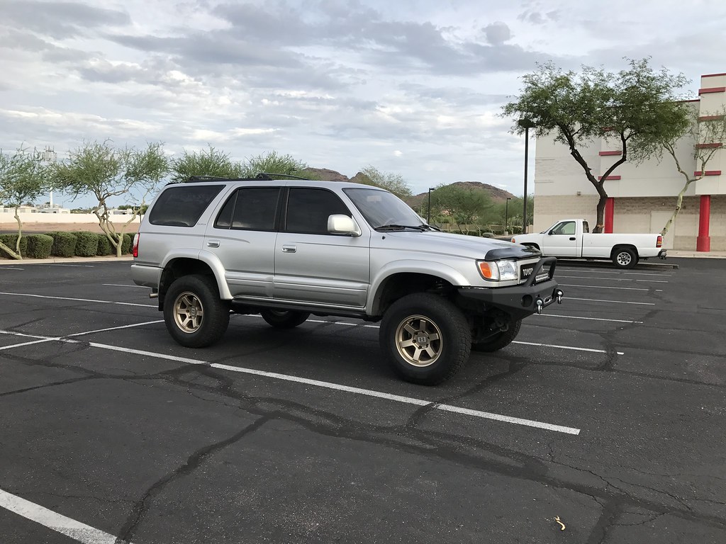

Install went well today! Got both the RPMFab front bumper and the RCI front skid plate installed. I thought that I was going to be able to use 3 of the 5 mounting points up front for the skid plates, but as it turns out 3 of the bolts for the original skid plate were snapped off, so there are only 2 out of 5 holding it on to the front. I guess I'm going to have to drill them out... yay
I was going to raise the 881s up one perch, but as it turns out, I didn't have the right tools to do so and neither did O'Reillys, so I will probably pay the shop I take it to to align it to also move the springs up.

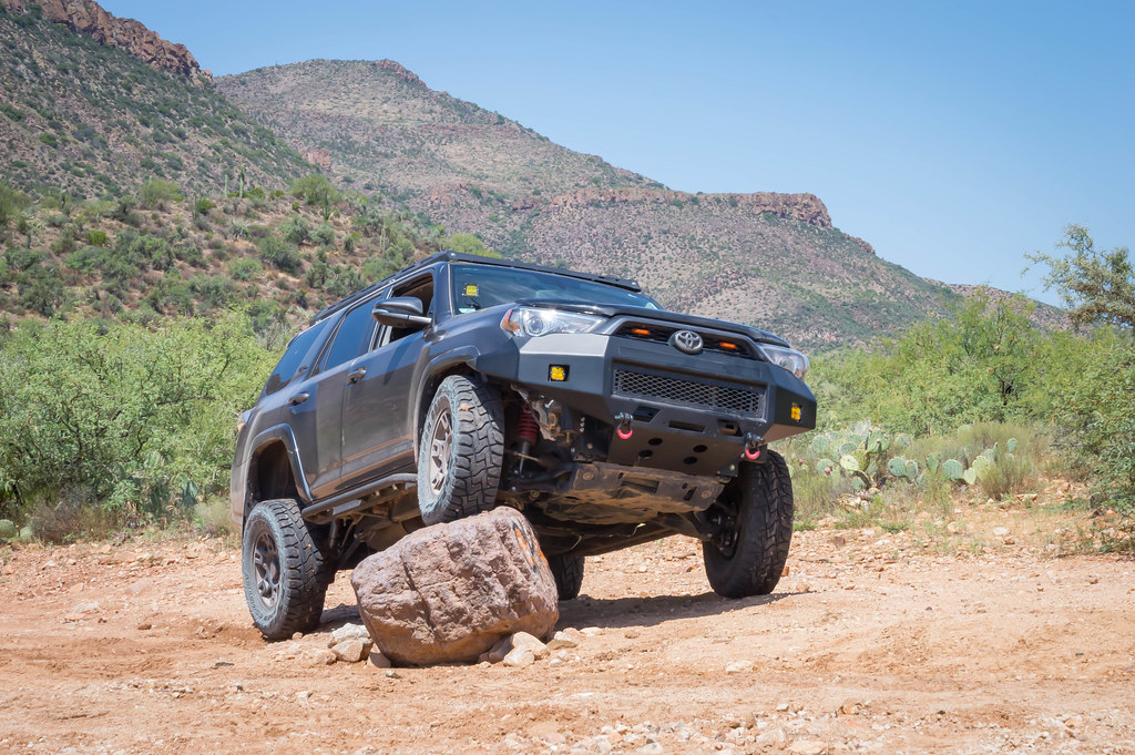

I'm also really happy I ordered the new front springs. The 881s really met their match on the rockiness of Crown King, they are way too soft. Thank god I put the RCI skid on last week, because it came in handy on more than one occasion.

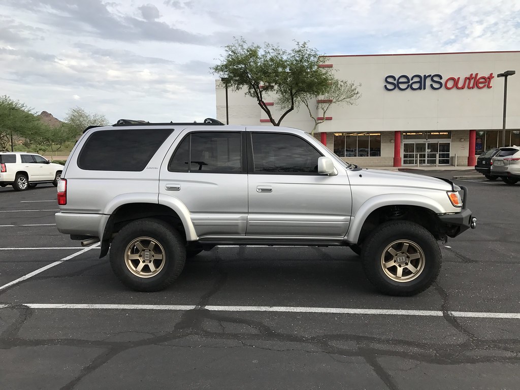

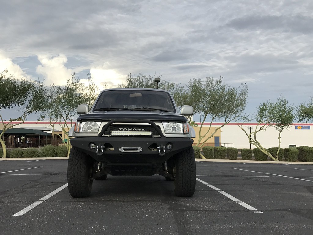

The truck rides and looks so much better with the new front springs. I'm not sure what's going on, but it has a slight pull to the right when braking and when going down the road straight (even though it was aligned the morning after the springs went on). I took a look at the brakes when I put the springs on but nothing looked out of place, it just seems weird that this problem started after I went wheeling last weekend. I'm wondering if either the passenger caliper is sticking ever so slightly or if the brake hose is slightly collapsed.
Untitled by Blake Nichols, on Flickr
Looks Great!
I might take it back to the alignment shop and see if they didn't tighten something down after setting alignment.
