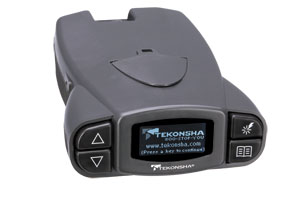

I'm getting my O6 Sport set up to pull my tent trailer. Does anyone have any recommendations for Brake Controller units?
Tekonsha prodigy X2. I installed it on mine for towing my pop-up and now my hybrid. Easy plug and play setup. Being the proportional and inertial, once it is adjusted to the way you like, you'll never have to touch it again.
