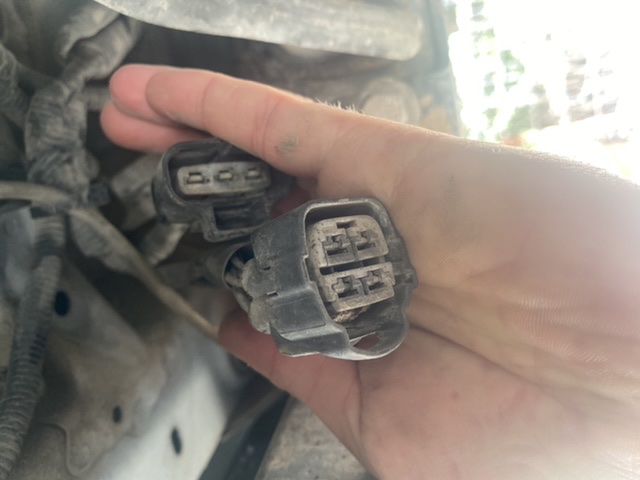

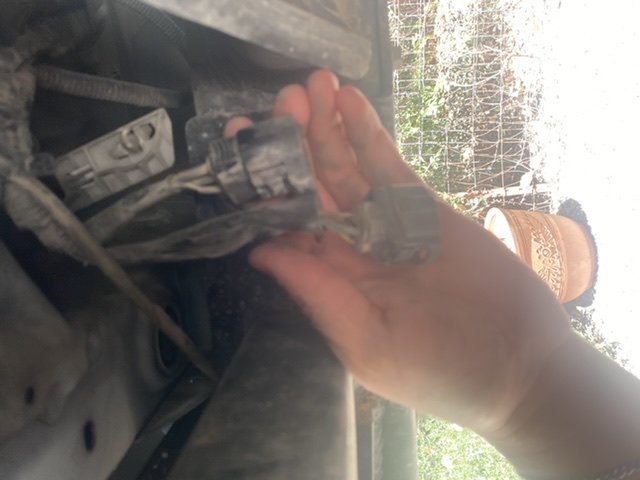

Hey everyone. I just picked up a trailer and need help with figuring the wiring out.
I have an aftermarket bumper and it looks like the 4 and 7 pin connectors were unplugged and removed during the install. I’ve attached photos do what I believe are the two harness connectors that go to the factory 4 and 7 pin connectors.
Can anyone confirm this? I’m gonna run down to Toyota and see if they have the part but any insight would be super helpful. Thanks!

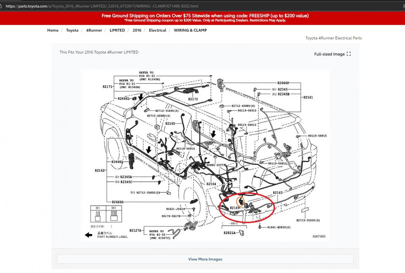

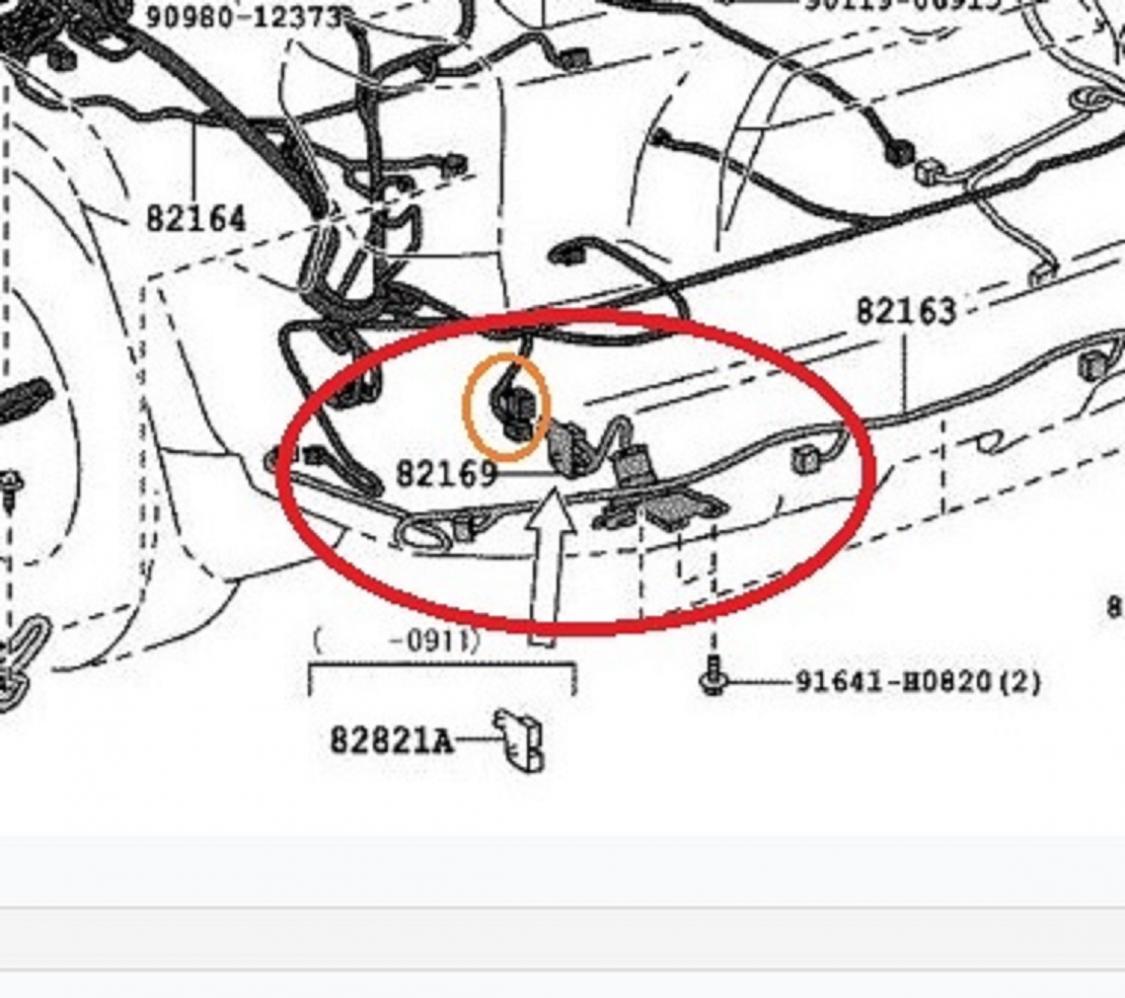

[MENTION=5374]sparky[/MENTION],
Take a look at the photos below.
I think what you are holding in your hands is the 2 connectors that I have circled in orange.
Seems the part you will need is the 82169-0W020 circled in red. You may be able to get that a a junk yard... it appears to be pricy!
