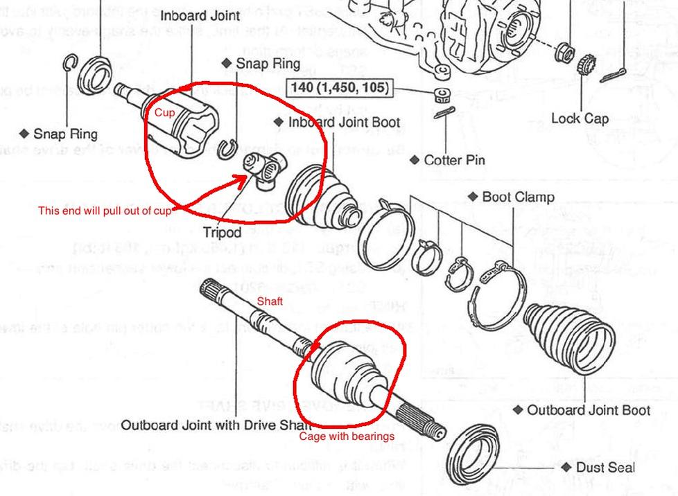

For #2 - usually you break the cage that holds the bearings. Most of the time you break it enough that you can separate the shaft and remainder of the cage from the outside part of the cv that goes through the knuckle.

If you don't have manual hubs, you probably have drive plates, which are pretty much just like manual hubs without the switching mechanism. They connect the splined end of the CV axle to the wheel hub. You can just pull these off by undoing the six small nuts around the center of the hub (not the lug nuts) and then breaking loose the conical washers (not necessarily easy, try googling this). Duct tape part of a trash bag over the open axle to keep out dirt, and you will be driving in 2wd with no CV's turning. A poor man's manual hub, so to speak.
Nope, that's not how the IFS hubs are on the ADD trucks and 4Runners. The whole hub is splined and there is no drive plate. The outer axle needs to stay in place to keep the wheel bearings pre-loaded, so that can't be removed to drive more than a few feet.
-Charlie
This. They even drew the splines in on the picture I threw in.
