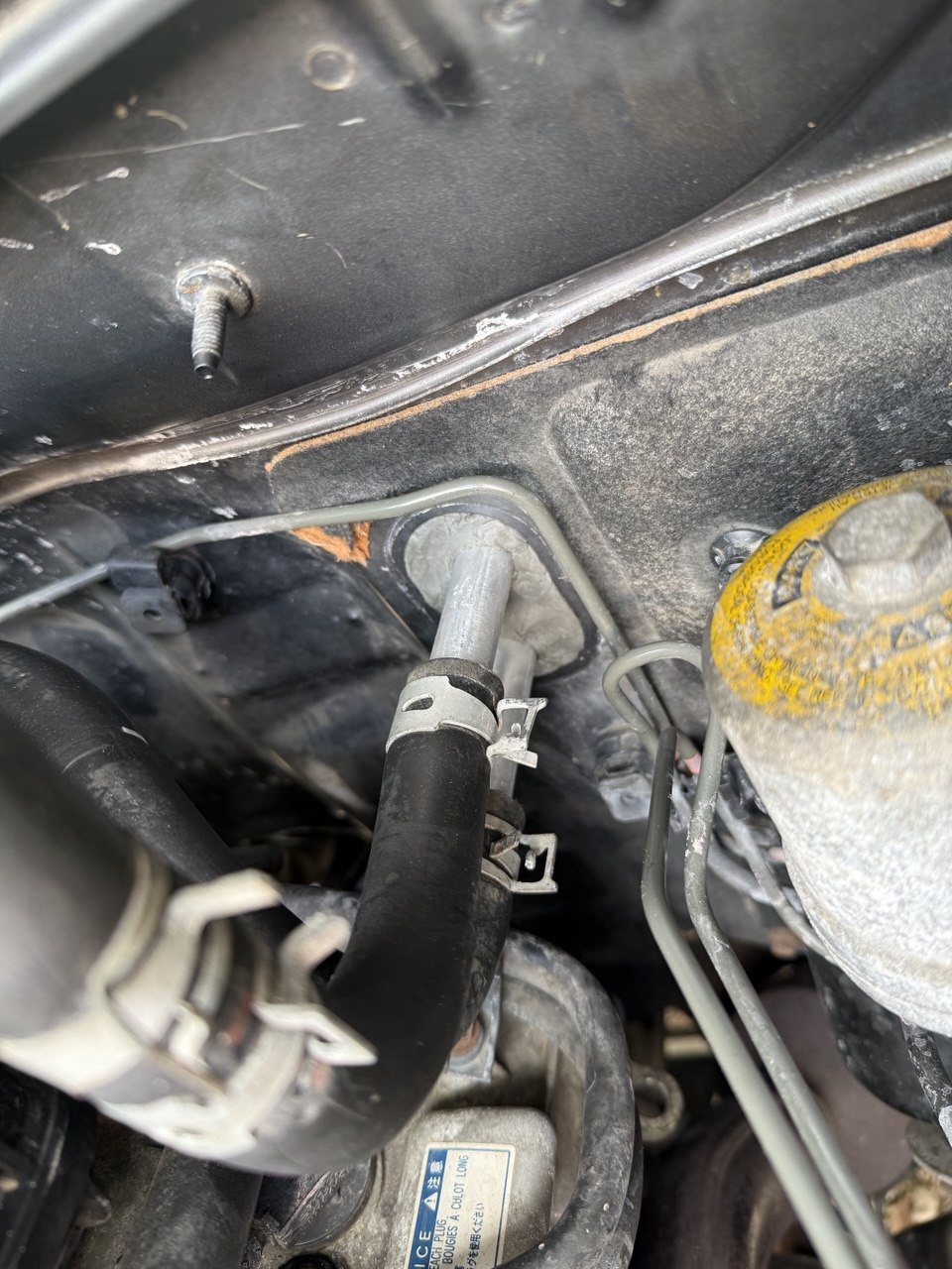

Quick check-in on the new AC system. First off, I wasn't sure what to fill the heater core firewall gap with. As mentioned I was considering duct seal, and that is what I ended up using:
On paper it's the perfect material; inert, holds its shape under high temp. It stays RATHER malleable due to the high temps but at the same time stays put. Perhaps not the most optimal solution but definitely cheap and easy.

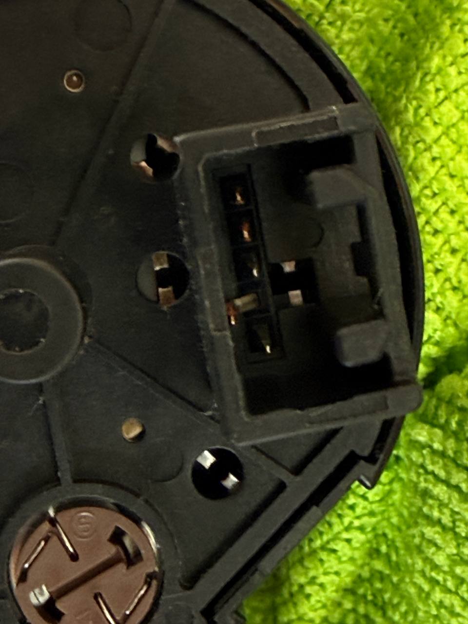

Everything went back together great but I eventually noticed that I no longer had 4WD. I ran down the basics and eventually narrowed it down to the 4WD knob, which had a bent pin:
Dumb luck caused me to check the connector on the back of the knob.
Easy fix; used a pry tool to bend the pin back off the sidewall there, and then with the knob in my vise I used two flatheads on either side to straighten it back out. 4WD working again.
