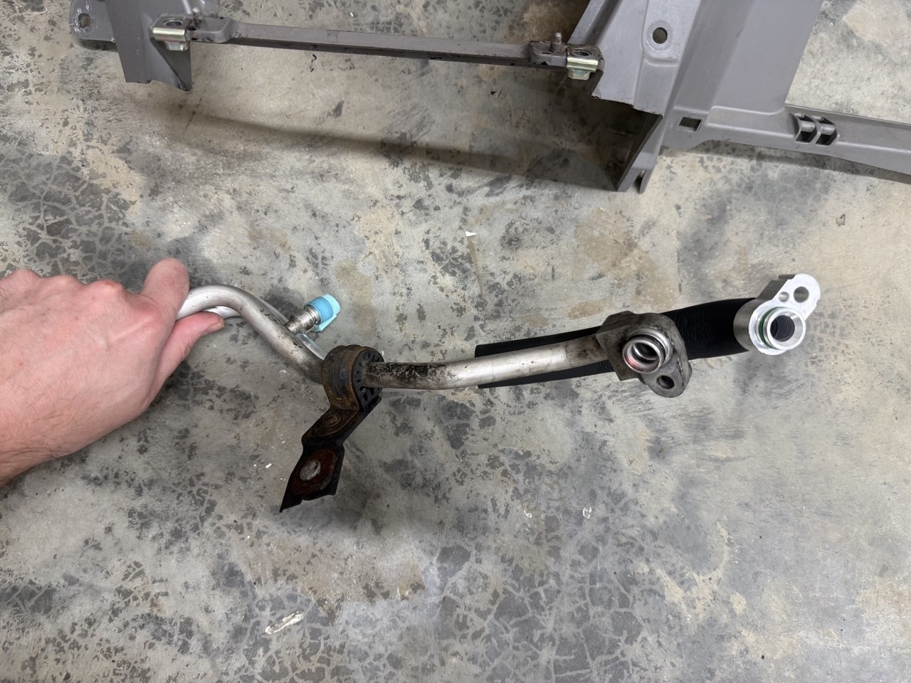

Here's the problem:
You can see the line is a few inches too long and the flange is orientated the wrong way.
If it was slightly off I think I'd try bending it but I think I lack the skill to get the rotation correct on the flange.
I ended up refurbing the existing line. Flushed it, cleaned it, replaced the o-rings, schrader valve, and cap.

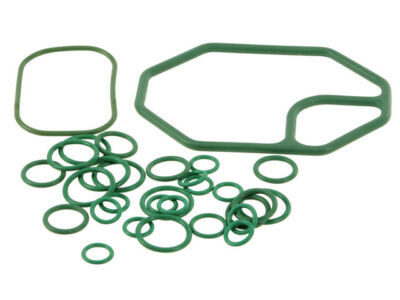

btw, can someone please explain this to me:
This is a bog standard o-ring kit for the 4th gen.
What the HECK are those two big gaskets up top???????
I've had my system completely torn apart, I've replaced every single o-ring, seal, whatever, I've touched every single joint. My system holds vacuum and pressure. At no point have I seen either of those two gaskets. What on earth are they for?
Ahh, found one of them.
Looks like it goes inside the compressor (outer?) housing where the lines connect. Doesn't look like a part you would replace very often without good reason.
