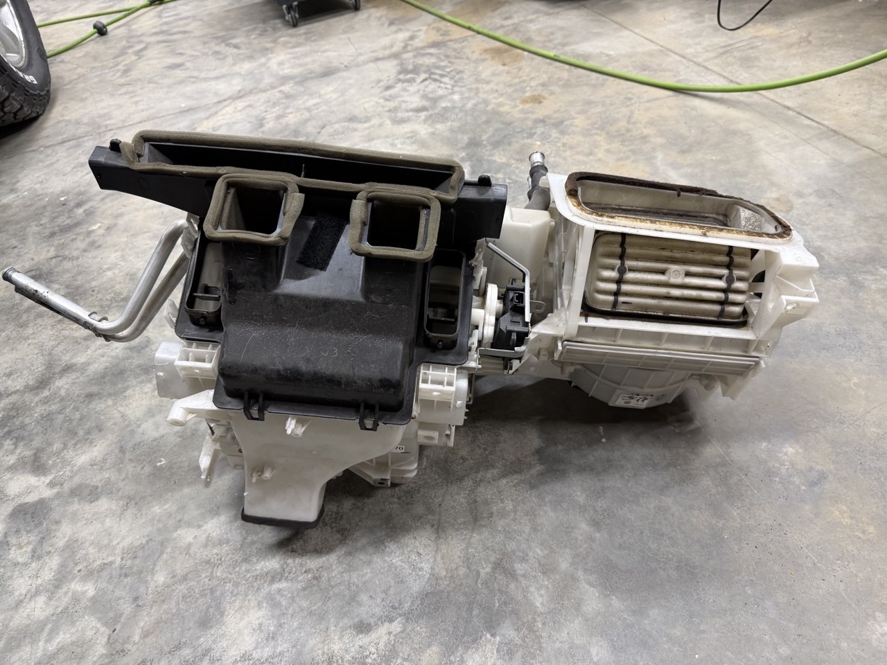

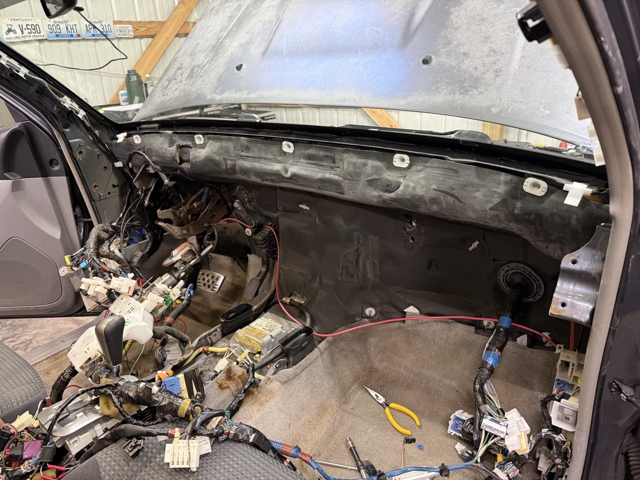

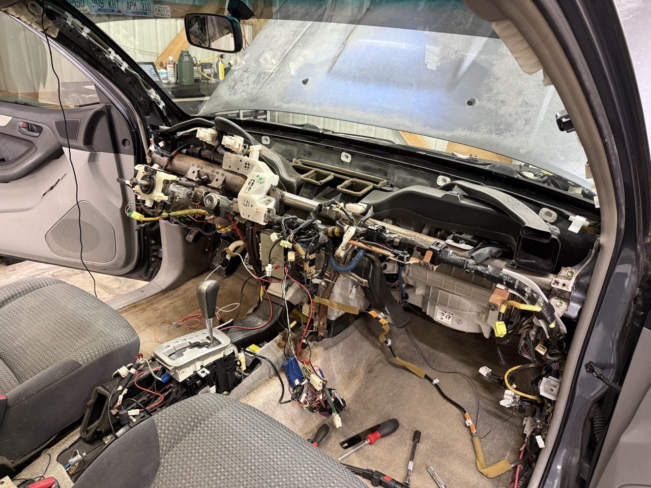

Starting on this project tomorrow.
Can't find the dessicant that was supposed to come in the compressor/condensor kit. I wonder if it's "installed" in the condensor in a plastic bag..
The desicant bags are 'very similar', across many toyota from the 4th gen years until now. I replaced my evaporator core last summer. I went to Napa for the descent bag..."while im in there and the system is open" type of eplacment. Its not hard to do...but does require vacuuming the system down again. Anyways, Napa didnt have the 4th gen bag, but they did have a modern lexus rx bag, the actual bag is the same. Just the pipe seal is different. We just reused the old seal.
My advice is take out the entire dash as one unit vs disassembling it....SOOOO much easier. I didnt take a ton of photos along the way, but tried to describe and document on thread I started.
I got here in 2.5 hours. Not too bad so far.
Few more hours.
Removing the support bar just about broke me. Way way harder than removing the dash.
Ladies and gentlement, we got him.
BTW I found the dessicant. It was installed inside the condenser in its rightful spot.
Would have preferred it to be sealed in plastic but I suppose the condensor is technically sealed from the factory with plastic plugs.Oh well, it's fine I am sure.
