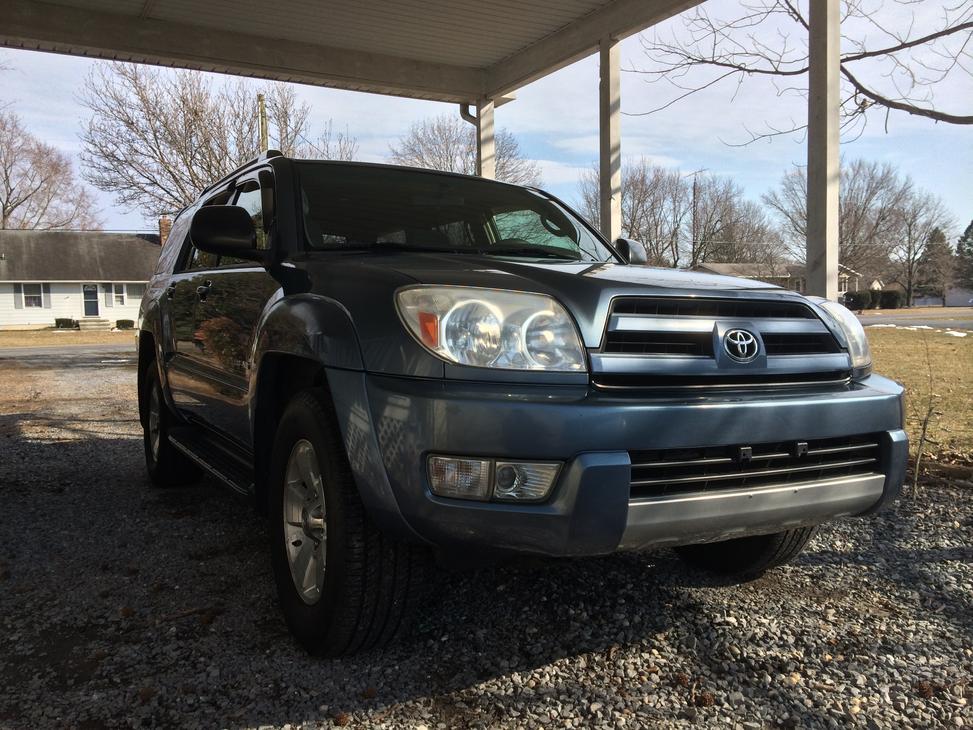

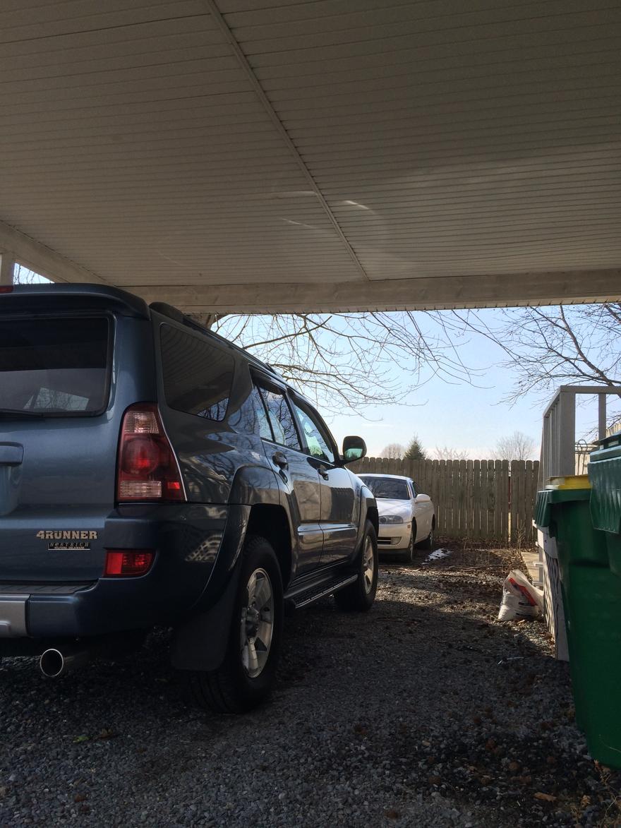

I have almost 161,000 miles on mine, just purchased recently, not a bit of trouble out of the tranny & it shifts nice n smooth! I checked the dipstick & the fluid is a nice reddish color & not brown! I think I'm good for awhile & look fwd to hitting 200K!
