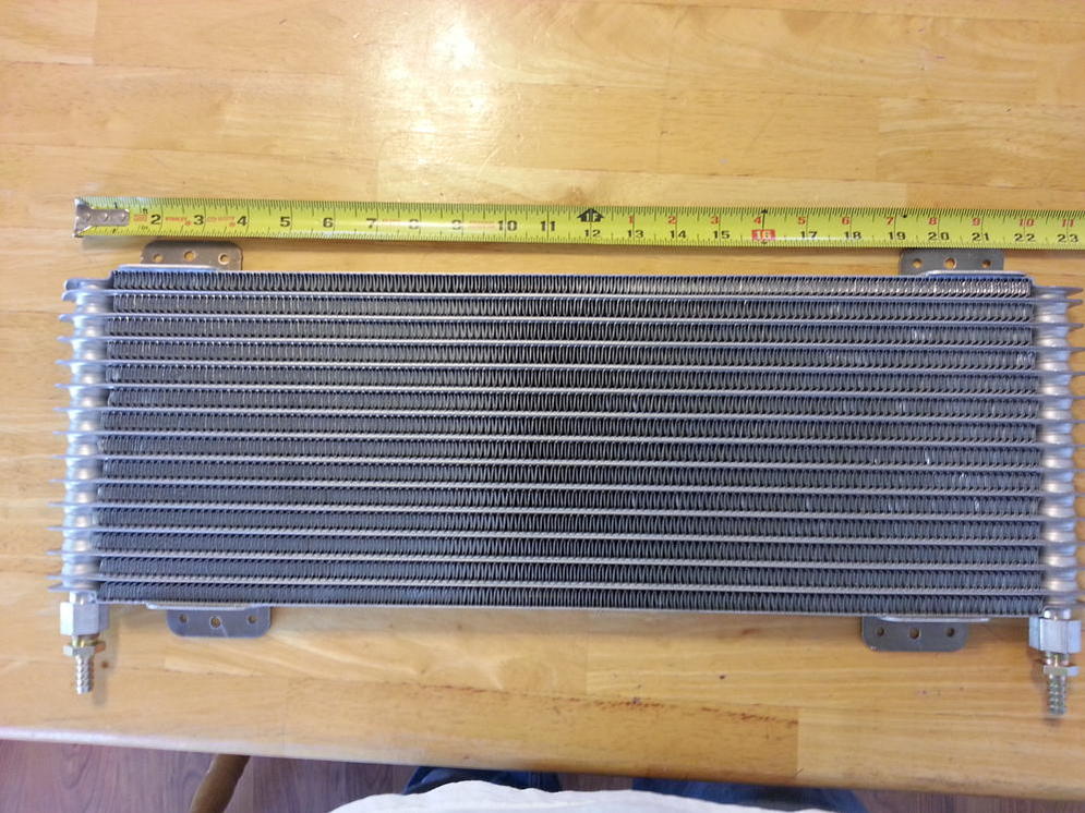

I found a Tru Cool 4490 cooler the other day. Anyone know if this is too big or if it will fit in front of the radiator? It's rated for like 22,000 btu so it should be a bit overkill but I'd rather be safe than sorry. Also, what is the best way to mount the cooler (barbs up, down, side)?

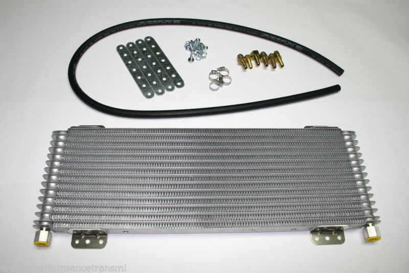

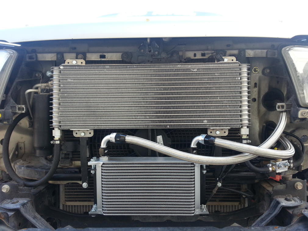

For a trans cooler I say bigger the better as long as you can make it fit. I bought this one a while back its rated for 40,000 gvw I got it to fit up front real good. I have no problems with air bubbles I tested it out in the sand dunes last summer running it hard never heated up once it works great.
  • 95515d1376624785-my-supercharged-4runner-headers-full-ex-10psi-water-meth-injection-20130802_145.jpg
  • 91240d1371331346-my-supercharged-4runner-headers-full-ex-10psi-water-meth-injection-20130615_095.jpg
Wow... That's massive. I'll have to try to fit the one I have in somehow. I'd rather do that then sell it and buy a smaller one if I can.
