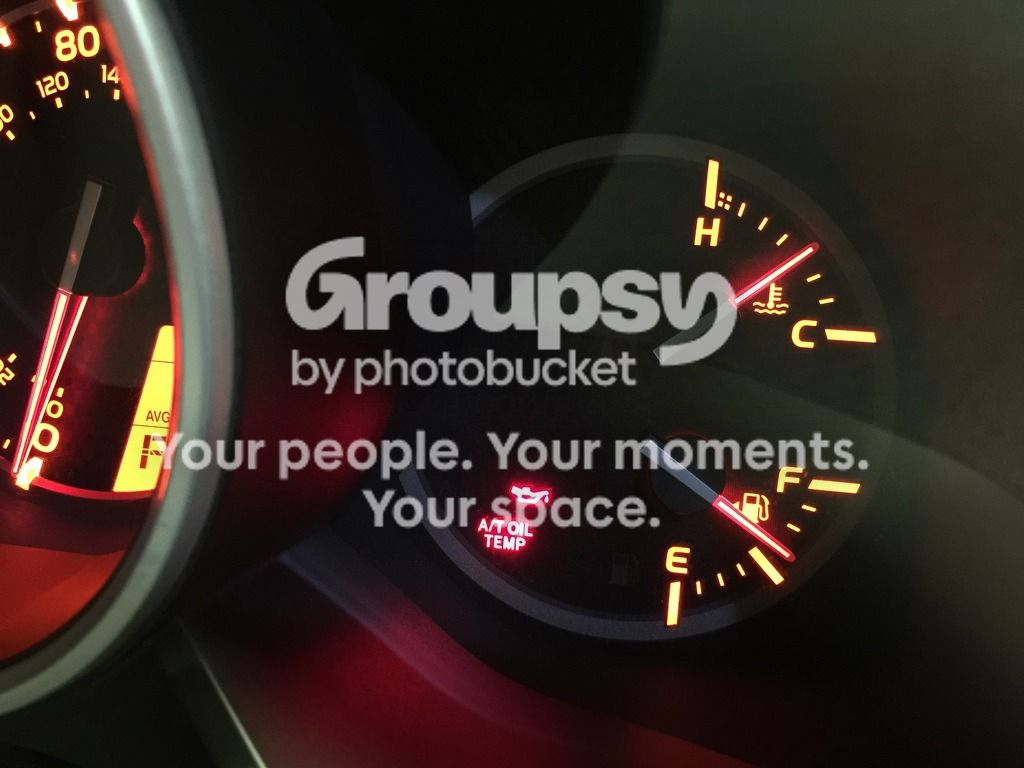

My '13 T4R SR5 4x4 w/Convenience Package has an AT Temp light for sure:
AT%20Temp%20Light_zpszghbpwyd.jpg~original
It seriously confused me for a good 30-45 minutes! All of the documentation I had been looking over these past few months all indicated "AT Temp" light. I knew I had one - so that was what I was initially looking for. I guess those were older threads or Tacoma threads or whatever that also discussed the flush procedure.
I initially noticed the "D" indicator behavior after attempt #3 - but still kept on trying to get the AT Temp light on for another 30 minutes. :withstupid:
FWIW - I assume all T4R's are similar - but my "AT Cooler Return Line" was a hose going into a solid line. The Tacoma thread linked elsewhere is reversed. My solid piping and rubber hoses were on the opposite side (flowing from hose into pipe). The 3/8" ID tubing I bought was just small enough to cram into the HOSE end of the AT Cooler Return (had to cram my 3/8" tubing INTO the factory hose). This is opposite of the Tacoma thread that shows the 3/8" tubing sliding over the solid piping.
In the end - it worked just fine - and I only needed around 8-12" of tubing to get from the AT Cooler Return line into the 5qt Mobil-1 oil carton I used as a catch and measurement tool. The garden sprayer mentioned elsewhere also worked well with about 12" of 3/8 hose attached and refilling via factory refill plug... I bought 10' of 3/8" - but oly needed about 2' :wave: It did take me a good 30 minutes to wrangle the AT Cooler Return hose off the pipe - I was being pretty careful (didn't want to bend/break the piping).
My 110mi round-trip drive to work today was uneventful. A very good thing after this ATF service!!! Much thanks to all information providers...
