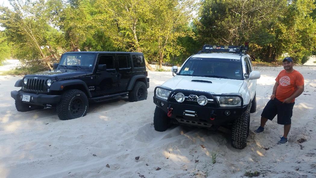

The other day a friend and I went exploring and I ended up getting my baby stuck. I didn't realize how bad till I saw my trans temp and I shut it off. After a while I turned it back on, and got MYSELF out! I will damned before I give my friends jeep the satisfaction! My at temp ligh came on after I got out and then went away. A month later I have a small shudder on light acceleration between 15-20 mph. I think I am going to get my trans drain and refill from the dealer. What do you guys think?

My gauge said 260 if I remember correctly. It's a 2007 v6. The at temp light came on and I shut it off and waited for it to cool down. I drove it around today and it was fine except at low speeds you can feel a slight shudder. It is not flashing any codes no d light and my trans temp stays under 180 degrees for daily driving. I don't drive it all the time so I might just park till I flush it.
