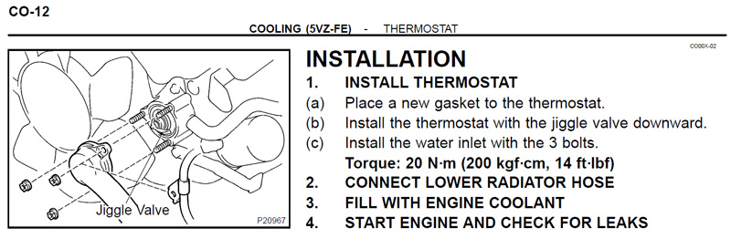

Your temp is too high. Where do you have the jiggle valve? Should be at the 6 o'clock position. I'm running a TAMA brand which is OEM brand made in Japan. Here's the link to it: Stant is good name also but get as close to OEM as possible.

Well, I flipped the stupid t-stat and jiggle is down, I repeat the jiggle is down... Lol
Took her for a short spin, not long, wt was 190 and trans was still climbing... Ended at 180ish trans... It was about 70 ambient air temp.
I'll spin tomorrow and update... I'm skeptical that it was/is my only issue.

I ran 193-205* for years after Toyota changed my thermostat, jiggle valve was at 12 o'clock. I changed mine about a year ago at the 6 o'clock position as per FSM and have never seen it go above 193* and that is only on a long uphill. My stock gauge has never moved for either setting. I would not sweat either setting but will be leaving my thermostat at 6 o'clock in the future. I live in Ontario, Canada and my heater works fine under both settings.
