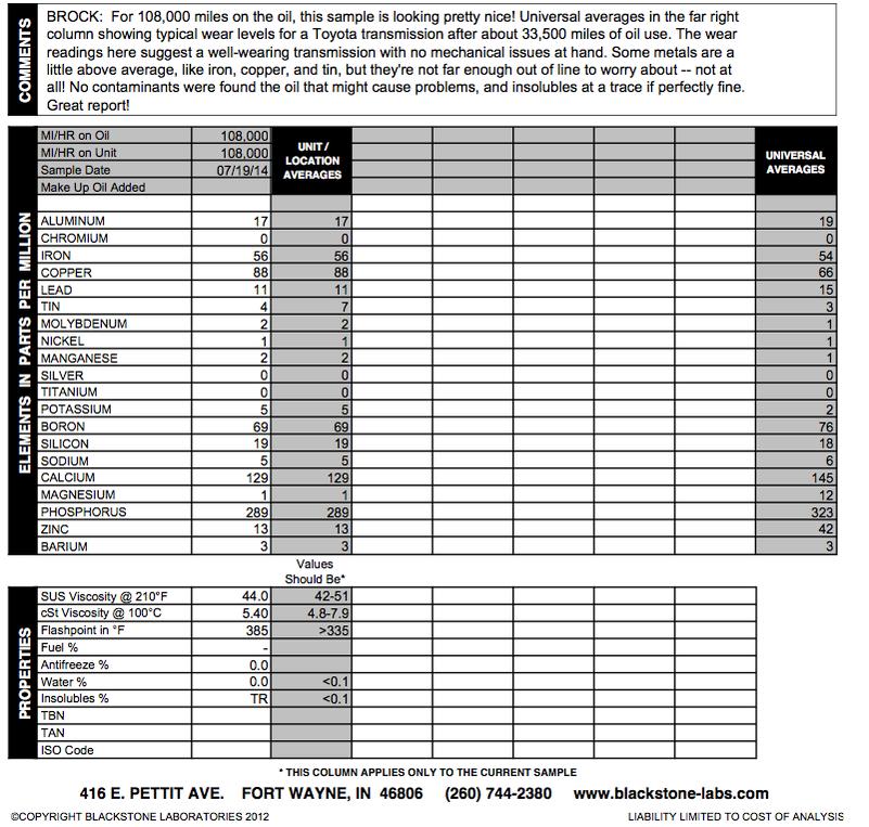

It sounds like alot of you determine your fluids are "bad" based on the look of them...I know this isnt apples to apples but I came across this on another forum I frequent. Attached is a ATF fluid analysis by Blackstone done for a IS250 AWD at 108,000 miles with "dark" looking ATF fluid.
