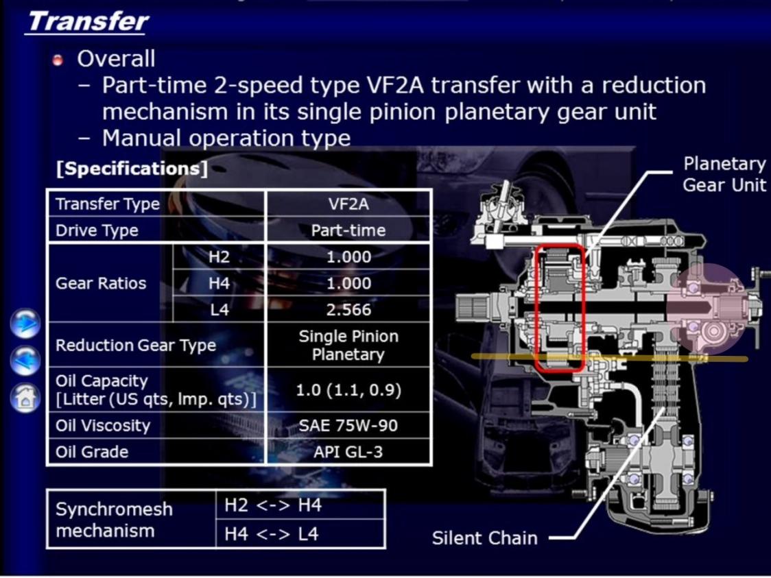

FWIW - the neutral position does disconnect both front and rear shafts from the in put shaft. However, the rear output shaft and bearing assembly will still spin. The rear output shaft is higher than the oil level in the transfer case and the oil pump assembly will not spin. Therefore there is no mechanism that will move the oil from the bottom of the transfer case housing up to lubricate that bearing. You can probably get away with flat towing for some distance based on residual oil in the bearing and low load. But you have to recognize that you are spinning a potentially un-lubricated shaft.
I *think* that if you put the transfer case in N and had the front ADD connected (so you were engaging the front diff to drive the transfer case output to the front axle) you would then spin the chain and it would probably move enough gear lube up to lubricate the rear output shaft. Without putting a window in one and running it to see how the fluid flows - I can't be sure of this.
In a perfect world you could install a baffle to hold oil in the rear output bearing area to lubricate during flat towing. Otherwise - it's not designed for that and you may end up burning up the bearings and seizing the transfer case. You might not have an issue and residual oil is enough. I might roll the dice on my own junk - I wouldn't recommend someone else doing it.
Hopefully this will make some sense. In the image I put a yellow line at the level the normal oil fill level is. The oil pump is driven by the input shaft on the front (left side in this image). That is not driven or pumping in Neutral if the transmission is in park or neutral during flat towing. I've also added a pink/purple sort of color circle to highlight the rear output shaft area that will be spinning during flat towing and not lubricated. To flat tow - you need to get the oil from below the yellow line up to the bearing in that area. I don't think you can over-fill the oil enough to do that, but I don't know for sure.

1. My 2018 SR has a front axle disconnect that is run by an electric motor.
2. The oil pump for the transfer case is on the input shaft. Even with the transfer case in neutral, the output shaft rotates (driven by the rear wheels). Thus you cannot flat tow it because the output shaft has no lubrication.

Toyota advises not to flat tow the 4Runner for the reasons stated above.
This answers the question then, if it's driven from the input shaft, it would never work, the trans would be in park. I was never successful in finding an exploded diagram of a transfer case, but I'll take your word for it. :)
