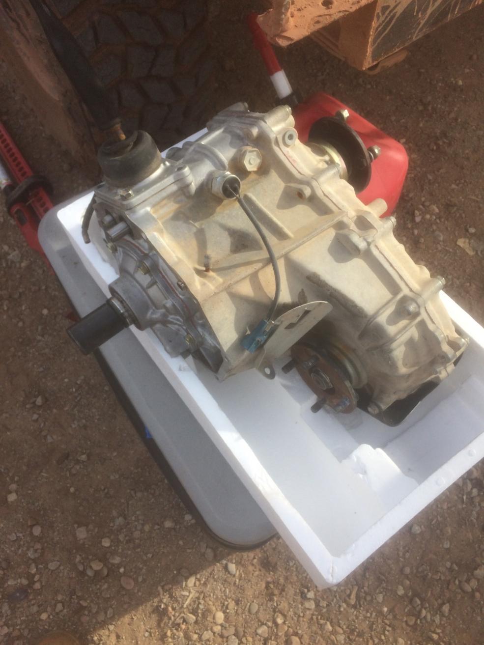

Assuming the shifter on the transfer case comes out like my picture above (not sure if it does on the manual trans transfer cases), then it will bolt right up. You will need new front/rear driveshafts (multi-mode and j-shift cases are different lengths) and you need to do some wiring to fool the computer into lighting up lights and actuating the front diff...
-Charlie
Got it, and I won’t be needing the AWD mode/ actuator module (solid front axle) and I guess I just prefer the feel of the J shift. I’d prefer pulling the lever through the gears than pushing a button to engage my front driveshaft. I also just talked to someone on the phone and he said the collar in between the output shaft on the trans (auto vs manual) and the tcase is different so it won’t fit around the input shaft on the tcase
I’ll see if I have any pictures I can post of a manual trans tcase
Not sure how to post pictures but he’s a tcase from a r150f
