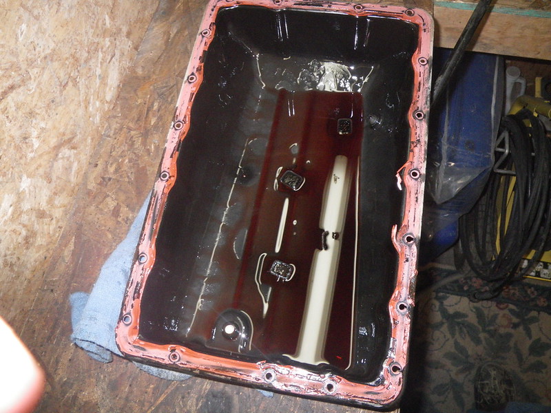

4. Next put the drain bolt back in the pan to keep the mess down and begin to remove the 19 pan bolts. I used a criss cross method to avoid warping the case or pan. You are going to have to find a way to break the seal of the stock gasket. I used a narrow scraper and hammer. (Go ahead and place these bolts in a Ziploc so that you don’t lose them.)
Here it is without the pan.
IMGP0008 by Phoenix Black, on Flickr

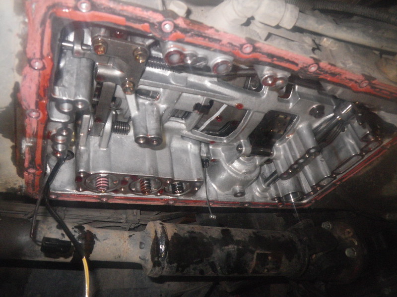

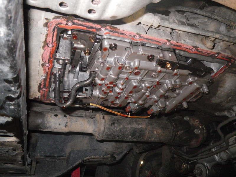

5. Once you have the pan off make sure you have your drain pan under the trans because it will continue dripping fluid.
6. Go ahead and remove the sump filter and set it and the bolts aside.

7. You will now remove the valve body from the truck by removing the wiring, feed tubes (on older models like my 98), kick down cable (if you have one, newer models don’t), and all of the bolts. I used a criss cross method to avoid warping (you could also use a cordless impact gun to speed up the process.) Also be sure to make a template to keep track of the bolts because they are different lengths. The valve body will also have some weight to it so be prepared and don’t let it fall.
The template I made for the bolts.
IMGP0016 by Phoenix Black, on Flickr
Trans without the valve body.
IMGP0019 by Phoenix Black, on Flickr
Sorry about the blurriness, my camera got drenched in atf when I pulled the valve body.

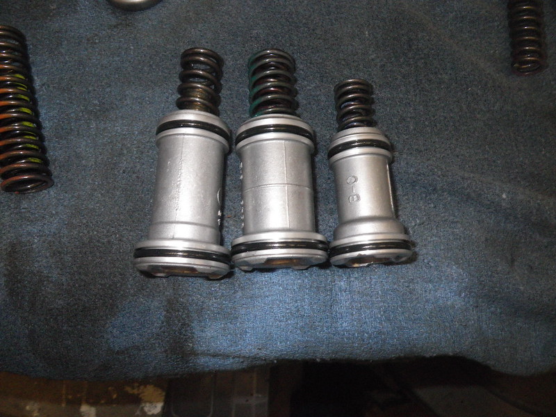

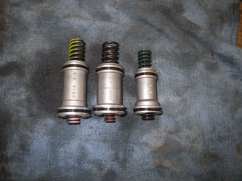

8. Next go ahead and remove the accumulator pistons being sure to keep track of which one goes where as the springs are specific to each one. (I won’t detail which springs go where because they are very clear in the instructions.)
Stock accumulators:
IMGP0020 by Phoenix Black, on Flickr
Modified accumulators:
IMGP0027 by Phoenix Black, on Flickr

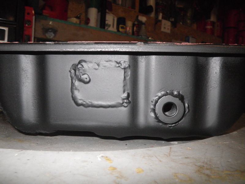

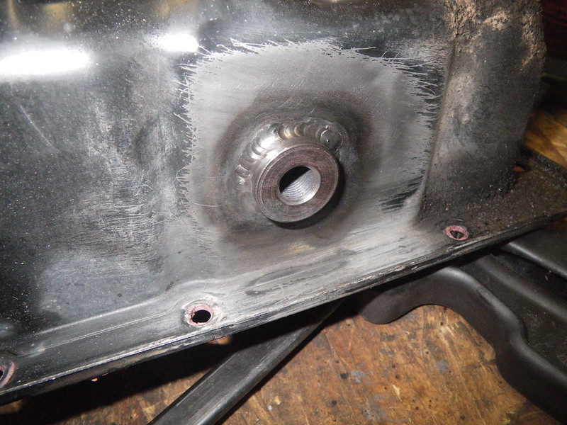

As a side note it was at this point that I took the opportunity to remove all of the old pan sealant remnants on the pan and case, clean up the pan magnets, and install the bung for the trans temp gauge I was also installing. Here is a link that has pictures of what it should look like all cleaned up.

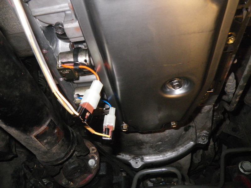

And here is the bung welded in.
IMGP0031 by Phoenix Black, on Flickr

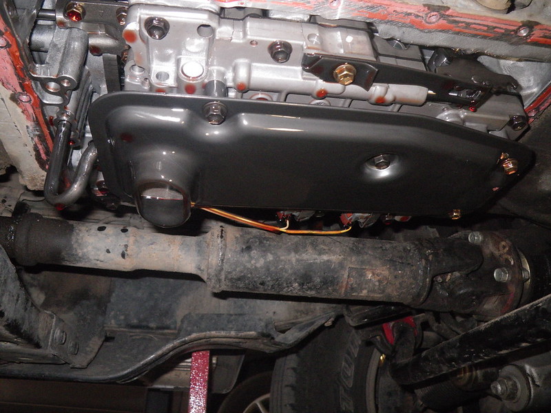

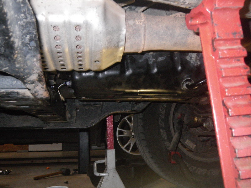

I actually ended up having to move the bung because it was hitting the feed tube and not letting the pan fit back on, oops. So here is where it sits now.
IMGP0036 by Phoenix Black, on Flickr

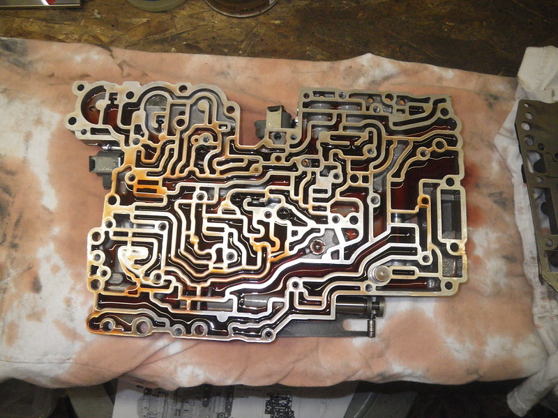

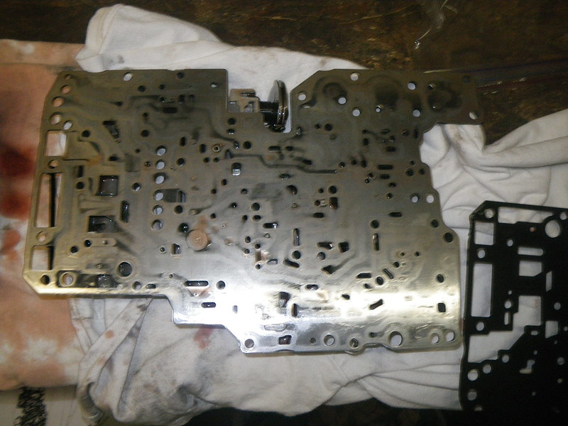

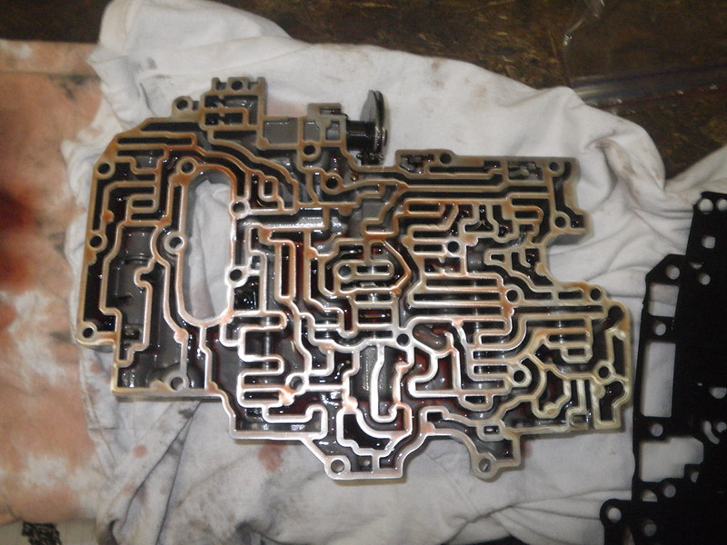

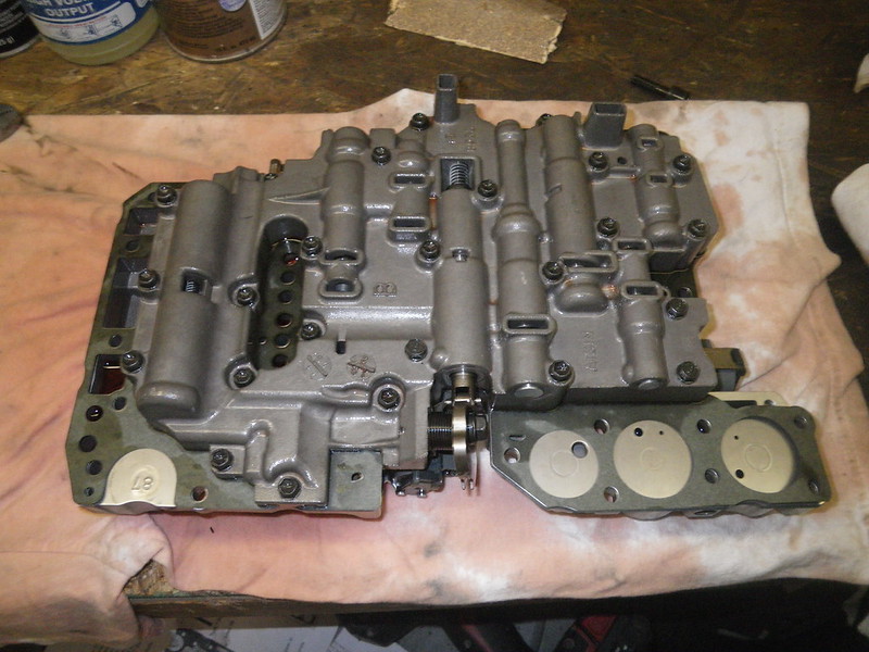

10. So once you get the valve body open you are going to see the innards of the two sides. Be careful to not drop any of the check balls or retainers out.
Here is what the inside of the valve body looks like
IMGP0032 by Phoenix Black, on Flickr
IMGP0033 by Phoenix Black, on Flickr
With the separator plate removed
IMGP0034 by Phoenix Black, on Flickr
11. Go ahead and clean up the separator plate and follow the directions as for what holes to drill. (Just take your time and make sure you are drilling the right hole because some of them don’t look exactly like the diagram but you can tell it’s the right one. It is pretty straight forward)

New shift solenoids
IMGP0040 by Phoenix Black, on Flickr
All buttoned up
IMGP0044 by Phoenix Black, on Flickr

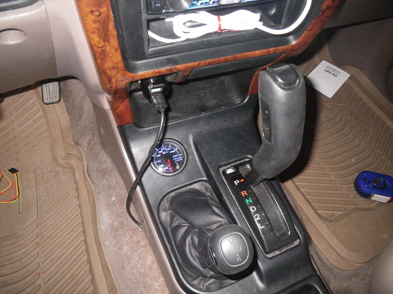

Here is the glowshift gauge I installed
IMGP0045 by Phoenix Black, on Flickr

What's the dealy-o with the bunghole
After reading a lot of threads and arguments about where the best place to put the temp sender was I decided on the pan. Reason being was I had the pan off so it was easy, and it provides a better reading of the bulk of your fluid. Where as if you have it in the send line it is measuring the temp right after the fluid has done work and is in a temperature spike which the cooler will take away in a matter of seconds. And really it is the long term high temps, 200+ degrees in the pan, that kills the trans, not the short periods of time where the fluid is doing its job.
